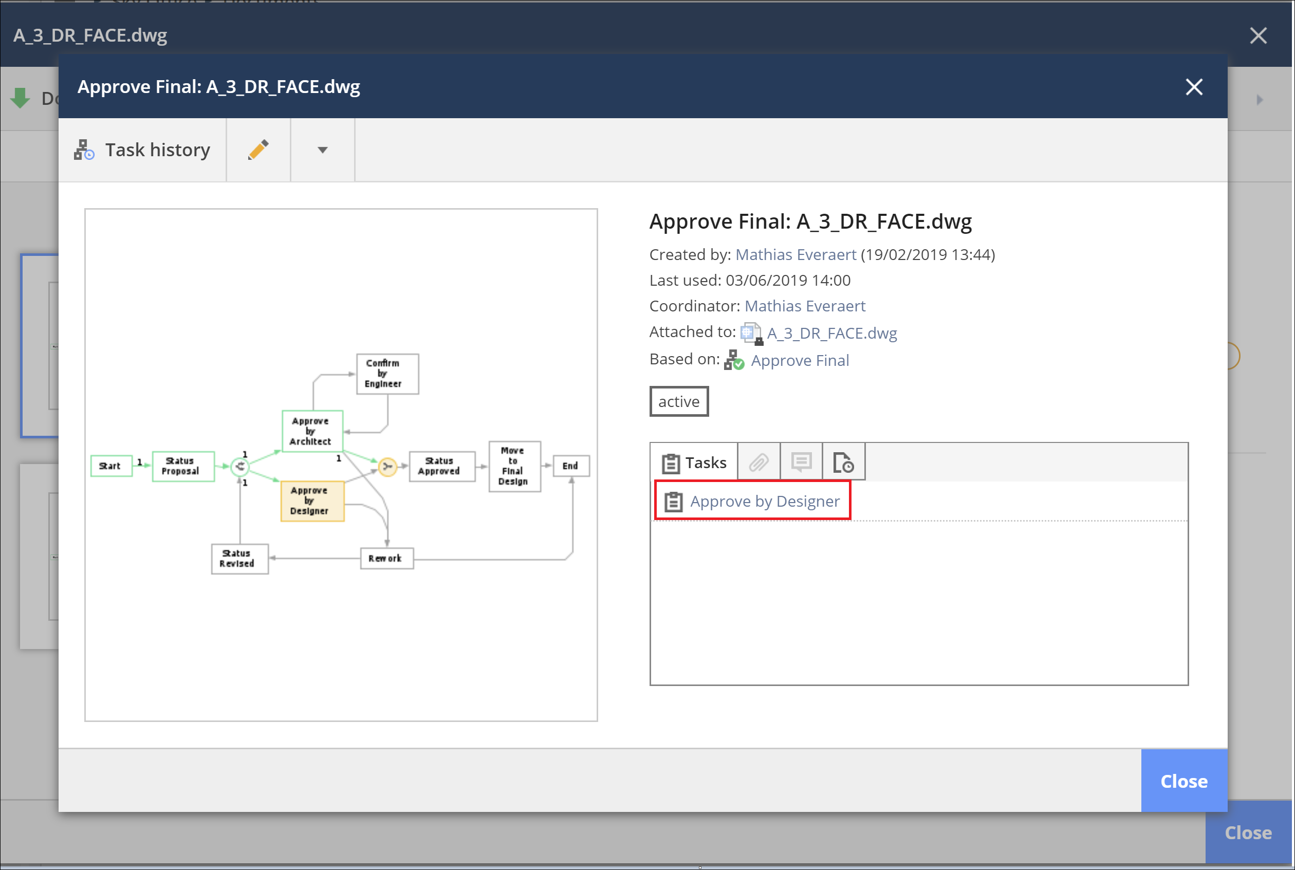

  3. Select an active workflow on the left side of the window and click on the 'eye' icon.
  4. Click on one task underneath Tasks tab.

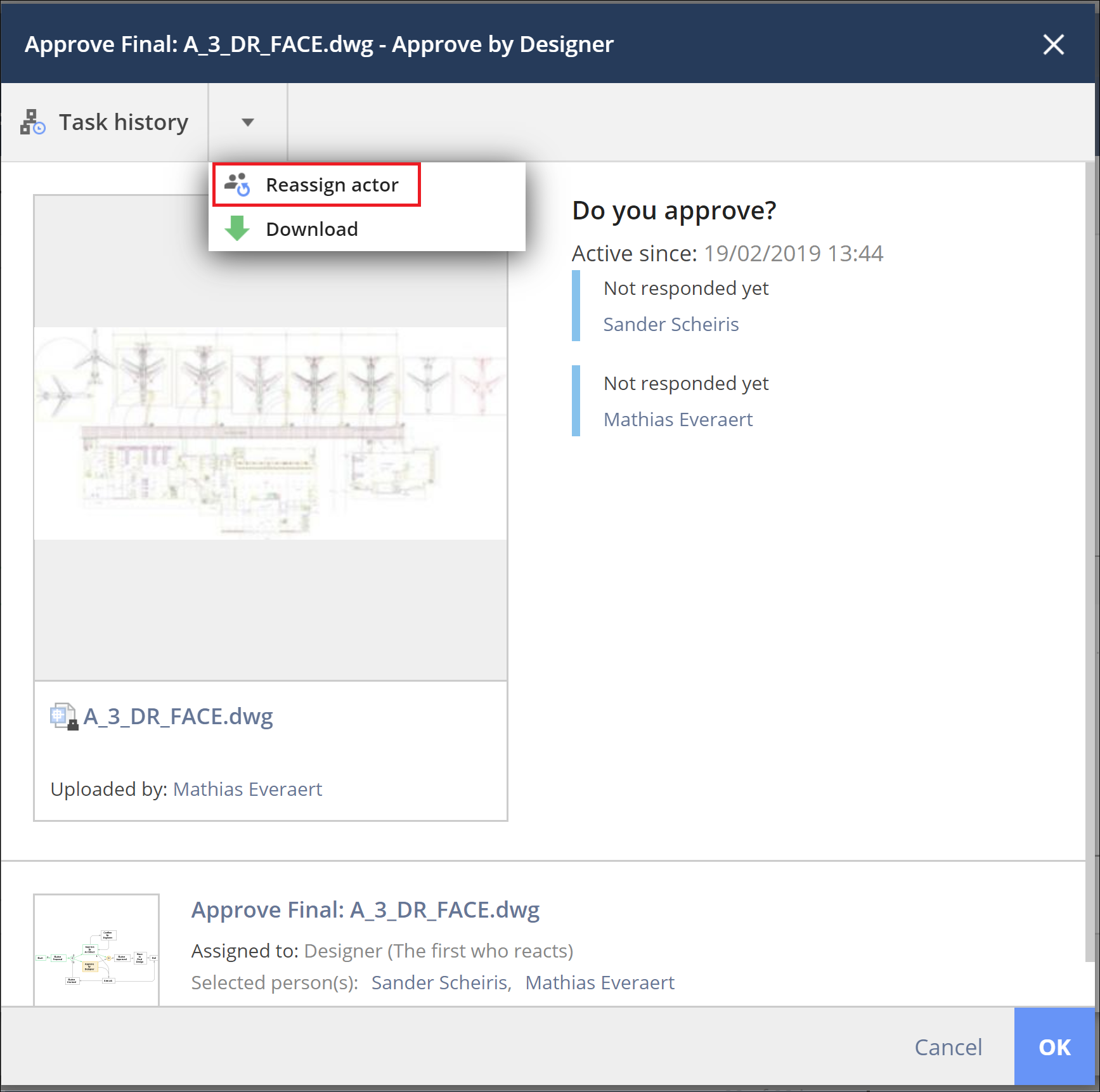

  5. When you click on the arrow with drop down menu you find the action 'reassign actor' (note that there must be at least 1 other user in the role of the current actor).
