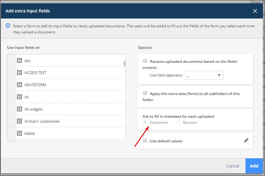

Add form
Attach a Form to a folder and use the form as metadata. You can only execute this action on document folders. (See Form App)
Hover over the folder
Select the action add form
Select the form you want to attach

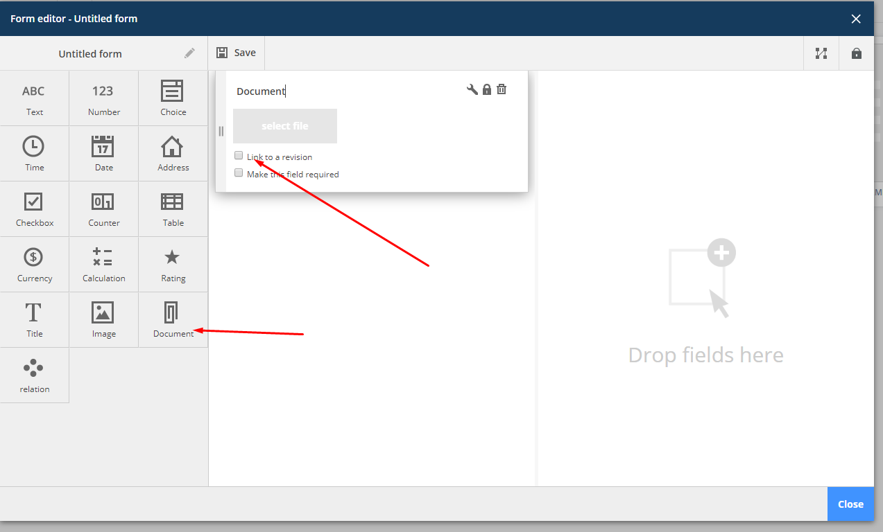

Previously you could only attach forms that contained a document field. In this document field you could then choose whether the metadata was stored at the document level or at the revision level. This is no longer the case.
It is now possible to attach all forms to a folder and in case there is a document/revision field in the form, the level at which the metadata is stored will be chosen, based on the document field.
If there are no more (or more) document fields in the form, you can choose with this new option at which level the metadata will be stored. There should not be any changes to existing links between forms and folders and the reading of the data will remain as it used to be.
However, if you now move a document to a folder with no form attached, you will still be able to see the metadata.
It is important to know that only forms with a document field are selectable as metadata.
Optionally
Rename uploaded documents based on the fields' content
Rename uploaded documents based on the content of the fields and automatically generate a name. Select the separator that will connect the content of the fields: _ / , / - / . / Space.
For exampleWhen a user uploads a document and fills in a form:
Document type (invoice, plan, other): plan
Discipline (Decoration, Electrical, furniture, HVAC, plumbing, Safety, Structural): Electrical
Floor (-1,…,4): 3
The document will be renamed to Plan_Electrical_3 after upload.
Use default values
Fill in predefined values.
Apply this meta data (form) to all subfolders of this folder.
Save
The form will be used as metadata
Each time a document is added to the folder, you can (or have to) fill in the form fields.
