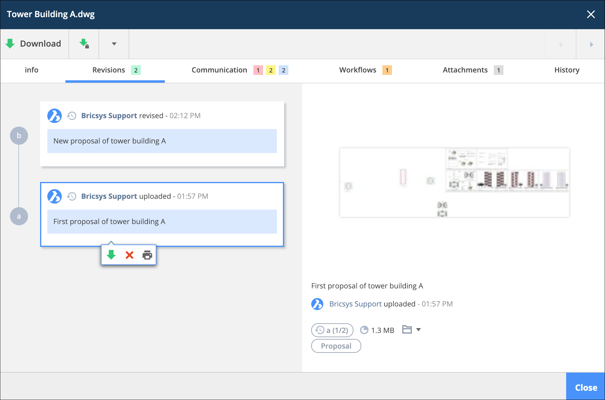

- Revisions
The process from draft to delivered document is saved by revisions. Each revision has a status and description to indicate its process.
This section contains all the revisions a document has. There is no limit on the number of revisions. The administrator decides how revisions are displayed:
- 0,1,2,3,4...
- 1,2,3,4,5...
- a,b,c,d,e...
- A,B,C,D,E...
- -,a,b,c,d...
- -,A,B,C,D...
Revisions can have a major and minor version. This is decided by the administrator of the project. This way a revision could be "A.1" instead of just "1".
Click on a revision to view the details of the revision on the right.
Hover over a revision to
- Download
- Print to PDF
- Delete (only if you have delete access on the document and the project administrator allowed the deletion of revisions)
Clicking on a specific revision will filter the communication and attachments in the corresponding tabs to the selected revision.

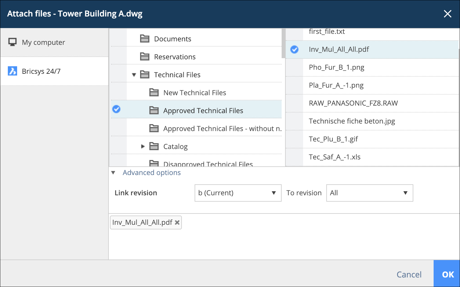

Attach document
Gives you the opportunity to manually upload a new document from you local machine and attach it to the document directly or link the document to another document in your project.
When linking to another document on the project the advanced options let you choose wether you want to link a specific revision to a specific revision. By default the documents are always linked to the last version of each document.
Once the document is linked you can see it in the document inspector and in the details of the document. If it is linked to another document, you will see the link in the other document as well.
When uploading dwg files from within BricsCAD or AutoCAD with our Bricsys 24/7 connect plugin, xrefs will be linked automatically for you.

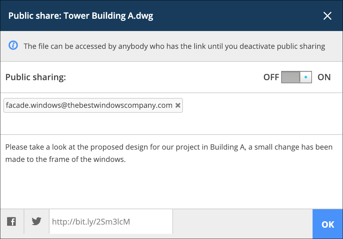

Public share
Share documents with people who aren't part of the project by creating a unique URL and send it to them. Everyone with this link can open the document in the viewer without them having to log in on the project.
Note: You can always turn off the share by toggling the public share slider on the top right. After you turned off the sharing, the URL link will no longer work.Watch out: If you re-share by doing the same action, another URL will be generated, different from the old UR you generated the first time.
