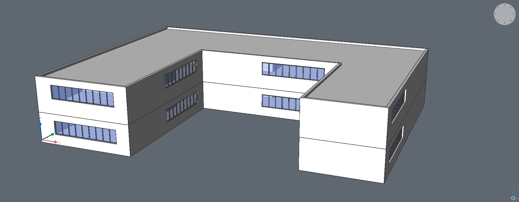

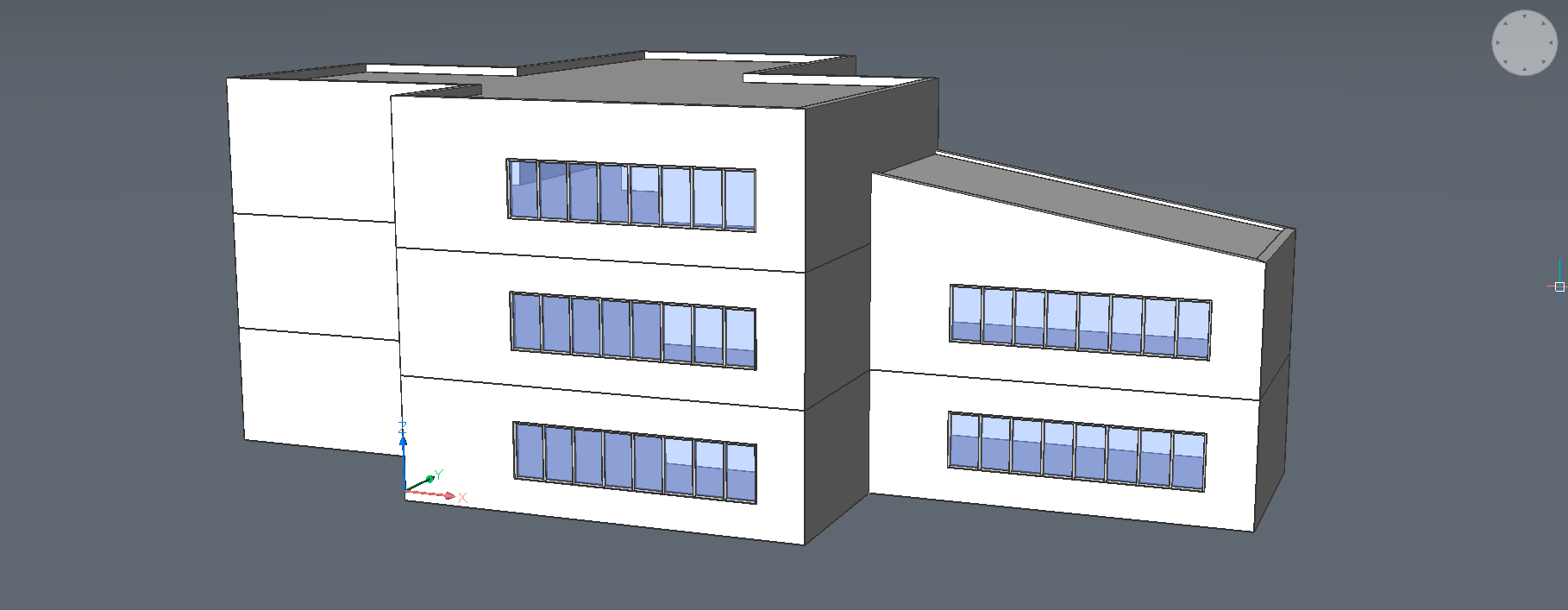

- Open up a file to start from. Here we use a basic rectangular building that looks like this:

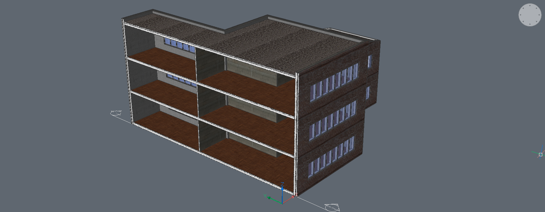

Note: No BIM data or compositions should be added yet. - Add the compositions that you want. Don't do this for all your elements, but only for one element of each type. In our example we give a composition to 1 outer wall, 1 inner wall, 1 floor slab and the roof:

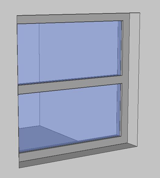

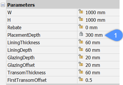

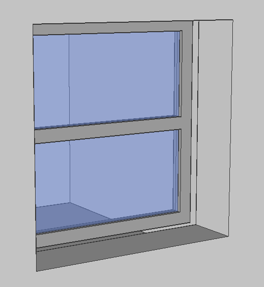

Note: It could be that you have different types of outer walls, for example the wall facing north that needs more insulation. In this case, you give one of these northern walls a different composition. - In this example, we also want to adjust the parameters of our windows. Select only one of the windows and change the parameter you want in the Properties panel.
The window before changes.
Changing the PlacementDepth value in the Properties panel of the window.

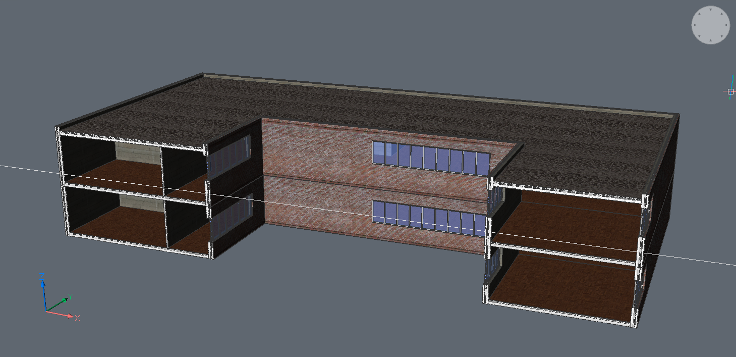

The window after the changes. - Type BIMAUTOMATCH and press Enter. The Auto Match dialog box appears.

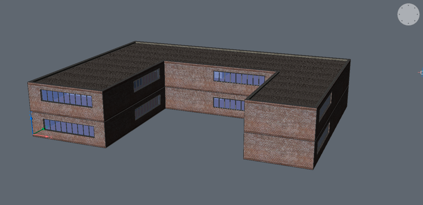

- Check the boxes from Compositions and Window Parameters to have the compositions and the window parameters that we chose to be completed in our entire drawing.

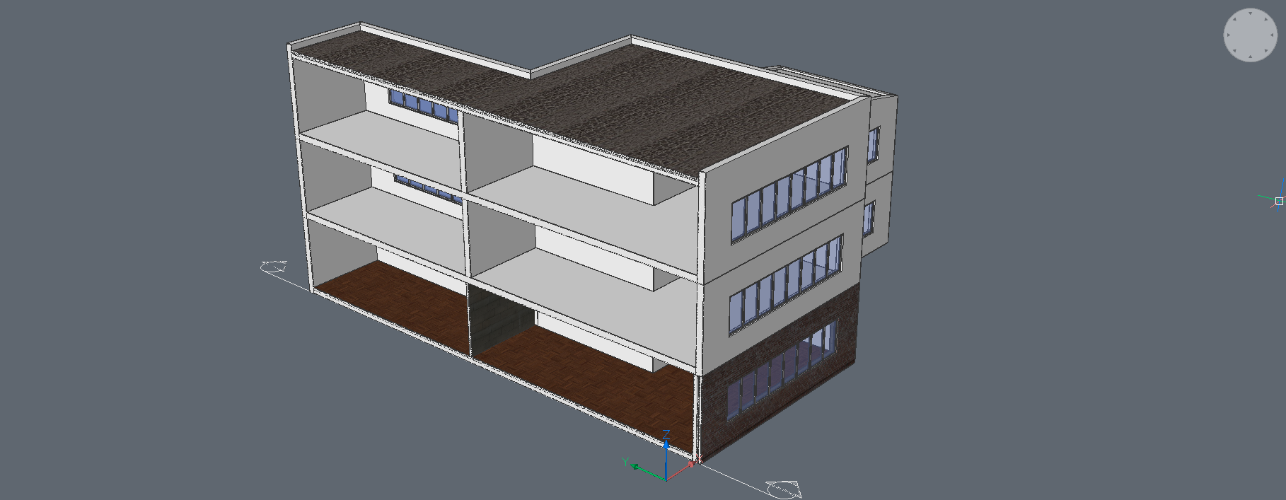

- Select Autocomplete. The compositions and window parameters within your file are automatically copied. The drawing looks like this:
By using BIMAUTOMATCH command, we very quickly have all our compositions and window parameters as we want them, without having to worry about forgetting anything.
Note: You can see that different types of outer walls have no problems. All the walls facing north have been given the correct adjusted composition.
