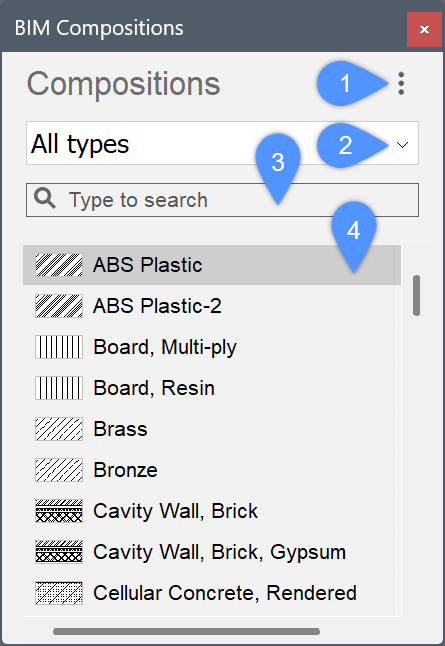

Using the BIM Compositions panel
(1) Menu
(2) Composition types list Filters the list of the compositions. Only compositions of the selected type are displayed.
(3) Search field Filters the list of the compositions. Only compositions that contain the current search term are displayed.
(4) Available compositions All compositions of the selected type are displayed from both the In Central Database and from the In project database, unless the Show only compositions in project... menu option is selected.

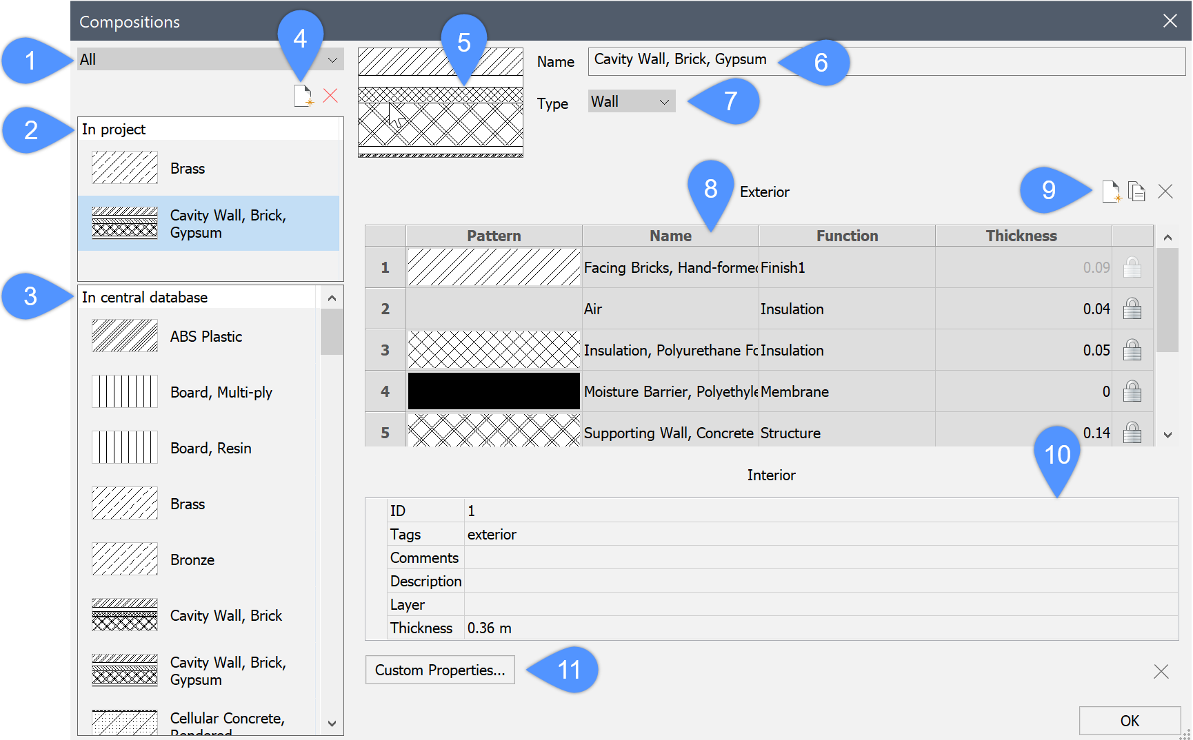

The BLCOMPOSITIONS command opens the Compositions dialog box:
(1) Composition category selection Filters by category: Wall, Slab, Roof, or Generic.
(2) In project Displays the compositions of the selected category (wall, slab…) currently used in the project.
(3) In Central Database Displays the compositions of the selected category (wall, slab…) from the Central Database.
(4) New composition Creates a new composition.
(5) Preview pane Displays the currently selected composition.
(6) Name field Displays the selected composition name. You can change the default name.
(7) Category drop-down box Displays a category for the new composition.
(8) Structure grid Displays the material and thickness of the composition plies. The ply on top (exterior) is applied to the reference of the solid.
(9) Add ply Opens the Physical Materials dialog box which allows you to choose a material from the Central Database or project database. Here you can also create a new material.
Inserts a copy of the selected ply.
(10) Properties grid Shows the properties of the selected composition.
(11) Custom properties... Opens the Select/Create a Custom Property dialog box.

Step 1: Changing name and type
  1. Select the new composition in the Compositions dialog box.
  2. Type a new name for the composition in the Name field.
  3. Use the Type drop-down box to specify the composition type: Wall, Slab, Roof or Generic.

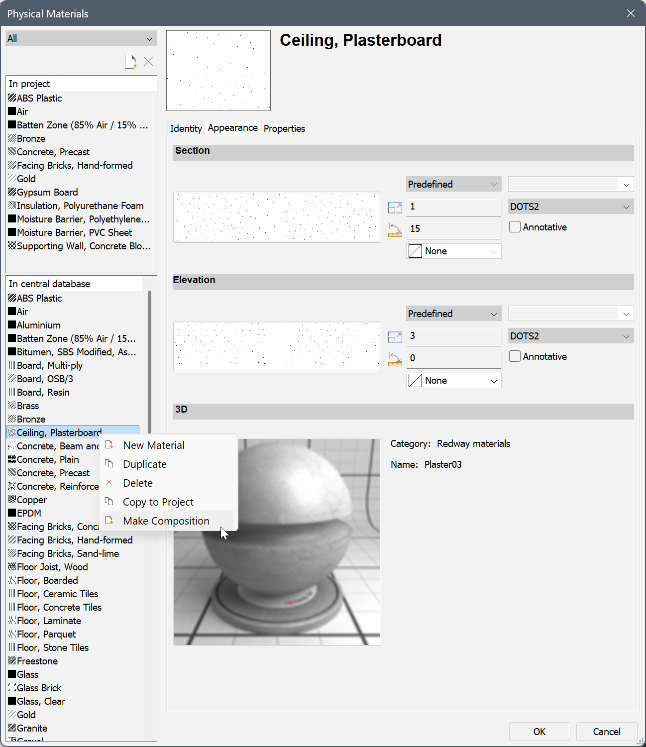

    1. Click the Add Ply button () on the right side of the Compositions dialog box.
      The Physical Materials dialog box displays.
    2. Select a material either in the Project or the Central database and double-click it or press the OK button to assign the material to the composition as a new ply.
    3. (Optional) Right-click the material and choose Make Composition in the context menu to create a single-ply composition in the selected database.
      Reopen the Compositions dialog box to see the added composition listed.
    4. To edit a ply material, double-click the Pattern or Name of the ply in the Structure grid of the Compositions dialog box.
      The Physical Materials dialog box displays. See the Physical Materials article for more information.
    5. To choose another material for a ply, double-click the Pattern or Name of the ply in the Structure grid of the Compositions dialog box.
      The Physical Materials dialog box displays. Pick a material in the Central or Project list and press OK.

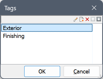

  • Adding Tags
    1. Select the Tags field in the Properties grid of the Compositions dialog box.
    2. Type the tags, separated by commas. Tags are case sensitive.
    3. Click the Browse button () next to the Tags field in the Compositions dialog box to open the Tags dialog box.
    4. Click the New Item button () to add a new tag at the bottom of the list.
    5. Select a tag in the list and click a tool button:
    6. Click the OK button to save the changes.

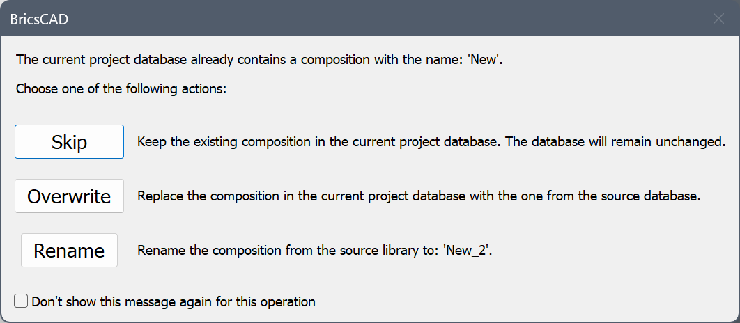

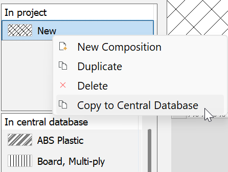

Copying compositions
You can use the following procedure in both the BIM Compositions panel and the Compositions dialog box:
  1. Select the composition(s) in the source database. Press and hold the Ctrl key to select multiple compositions.
  2. Do one of the following:
    • Drag the selection to the other database.
    • Right-click and choose Copy to Central Database or Copy to Project in the context menu.
      An alert box displays if the composition already exists in the target database:
      You can choose to skip, overwrite or rename existing compositions. Duplicated compositions have an index number added to their name.
      (Optional) Check the Don't show this message again for this operation option.
