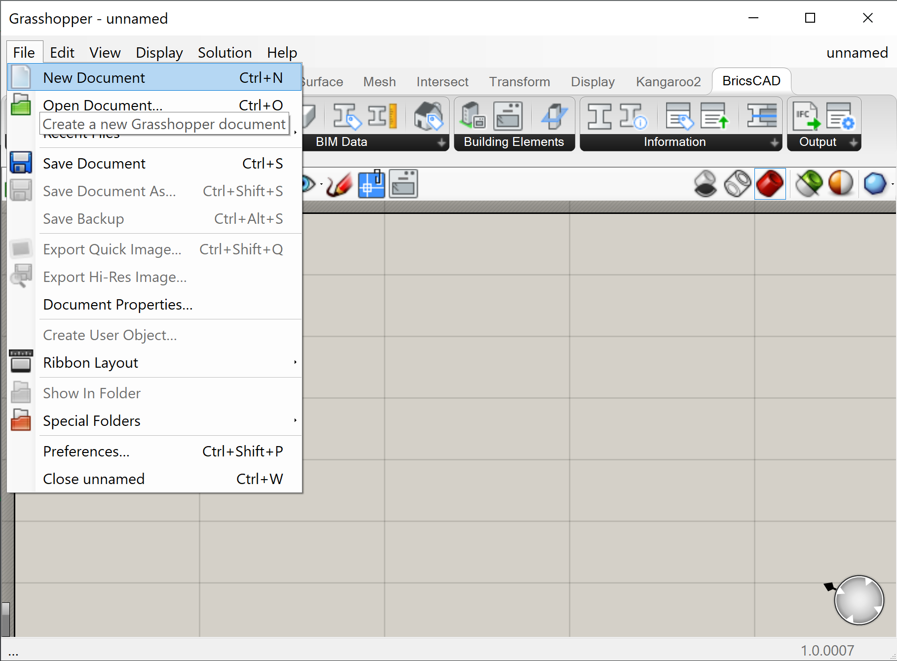

- In the File tab of Grasshopper, choose New document to open a new and empty Grasshopper script.
- Choose Open document... to open an existing Grasshopper script. You can use any script you made with Grasshopper in the past and open it in BricsCAD, as long as the input geometry from another program has been internalized. (To internalize data right-click the input geometry component and hit Internalise data.)

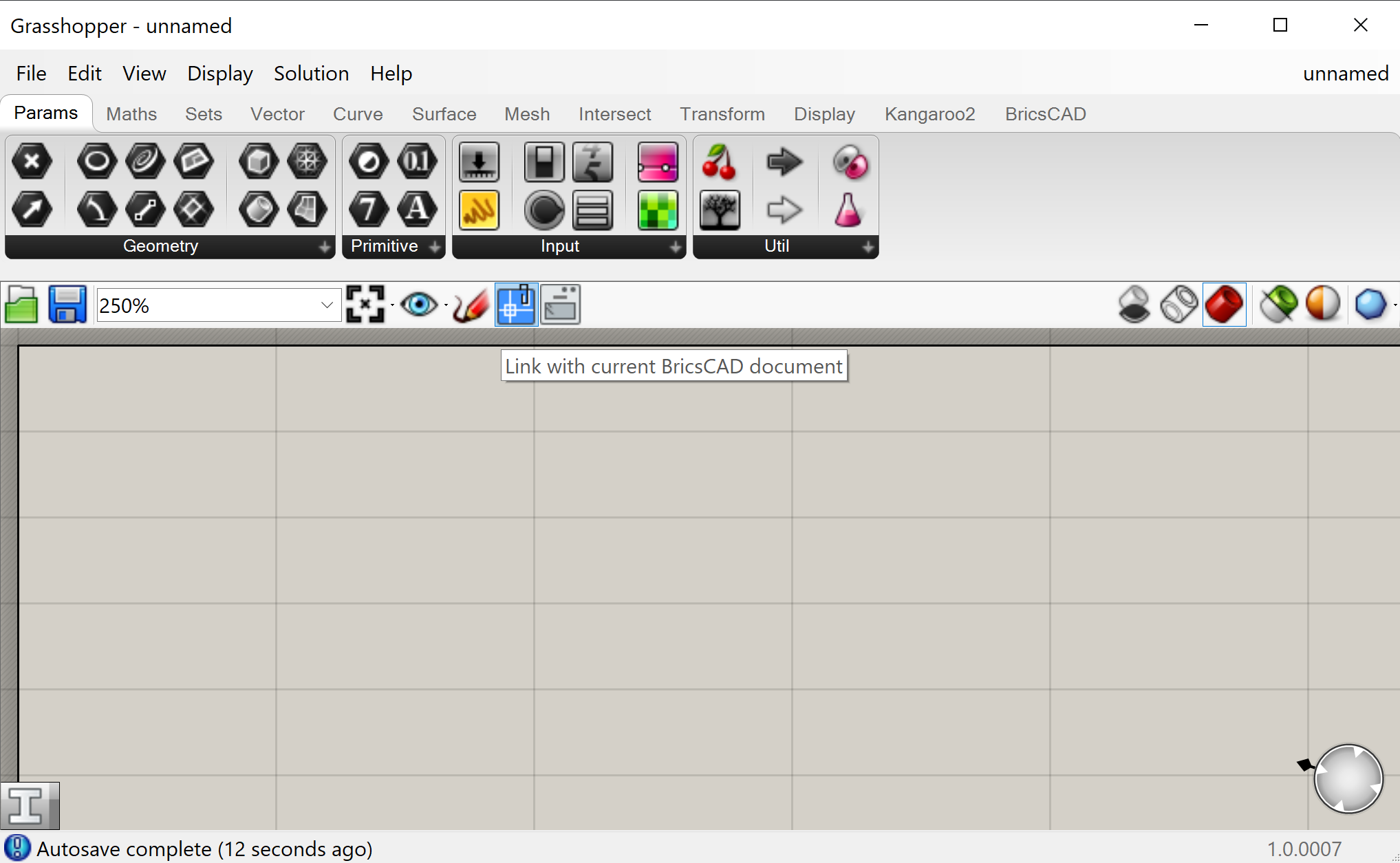

To link a Grasshopper file with a BricsCAD file
By default, the BricsCAD file that the Grasshopper document will link to the one that was active when you launched Grasshopper from BricsCAD. If you want to link it to another BricsCAD file, you need to:
- Make the target BricsCAD drawing the current drawing (i.e. the one you see in the model space window of your current session).
- Link the Grasshopper script to this open drawing. You do that by clicking the Link icon
in the bar just above the Grasshopper canvas that contains the script that you are trying to link.

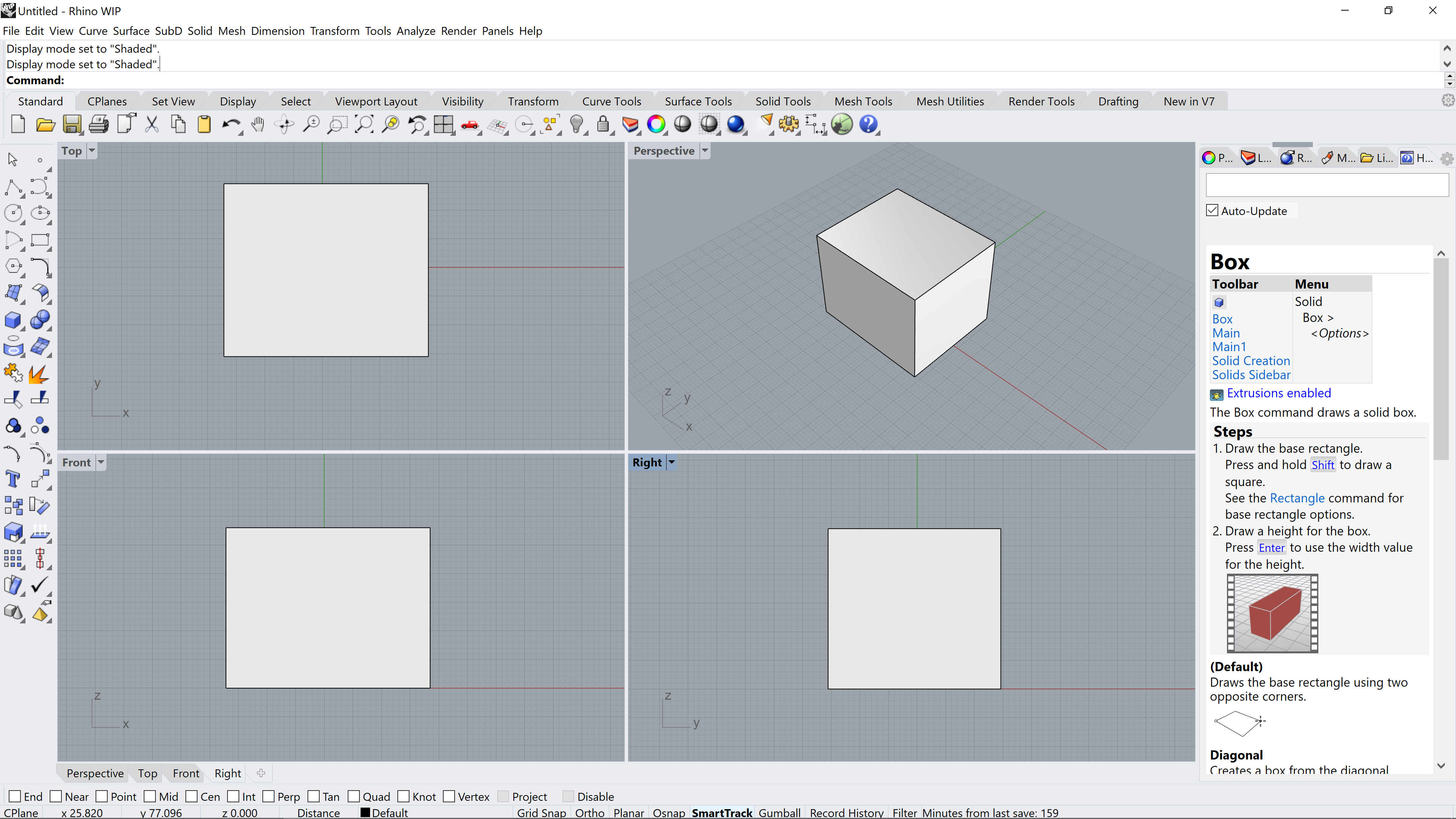

- Draw a Rhino box by typing BOX in the Rhino Command line. (This works in the same way as the BricsCAD BOX command).
- Click for the first corner of the base.
- Click for the other corner of the base.
- Click to define the height of the box.

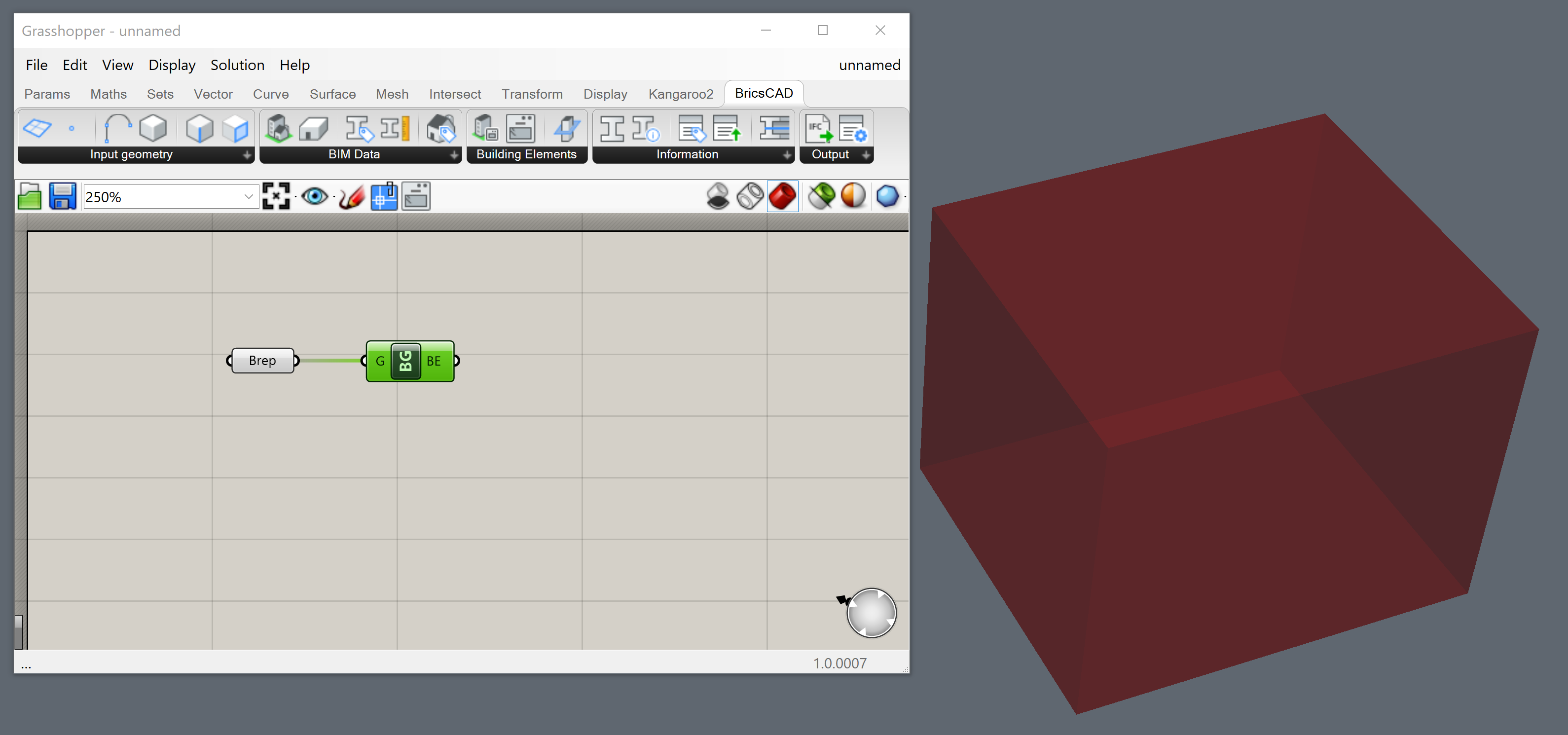

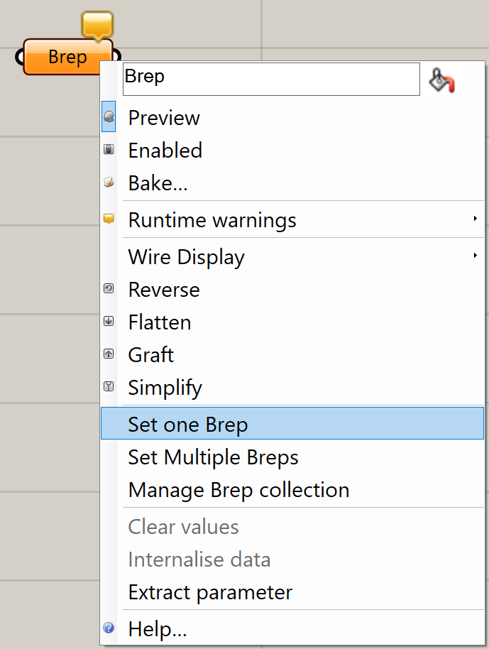

- Drag and drop the onto the Grasshopper canvas.
- Right-click on the component and select Set one Brep.
- Go to the Rhino canvas and select your cube.
- The Brep component will change color from orange to grey. If you close the Rhino window and return to the Grasshopper window, a preview of the cube will display in the BricsCAD model space.

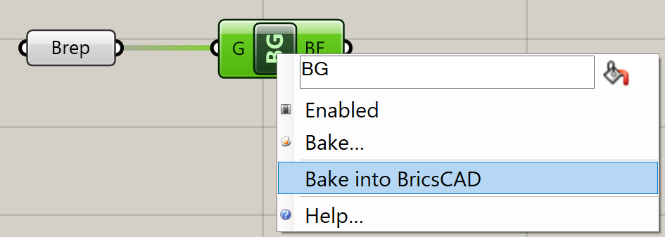

- To link the two components, click and drag from the Brep component's right dot to the BricsCAD Bake component's left dot.

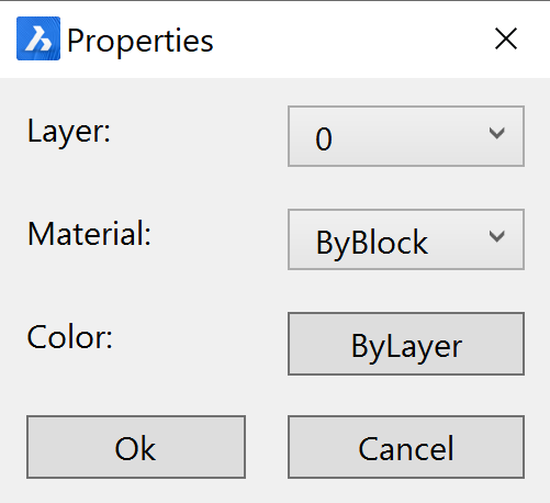

- Right-click onto the Bake Geometry component and choose Bake into BricsCAD.
The following dialog displays. Here you can choose the destination Layer, Material and Color:
- Click OK. The box is baked as a solid into BricsCAD.

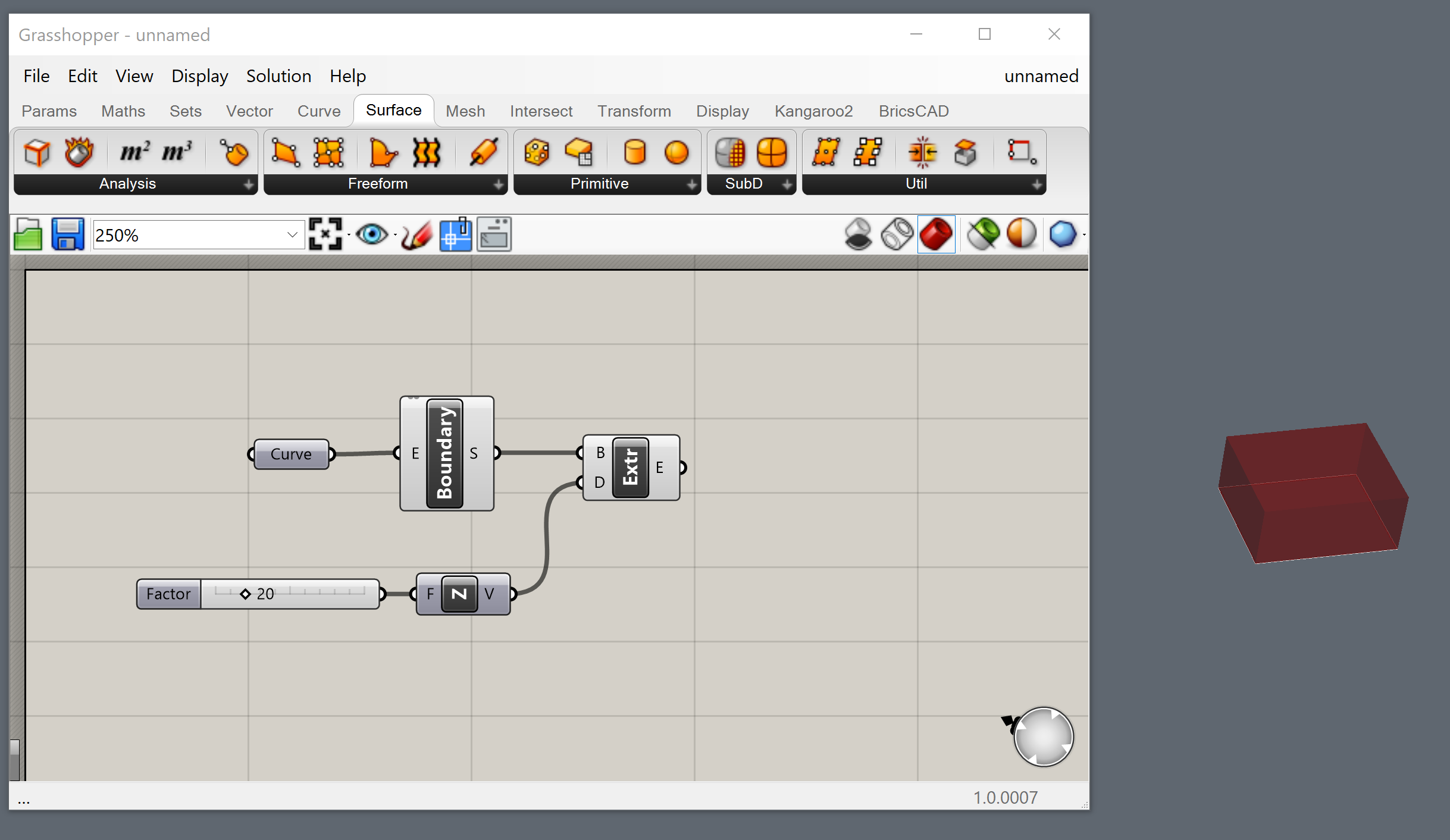

How to draw a box in Grasshopper from a BricsCAD rectangle
- To open a new Grasshopper script, click on and clicking on inside the Grasshopper environment. Save the file.
- Open a new BricsCAD file in a meter template and save it.
- To link the new script to the open .dwg file hit the Link button in the Canvas Toolbar.
- Go to the BricsCAD model space and draw a rectangle.Note: Use a polyline to create irregular geometry.
- Right-click onto the Curve component and choose Set One BricsCAD Curve.
- Go to the BricsCAD model space and select the rectangle.Note: Save time with the Quad: select the curve in BricsCAD and then select ToGrasshopper under the Grasshopper tab of the Quad. A Grasshopper component appears in the upper left corner of your Grasshopper canvas.
- Link the Curve component to a .
- Link this to a .
- In the Direction input of the Extrude component link a with . Set this to the height of your box, 17 for example.Note: You can edit the range and preciseness of the slider by right-clicking the component and selecting Edit.... A dialog box pops up where you can set the digits and min and max value of the slider.
- You now have drawn a box in Grasshopper, using BricsCAD geometry as an input.

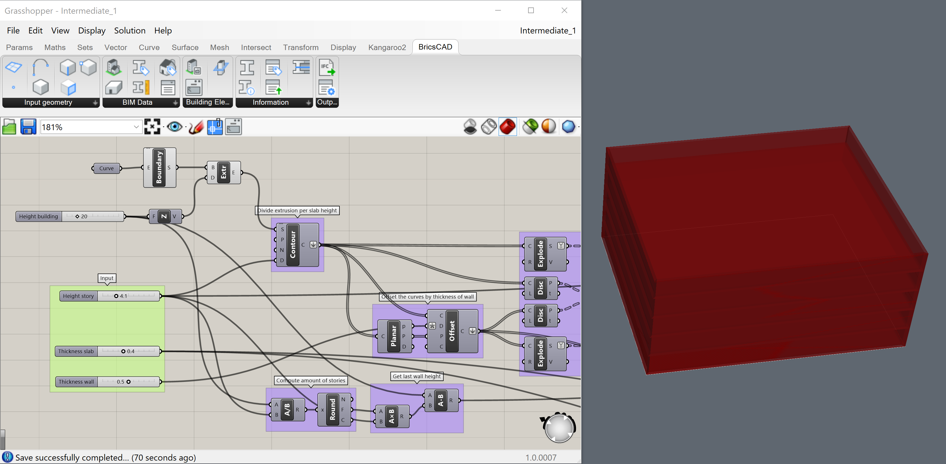

- (Optional) For intermediate files that already have these changes, use Intermediate_1.ghx and Intermediate_1.dwg. (Located in the zip file at the bottom of this page.)
- The script you just made allows you to:
- Divide the extrusion per slab height, using the Contour component.
- Offset the curves by the thickness of the walls.
- Make the bottom surfaces of the walls (the surfaces are split into lower floor walls and roof walls).
- Compute the last wall height.
- Extrude the surfaces into roof, slabs, and walls.
- Adapt the height of the building, the height of the stories, and the thickness of the slabs and walls, by using the sliders in the green Input group.

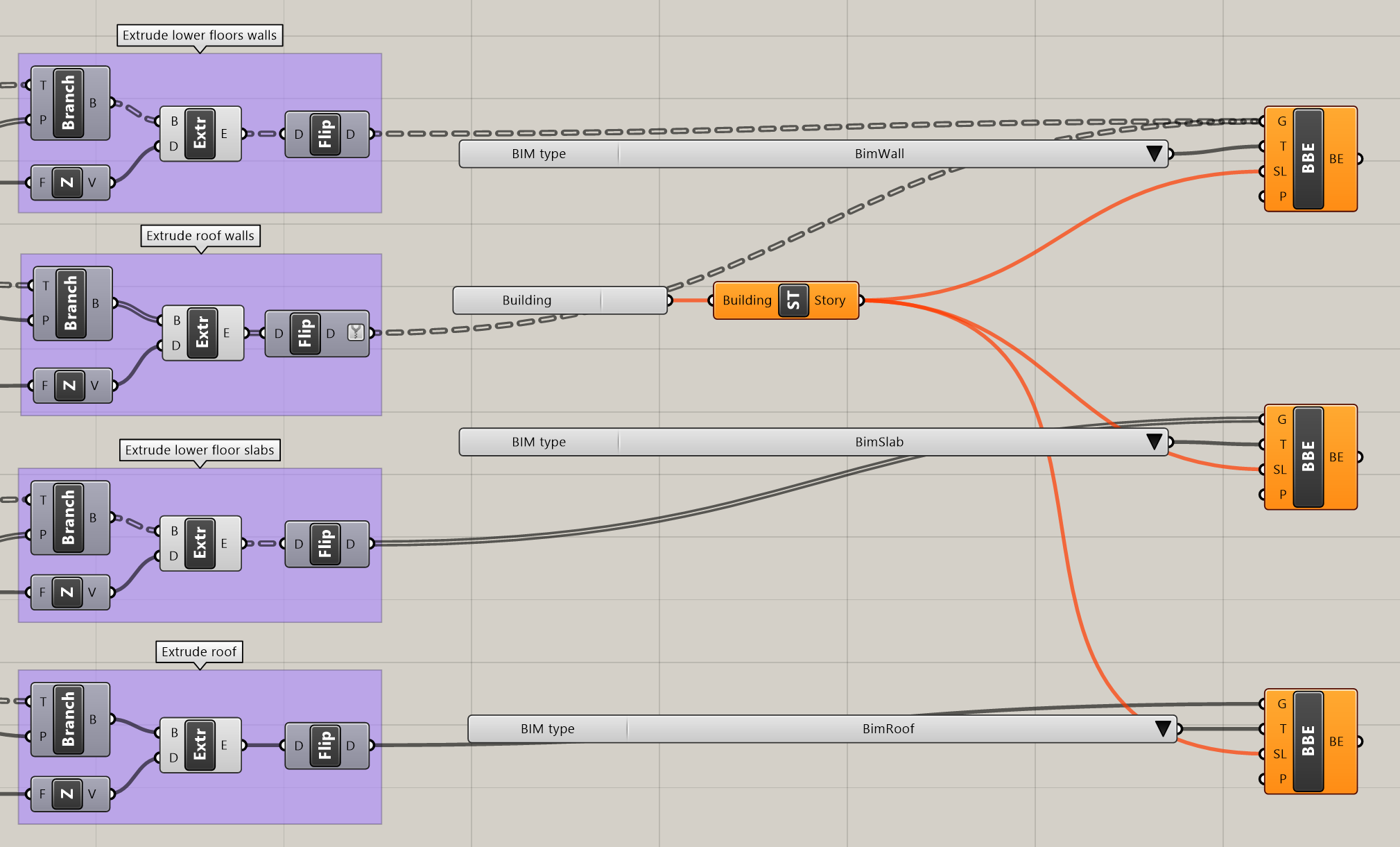

- Add 3 to the end of your Grasshopper script.
- Attach the extruded elements (the Flip components) to the Geometry input nodes of the Bake Building Element components:
- Connect the extruded lower floor walls and extruded roof walls to one Bake Building Element component. (Hold Shift while connecting multiple nodes to one input node).
- Connect the extruded lower floor slabs to another Bake Building Element component.
- Connect the extruded roof to the remaining Bake Building Element component.
- Add the following components to your canvas from the category: 1 Buildings, 1 Stories, and 3 BIM Types components.
- Attach Buildings to the Building input of the Stories component and attach this to the Spatial Location input of all the Bake Building Element components.
- Attach BIM Types (set respectively to BimWall, BimSlab, and BimRoof in the selection menu) to the Element Type input of the Bake Building Element components of the extruded walls, the slabs, and the roof respectively.
- The following warning will display: Input parameter Building failed to collect data. This is because, when no buildings are defined in the BricsCAD drawing, Grasshopper fails to collect input.

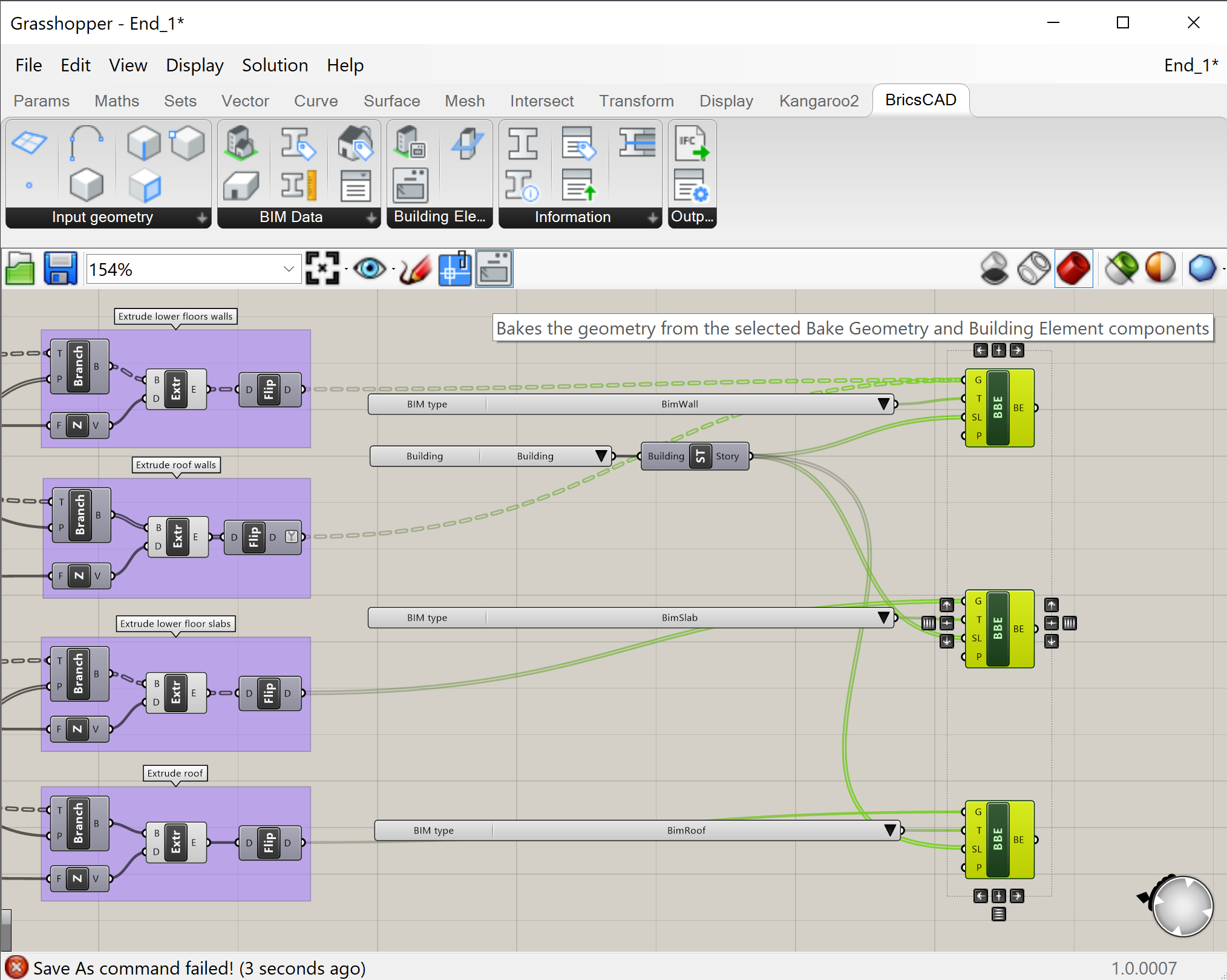

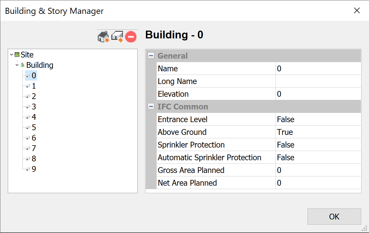

- To make spatial locations for the component to detect, go to BricsCAD and click the Spatial Locations tool in the Ribbon.

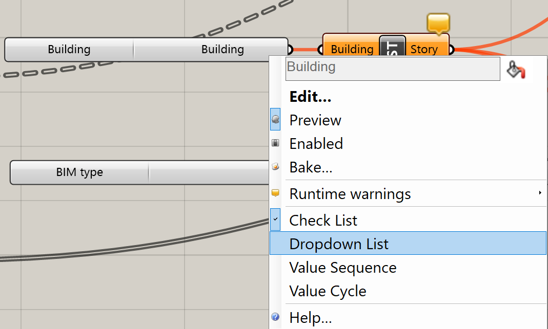

- Add a building and a few stories (more stories than you want to divide your building into).
- Go to Grasshopper and right-click the Buildings component and put it onto Drop-down List instead of Check List.
- Select the newly made building in the drop-down list.

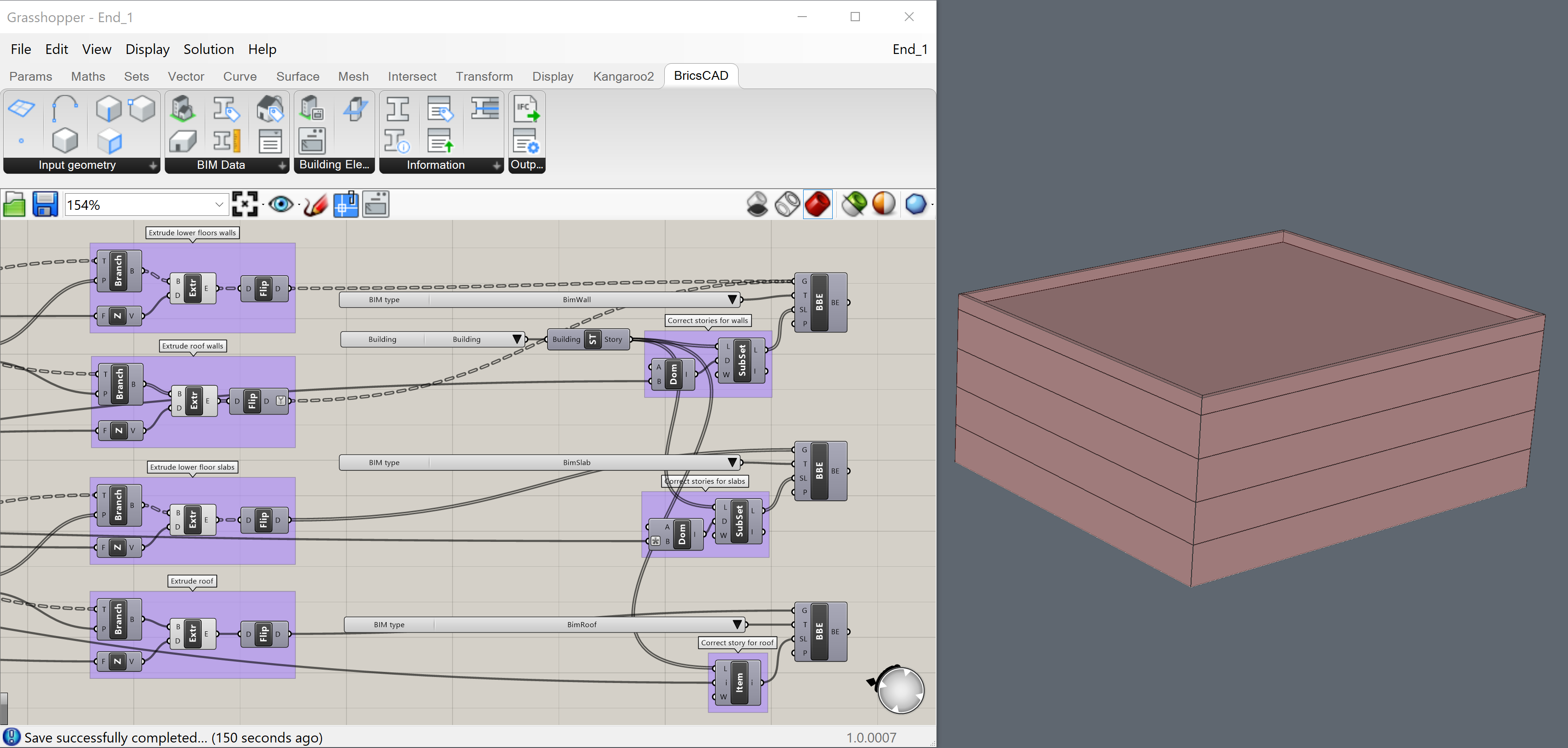

- Shift-select all the Bake Building Element components and choose the Bake option from the Canvas Toolbar. Click OK to accept the Layer, Material, and Color.
- The drawing will now have different floors.Note: Check the properties to see that the geometry is correctly classified as Wall, Slab or Roof. These elements will also have a spatial location assigned to them.
- The last input geometry will be baked onto all remaining stories as there are now more stories than geometry. To correct this, select a correct subset of the stories to assign. Bake the geometry in BricsCAD and the stories will be correct. No duplicate geometry will be baked.
You can see how it's done by opening the End_1.dwg and then opening the Grasshopper file End_1.ghx that is linked to the End_1.dwg.
- You have now successfully created a building.If you want to see the result of the baked building, check the file End_1_Baked.dwg or bake it yourself.

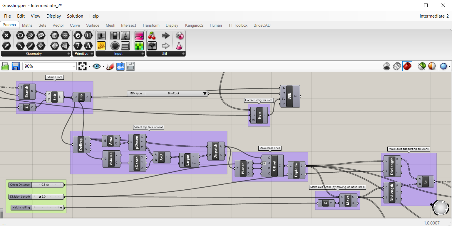

- Link the Extrude Roof group's end component to the Brep input of the Deconstruct Brep component of the Select top face of roof group.

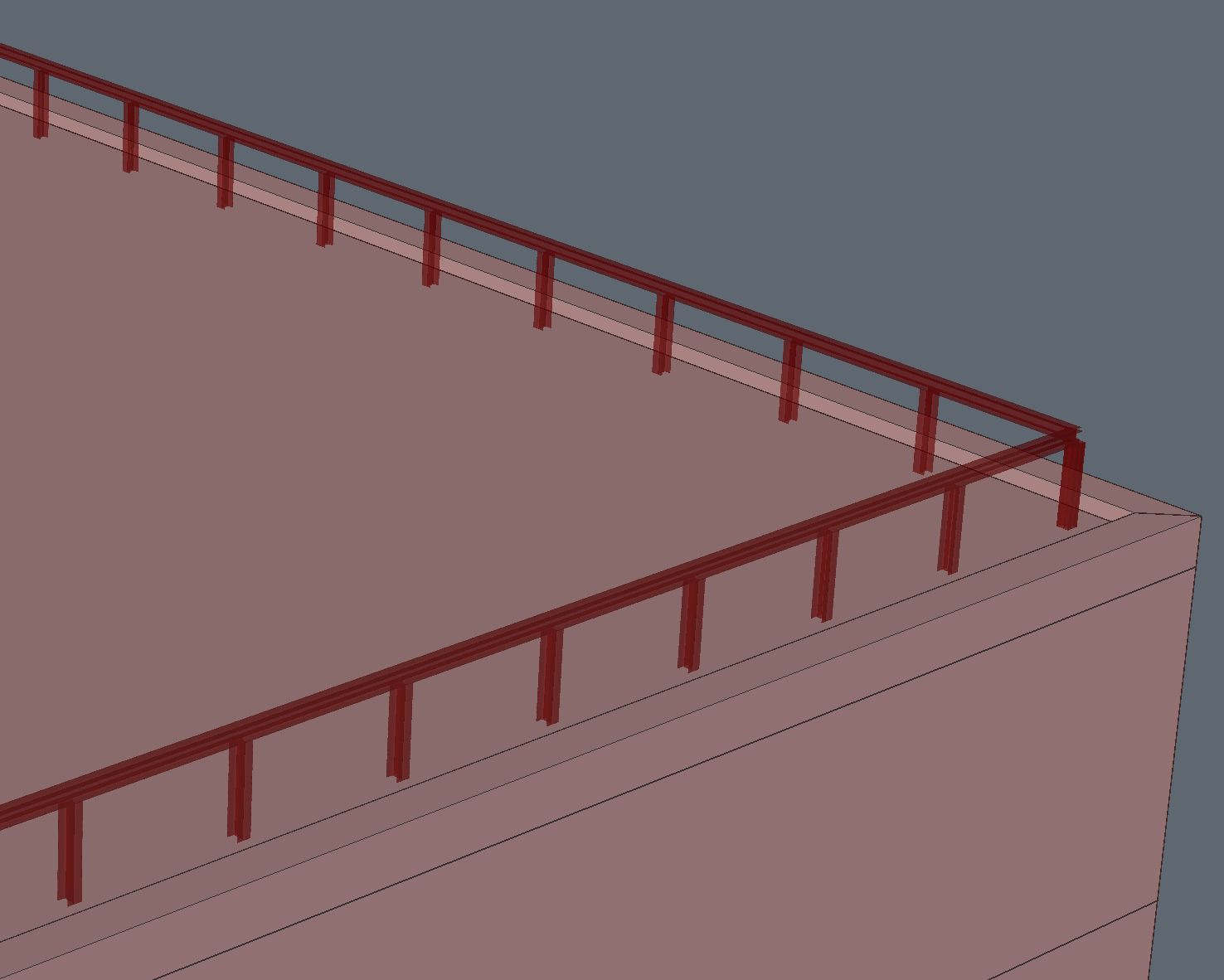

- The script does the following:
- The Select top face of roof group will select the top face of the roof.
- The remaining script will take that face and use it to make the baselines for the railing.
- It will then make the axes of the supporting columns and beams.
- It will also calculate half of the height of the beam profile.
- There is still a profile required, however, to complete this step and the following one. We will, therefore, create a profile from step 6 onward.
- With that profile and the axes, the beams and supporting columns are made as extrusions.
- The intermediate result is found in the Intermediate_2.ghx and Intermediate_2.dwg files. (Located in the zip file at the bottom of this page.)

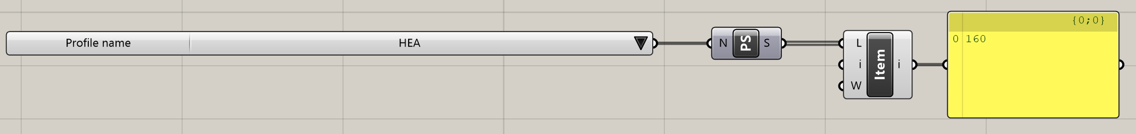

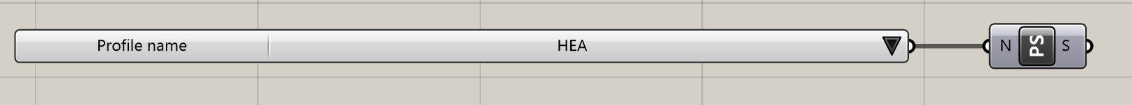

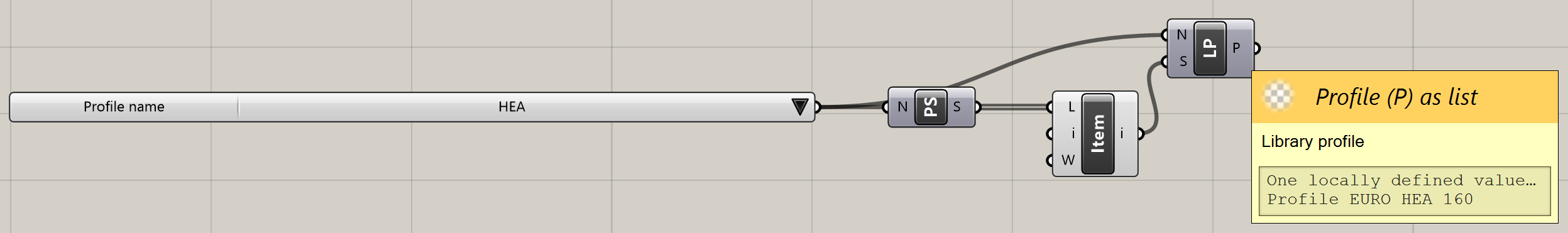

Drag the Profile Names and the Profile Sizes components onto the canvas.
- Select HEA from the drop-down list in Profile Names. This drop-down list displays all the names of the profiles in the Profile Library of BricsCAD.

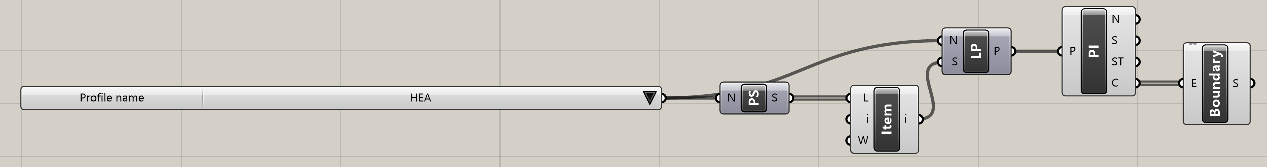

- Link the component to the input ProfileName of the Profile Sizes component.
- Link the Profile Sizes component to the input node List in a , where i is set to 4 (right-click on the i input and Set integer to 4). This List Item lets you pick one size from the list with all available profile sizes for the Profile Name linked to it.Note: If you link a to the Profile Sizes output, you will see that the index 4 stands for size 160.
Link the Profile Names and List Item components to the , to get an HEA 160 profile as an output.
- To get the curves that make up this profile, attach a to the Library Profile. One of the outputs created is the Profile Curves as a tree.
- Attach a to the Profile Curves output node. This is to later extrude the surface as a solid, instead of the lines as a surface.

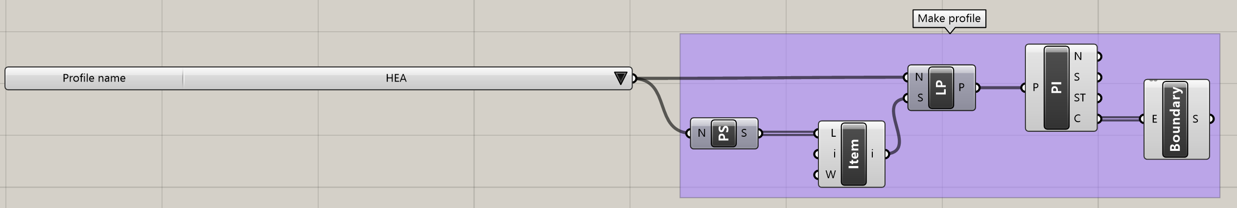

- To group together the components just created, select them (with a selection box) and right-click on Group.
- (Optional) To rename the group, right-click on the purple rectangle. Rename the group in the upper text box, e.g. to Make profile.
- The Boundary Surfaces component should now be linked to the Content input of the Bounding Box component of the Calculate half of height of beam group. The Boundary Surfaces component should also be linked to the two Profile inputs of the Extrude components in the groups Make supporting columns and Make beams. The extrusions should now show you a railing with HEA 160 beams and columns.

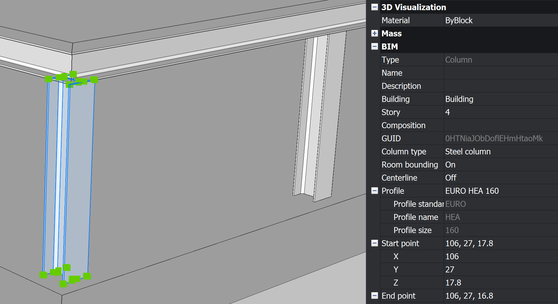

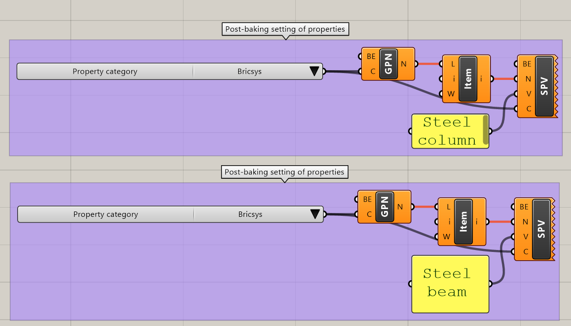

- To bake those beams and columns into BricsCAD attach two to the Grasshopper canvas.
- Do the following:
- Set the Geometry input to the extrusions.

- Set the Profiles input to the Library Profiles component from the Make profile group.
- You now successfully created a railing on top of your building. (The full script to do this is in the End_2.ghx file at the bottom of this page, which is linked to the End_2.dwg.)
- Bake into BricsCAD. The profiles are now set to the one in the Grasshopper script. You can still modify the connections of the beams in the corners by using L-Connect in BricsCAD. (To see the finished building with the railing on top of it, check out the End_2_baked.dwg file at the bottom of this page.)

- This code has some post-baking settings of classified and baked beams and columns:
- The script uses the Get Properties Names component to display the BIM properties in the Property category Bricsys.
- In those properties, it selects item 1 for the columns and item 0 for the beams, ColumnType and BeamType respectively.
- To conclude, it sets the properties to the value specified in the Panel components, using the Set Property Value components.
- To make the script work, bake the two Bake Building Element components that make up the railing.
- Now link the Building Element output of the Bake Building Element components to the respective Building Element input of the Get Properties Names components.
- Also, link the Building Element output of the Bake Building Element components to the respective Building Element input of the Set Property Value components.
- If you now select a column in BricsCAD and open its Properties, the ColumnType will be set to Steel column. When you change the value of the Panel component, the Properties in BricsCAD change in real-time.
- The resulting script: 'End_3.ghx' can be found in the zip file, located at the bottom of this page. It works with the 'End_3.dwg' file in which nothing is yet baked. Bake all the Building Elements, to get the post-baking settings.
