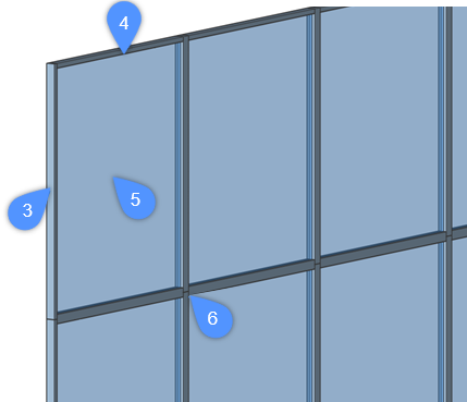

The curtain wall system consists of panels of glass. This is a panel infill for a curtain wall.
Figure 3, A curtain wall. The frame that coincides with the grid vertical (U) panels (3), the frame that coincides with the grid horizontal (V) panels (4), and glass in-fill (5) are shown. By default, the straight connection (6) is made between the beams.
Curtain walls are automatically classified as a Curtain wall in the Structure browser.
If you explode the Curtain wall, the sub-entities are classified as windows and as frames. The frames are linear solids. This allows you to calculate the length of a curtain wall.

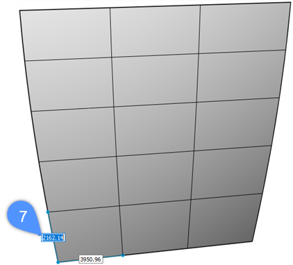

You are prompted: Create grid or [Lenght U panels/Length V panels/Number U panels/Number V panels]:
- Change the length of the U or V panels and number of U or V panels using the prompt menu and the Command line.
Or, if Dynamic dimension (DYN) is on, the length of the panels can be changed using the DYN fields (7).
- Hit the TAB key to switch between dynamic dimension boxes.
Or Press Enter to accept the current value.

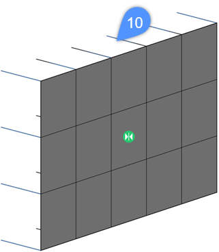

- Blue lines (10) appear on the face to show the side a curtain wall will be created.Note: Step 6 and step 7 are skipped when the face is selected from a solid. In this case the inside normal is chosen by default.

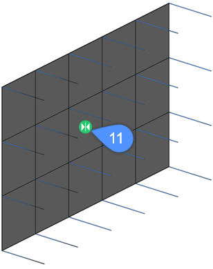

- Use the widget (11) to flip the curtain wall.

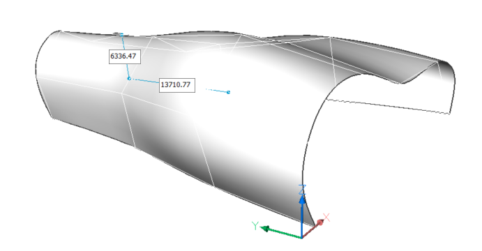

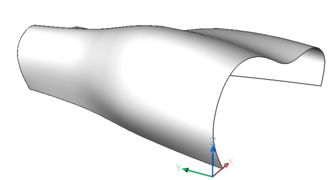

Procedure: Creating a curtain wall from a free form surface

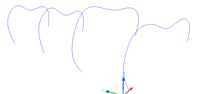

- Start with 4 splines.

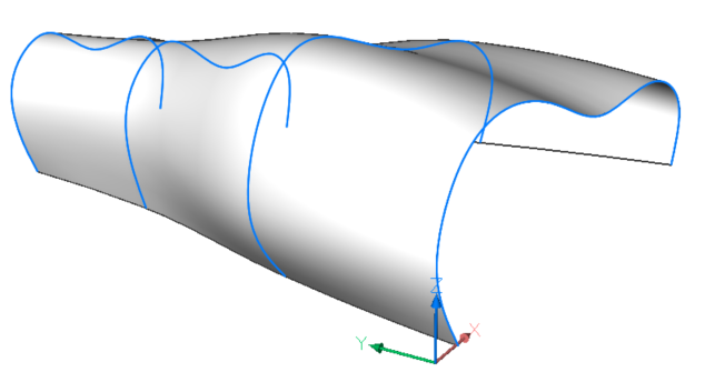

- Launch the LOFT command in the Command line.
You are prompted: Select cross-sections in lofting order [MOde]:
Select the 4 splines in lofting order.
- Press Enter twice to end the command.
- Launch the BIMCURTAINWALL command in the Command line.
You are prompted: Select a face
Select the lofted surface.

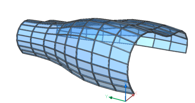

- A curtain wall grid is automatically generated from this surface.
You are prompted: Create grid or [Lenght U panels/ /Length V panels/Number U panels/Number V panels].
Change the number of the U and V panels in the prompt menu or the Command line. In this example: U = 20 and V = 8.
- You are prompted: Planarize [Yes/No] <Yes>
Click "Yes" to planarize the grid cells.
- You are prompted: Enter target deviation <0.00001>:
By default, the target deviation from planarity is set to "0.00001".
Press Enter to accept it.
- You are prompted: Change parameters or accept [Accept/Width/Depth/Glass thickness/Connections type] <Accept>: Change the parameters to:
- Width: 150
- Depth: 300
- Glass thickness: 20
- Connection type: Smooth
- Press Enter to accept. A curtain wall is created.
