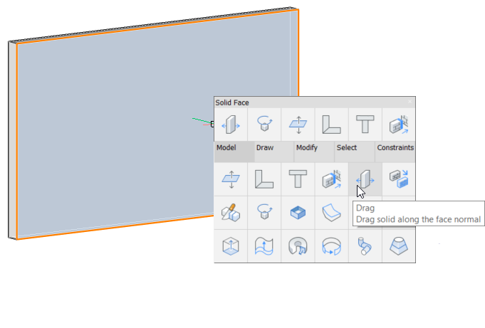

  1. Highlight or select any faces of the solid and select Drag from the Quad > Modify tab.

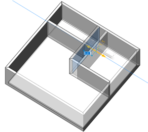

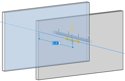

  2. Move the cursor to adjust the position of the moving solid in the dynamic dimension field, then click or enter a precise value in the dynamic dimension field and press Enter.
    Note: A ruler appears to visually represent the distance over which you will move the entity.

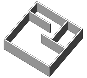

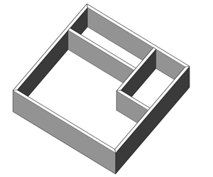

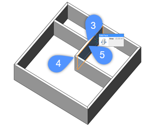

    In the following illustration, the solid behavior is shown before and after applying the DRAG in Enable connectivity mode. The connectivity between walls, i.e. T- (3) and mitered (4) connections are preserved after dragging an inner wall surface (5).

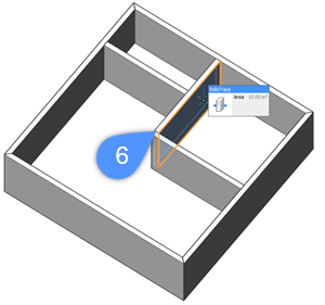

    • Select the Disable connectivity mode (default) option to move the solid while breaking the connections between solids.
      In the following illustration, the solid behavior is shown before and after applying the Drag in "Disable connectivity mode". The connectivity between walls, i.e. T- (3) and L- (6) connections are disjointed after dragging an inner wall surface (5).
