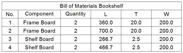

BOM columns
By default, the BOM table contains the Number, Name and Quantity columns, Thumbnails, or the desired configuration, previously defined in a template .bom file stored in BOMTEMPLATE system variable.
Using the Configure option of the BMBOM command you can add more columns, such as Description, Density, Volume, Mass, Material, Thickness (for sheet metal parts), and Parameters (for parametric components).
You can add any built-in property of components, instances or block references to the BOM table. Custom evaluated columns are also supported, using the DataExtraction technology.

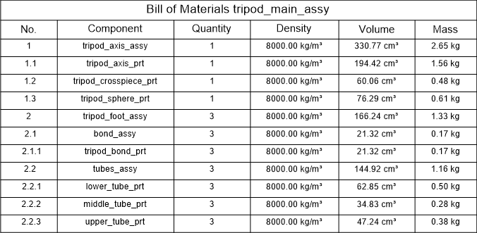

Number column and column roles
A number column is a special column to enumerate rows. It assigns numbers automatically for all rows in the BOM table, without skips and independently of other tables. Rows are numbered starting from 1.
- Prefix: A string that is added in front of any number. For example, you want all numbers to start with "A".
- Suffix: A string that is added after the number. For example, you want to add "-1" to all numbers.
- Number type: Specifies the number format:
- Full: Numbers are formatted as "1.2.3".
- Short: Only numbers for the current level show. It is used together with the Level column, which shows the level of the current part in the assembly.
- Continuous: All components are numbered continuously starting from 1, regardless of their level.
- Delimiter: Specifies the symbol to separate numbers for different levels when the number type is set to Full.

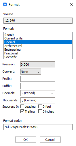

Column format
- Select the required column in the BOM manager panel.
- Choose the Format option in the context menu.
- Define the desired format in the Format dialog box.
