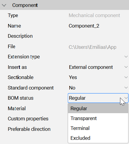

To set the BOM Status of an external or root component
- Open the file that contains the component.
- Select the root component in the Mechanical Browser.
- Set the BOM status property.

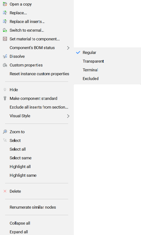

To set the BOM Status of a local component
- Select the component in the Mechanical Browser panel.
- Right-click on the selected node to open the context menu.
- Select a BOM status from the BOM status submenu.
Note: It is not possible to set the BOM status via the context menu for local components that are inserted into an external component. To do this, you must open the component that contains the local component.
