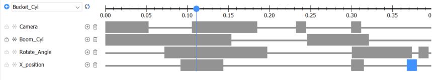

Timelines
A timeline is a visual representation of an animation sequence for an object. The timeline displays how and when the parameters will animate. Each parameter has its own timeline in a scene. Animation sequences cannot overlap. A timeline can be temporarily disabled to exclude it from an animation, or can be locked in order to disable all the possible changes of it. All timelines are independent. This means that you can animate multiple parameters at the same time and see their combined effects.

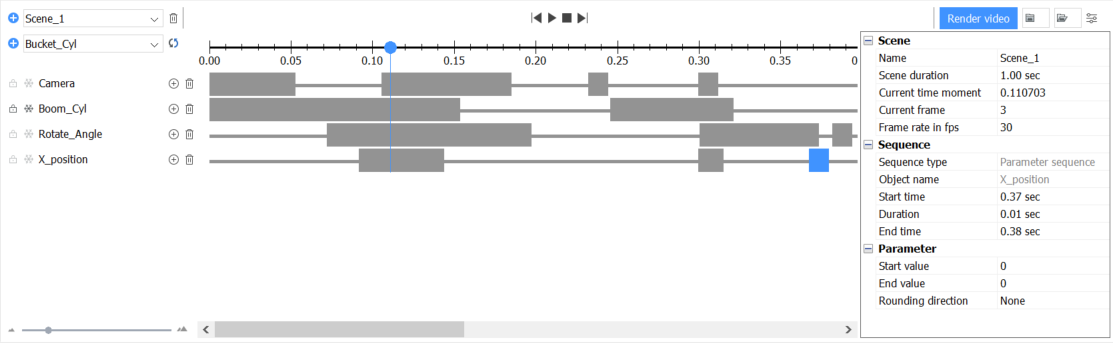

The Animation Editor interface
- Toolbar: contains tools to select a scene, adjust an animation and render a video.
- Timelines area: adds and edits the timelines and animation sequences.
- Configurator: configures the parameters of the current scene and the selected animation sequence.

Timelines Area
Use the Timelines Area to add and remove timelines and animation sequences, and to display the animation schedule. Click an animation sequence to select it, or drag the start or end of the bar to adjust the duration. The selected animation sequence displays in blue, other sequences display in gray. Each timeline in the timelines area can be temporarily disabled to exclude it from the animation.
                The Timelines Area has a cursor that represents the current position in the animation. When the animation is played, the cursor represents the current playback position. You can also manually move the cursor to a new position at any time, or edit the Current time moment or Current frame parameter. When the cursor is moved, all parameters change to match the current frame. The camera position is also updated.
To make sure that the model state corresponds to the current animation position, click  .
Time Scale
| Tool | Name | Description |
|  | Add Timeline | Adds the selected parameter to the timeline. |
|  | Object Selector | Selects the object to add to the timeline. |
|  | Update model | Updates the model state with respect to the current cursor position. |
|  | Time Scale | Displays the time marks along the timeline. |
|  | Cursor | Displays the current position of the playback. |
Timeline
|   | Timeline UnLocked | Indicates that the timeline is opened for changes. Click to lock the timeline. |
|   | Timeline Locked | Indicates that the timeline is locked for changes. Click to unlock the timeline. |
|  | Timeline Enabled | Indicates that the timeline is enabled. Click to disable the timeline. |
|  | Timeline Disabled | Indicates that the timeline is disabled. Click to enable the timeline. |
|  | Timeline Object | Displays the name of the associated object. |
|  | Add Sequence | Adds a new animation sequence, at the cursor position. |
|  | Remove Timeline | Removes a timeline from the animation. |
|  | Animation Sequence | Represents the duration and position of an animation sequence. Left-click to select the sequence. |
|  | Selected Animation Sequence | Represents the duration and position of the selected animation sequence. You can see and change the properties in the Configurator. Move the mouse to the end of the sequence, until the cursor changes to a double-sided arrow. Then left-click and drag to change the start time, end time and duration. Left-click at the middle of the sequence and drag to a new position at the timeline, without changing the duration. Note: Moving and dragging sequences supports three types of snapping that are displayed with an yellow line:
Configurator
Access all the properties of the animation scene and the selected sequence via the Configurator. All properties are grouped by object.
- Scene: properties of the current scene.- Name: displays the name of the scene.
- Scene duration: displays the duration of the scene, in seconds.
- Current time moment: displays the current animation position.
- Current frame: displays the current animation frame.
- Frame rate in fps: displays the frame rate of the scene, in frames per second.
- Sequence: properties of the selected sequence.- Sequence type (read only): displays the type of the sequence.
- Object name (read only): displays the name of the object controlled by that sequence.
- Start time: displays the start time of the sequence in seconds. The duration will be adjusted, the end time will remain unchanged.
- Duration: displays the duration of the sequence in seconds. When changed, the end time will be adjusted with respect to the start time and duration.
- End time: displays the end time of the sequence in seconds. When changed, the duration will be adjusted, the start time will remain unchanged
- Parameter (for parametric sequences)- Start value: displays the start value of the parameter.
- End value: displays the end value of the parameter.
- Rounding direction: defines the rounding direction type.
- Precision: sets the tolerance for rounding precision.
- Camera (for camera sequences)- Camera position: camera path entity type. Values:- Fixed: the camera is fixed in the given point.
- Dynamic: the camera moves along the given path.
- Camera point (when the Camera position is set to Fixed). The following controls are displayed:  List of previously used points. Select the point from the drop-down list to use one.  Click to select the point in the model. When the point is selected, a dialog box displays:   - Name: allows you to enter the point name.
- OK: accepts the point selection.
- Cancel: cancels the point selection.

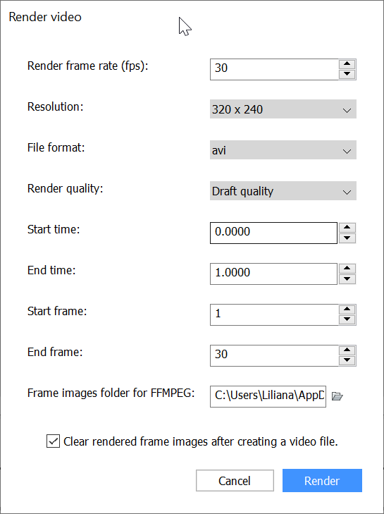

Render
- Click the Render video button to render the animation as a 2D video.The Render video dialog box displays:Render video
- Adjust the render parameters:- Render frame rate (fps): sets the frame rate.
- Resolution: sets the resolution of the video.
- File format: sets the format of the video (AVI, MPG and WMV formats are supported).
- Render quality: sets the quality of the render (draft and full quality).
- Start time: sets the time position the render will start.
- End time: sets the time position the render will end.
- Start frame: sets the frame position the render will start.
- End frame: sets the frame position the render will end.
- Frame images folder for FFMPEG: displays the folder where the frame images will be stored.
- Clear rendered frame images after creating a video file: toggles the resetting of the frame images after creating a video file.
- Click the Render button to start the render. A dialog box displays.
- Specify the location and the name of the output file.
- Click Save to start the render.A preview shows the progress.

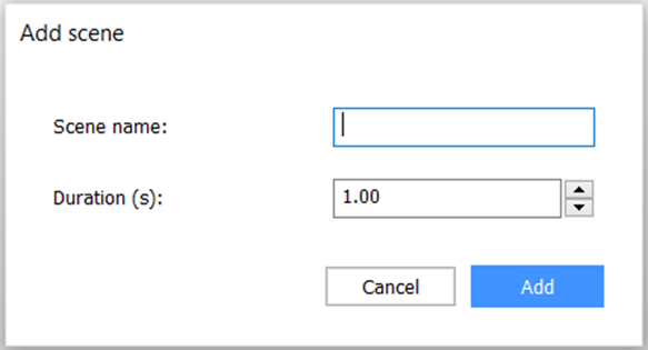

Adding a new scene
- Click the Add Scene button.The Add scene dialog box displays:Add scene
- Enter the scene name.
- Enter the scene duration in seconds.
- Click Add to add the scene.

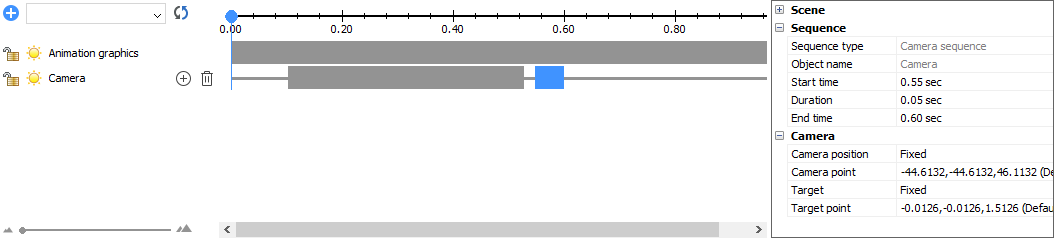

Adding a camera movement
- If applicable, add a camera timeline by selecting Camera from the Object selector.
- Place the cursor at the desired start position on the Time Scale.
- Use the Add Sequence tool on the camera timeline to add a new camera sequence, or double-click at the timeline where you want to add a new camera sequence.
- Click and drag to adjust the desired duration of the sequence, or use the Configurator to set the desired start time, end time or duration, in seconds.

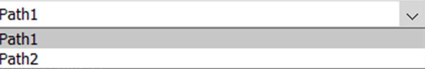

- Use the Configurator to set the camera path:- Choose the Camera position:- Fixed: the camera position will be fixed.
- Dynamic: the camera will move along the given path.
- Use the Camera point property to select the point or the Camera path to select the path.
- Select the property for editing, then click  to select the path or the point on the model, or select one of the previous points or paths from the drop-down list. to select the path or the point on the model, or select one of the previous points or paths from the drop-down list.

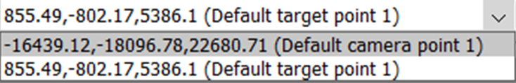

- Use the Configurator to set the target path. The target is the point where the camera will focus on.Choose the Target:- Fixed: the target will be fixed.
- Dynamic: the target will move along the given path.
 Use the Target point property to select the point or the Target path to select the path:Select the property for editing, then click to select the path or the point on the model, or select one of the previous points or paths from the drop-down list. to select the path or the point on the model, or select one of the previous points or paths from the drop-down list.

Animating an exploded view
As the Animation Editor is not supported in Block editor or reference editing modes, only exploded views inserted in the model space can be animated.
Insert the exploded view in model space.
If applicable, suppress the exploded view and the model, if you want to hide or show them during the animation.
Select the exploded view object in the Object selector.
Click  to add a timeline. to add a timeline.
Use the Add Sequence tool on the exploded view timeline to add a new exploded view sequence, or double-click at the timeline where you want to add a new sequence.
Click and drag to adjust the desired duration of the sequence, or use the Configurator to set the desired start time, end time or duration in seconds.
If applicable, use the Configurator to set the start step and the end step of the exploded view, or to enable the auto-hide option.
Rendering a video
See the section Render.
