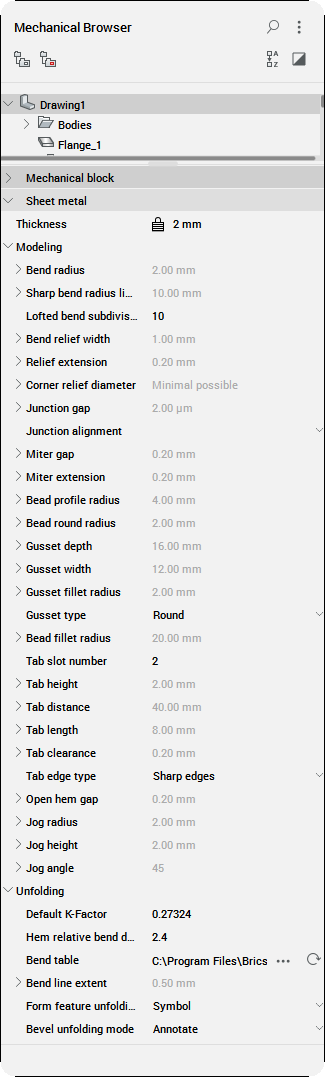

The Mechanical Browser panel controls global properties and feature-specific settings of sheet metal parts, allowing you to adjust and refine sheet metal behavior.
When working with sheet metal parts, clicking the root node in Mechanical Browser panel, displays the properties of entire drawing. Sometimes these properties are referred to as the global Sheet metal context associated with the drawing, each sheet metal part sharing this context by default.

Global Properties
Global Properties Description
Thickness Global sheet metal material thickness.
Bend radius Default radius of bend features; it can be changed per bend as well.
  • Type: either thickness ratio or absolute value.
  • Value: either ratio or value.
Sharp bend radius limit Maximum bend radius to be considered a sharp (regular) bend. Used in the SMCONVERT and SMRELIEFCREATE commands to distinguish between regular and lofted bends.
Lofted bend subdivisions Sets the default number of subdivisions for unfolded lofted bends.
Bend relief width Width of the cut near a single bend.

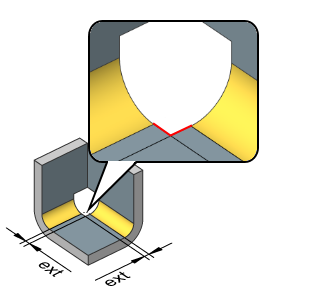

Relief extension Size of the bend or corner relief extension.
Corner relief diameter Default diameter of a circular corner relief.
Type: minimal possible or absolute value.
Junction gap Gap between 2 adjacent flanges.
Junction alignment Control the alignment of junction faces with the corresponding corner relief faces.
  • Junction Alignment: enabled or disabled
    Enabled
    Disabled
Miter gap Gap between the thickness faces of a flange or the adjacent bend when splitting, see SMSPLIT.
Miter extension Control the depth cut of an adjacent flange in case of a flange split.
Bead profile radius Radius of a tool, which creates the bead.
Bead round radius Radius of the fillet between the flange and a bead.
Bead fillet radius Radius of the bead control curve filleting. See Working with Form and Bead Features.
  • Type: either profile radius ratio or absolute value.
  • Value: numeric value.
Tab slot number Defines the tab slot number.
Tab height Defines the tab height.
Tab distance Defines the tab distance.
Tab length Defines the tab length.
Tab clearance Defines the tab clearance.
Tab edge type Controls the tab edge type.
  • Sharp edges: tab edges will be sharp.
  • Round edges: tab edges will be round. Have to define the Tab round radius type and value.
  • Chamfer edges: tab edges will be chamfered. Have to define the Tab chamfer distance type and value.
Open hem gap Defines the hem gap.
Jog radius Defines the jog radius.
Jog height Defines the jog height.
Jog angle Defines the jog angle value.
Unfolding Parameters for the unfolded representation.
Default K-Factor K-Factor for the bend radius equal to the thickness.
Hem relative bend deduction Defines the bend deduction relative to thickness used in hem features unfolding.
Bend table Display the Open dialog for bend tables in CSV file format.
Bend line extent Control how far a bend line extends beyond the unfolding boundary (zero and negative values are allowed).
Form feature unfolding mode Control the appearance of form features in the unfolded representation.
  • Keep: keep the 3D representation of the form feature.
  • Remove: completely remove form features from the unfolded representation.
  • Project: project all edges of form features as 2D entities.
  • Contour: project only the contour of form features as 2D entities.
  • Symbol: place 2D symbols at the insertion points in unfolded representation.
  • Project without center mark: project all edges of form features as 2D entities without center mark.
  • Contour without center mark: project only the contour of form features as 2D entities without center mark.
Bevel unfolding mode Control the bevel unfolding mode (see Working with Bevels article)
  • Keep: keeps all bevel features as they are.
  • Remove: all bevel features are removed.
  • Annotate: each bevel feature is removed and the edge is annotated. This mode is recommended.

Corner relief Click a corner relief feature:
  • Relief type: current relief type; either rectangular 2 bends, rectangular, v-type or circular.
  • Width: width of the cut near corner; either global, thickness ratio or absolute.
