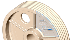

  • The DMSELECT command allows you to select edges and faces based on their geometrical and topological properties:
    • Edges of a particular length.
    • Edges that form a concave/convex network.
    • Edge loops on the border of a set of connected faces.
    • Faces of a particular area.
    • Smoothly connected faces (G1 - tangent faces, or G2 - curvature continuity).
      G0: No continuity (left), G1: Tangent Faces (middle), and G2: Curvature continuity (right)
    • Fillets of a specific radius.
    • Cylindrical protrusions of a specific radius.
    • Protrusion or depression features; pockets, extrusions, or ribs.
The value of a particular length, area, or radius can be taken from a selected edge/face.

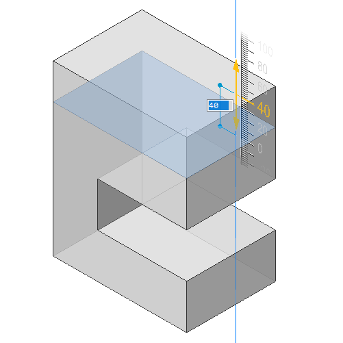

Moving faces to control dimensions

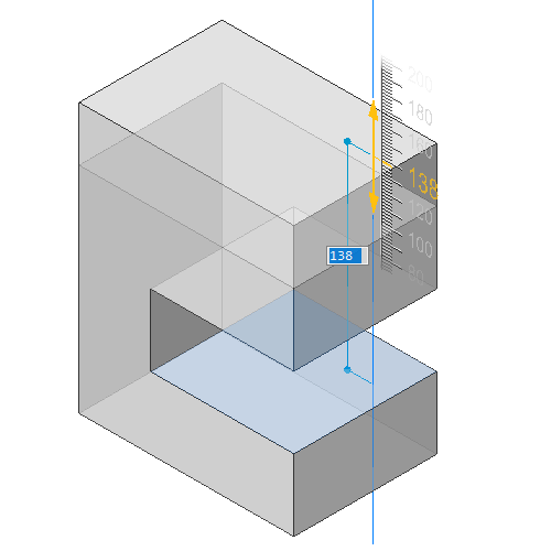

A dynamic dimension displays with the DMPUSHPULL command.
Make sure the Quad and Dynamic Dimensions are switched ON.
  1. Hover the cursor over the face you want to move.
    The face highlights.
  2. Choose Push/Pull () in the Model tab of the Quad.
    The selected face moves with the cursor and a dynamic dimension field displays the relative distance along with a ruler.
    When the cursor is on the ruler, the face moves with fixed intervals. Zoom in or out to increase or decrease the interval.
    When the cursor is outside the ruler, the face moves freely.
  3. (Option) repeatedly hit the Tab key to see the distance with respect to an internal face, parallel to the selected face (left) or the bottom face (right).
    Press and hold the Shift key and hit the Tab key to reverse the display order of reference faces.
  4. Do one of the following.
    • Type a value in the dynamic dimension field, then hit Enter.
    • Using the ruler: click when the desired value displays.

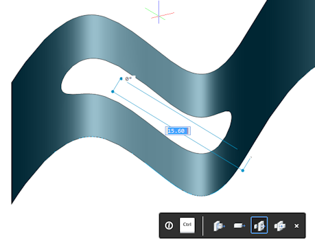

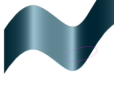

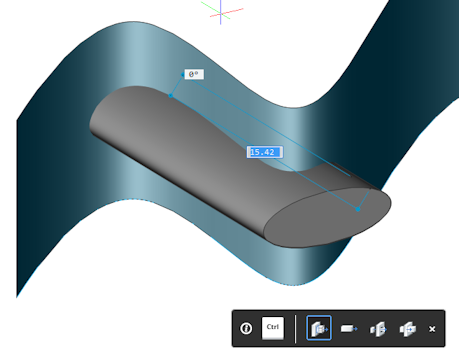

To make a hole in a surface
  1. Create a 2D closed entity, e.g. an ellipse.
  2. Place the cursor over the 2D closed entity, then choose Solid Extrude () (DMEXTRUDE command) in the Model tab of Quad.
  3. Extrude the 2D entity in the direction of the surface.
    The default extrusion direction is perpendicular to the plane of the 2D entity.
    The Hotkey Assistant (HKA) appears at the bottom of the screen.
  4. Hit the Ctrl key twice to select the Subtract option of the DMEXTRUDE command.
  5. Click to create the opening.

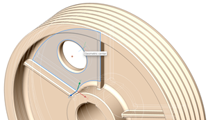

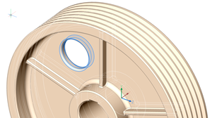

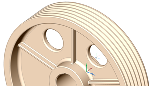

Copying a Feature
The DMCOPYFACES command allows you to copy one or more features from a 3D solid (depressions - holes, grooves, and pockets - or protrusions - extrusions and ribs), to a new location on the same or a different 3D solid.
Make sure dynamic UCS is enabled.
  1. Select all faces of the entire feature(s).
  2. Click the Copy Faces () tool:
    • on the Ribbon: Modeling | Edit | Copy Faces.
    • on the Direct Modeling toolbar.
    • in the menu bar: Model | Direct Modeling | Copy Faces
    • in the Model tab on the Quad
  3. Specify the base point.
    You are prompted: Select an insertion point or [Rotate/mUltiple/MOde]:
  4. (Optional):
    • Use the Rotate option to rotate the faces around the Z axis of the UCS.
    • Use the Multiple option to insert the multiple copies of a feature.
  5. Specify the insertion point.
    The feature is copied from the base point to the insertion point with dynamic UCS.
    Select the faces of the entire feature Specify base point
    Specify the insertion point The feature is copied

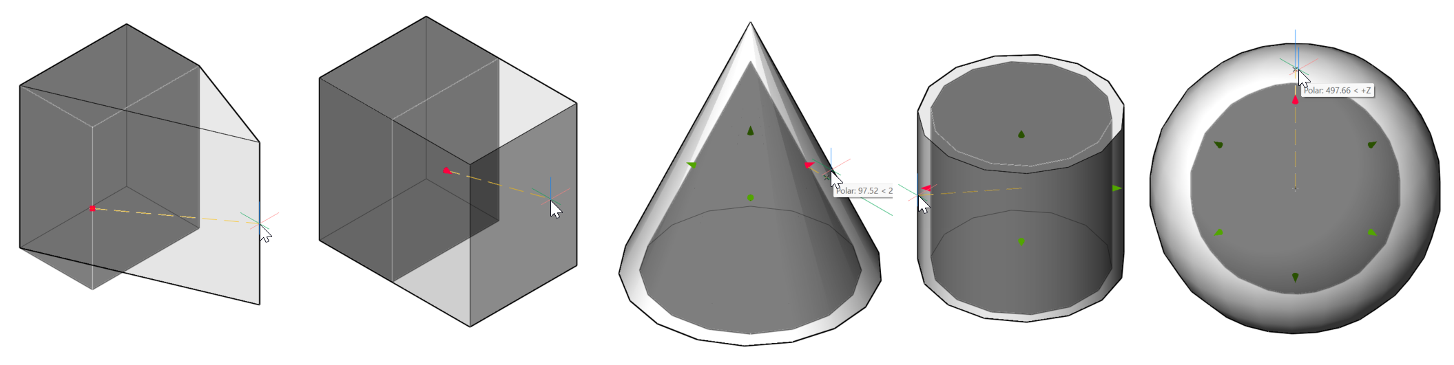

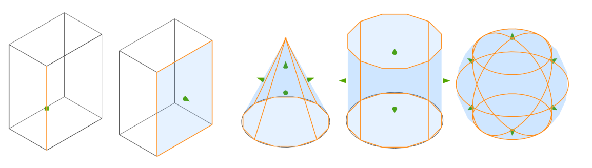

Stretching a solid with grips
A 3D Solid can be stretched by moving the grips.
When you select an edge, face, or an entire solid, specific grips are highlighted.
A square grip appears at the center of a selected edge, while a 3D grip appears at the center of a selected planar face. For cylindrical or spherical faces, multiple 3D grips are available, allowing for quick stretching in Model Space.
Note: This option is not available in the BricsCAD Lite license level.

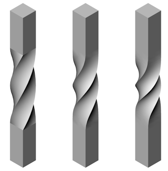

For a twist deformation, it is possible to specify the continuity between the deformed and the fixed portion of the entities.
Deformation can be defined in several ways:
  • DMTWIST command: Twist the whole entity or a portion.
