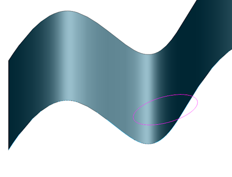

To make a hole in a surface
- Create a 2D closed entity, e.g. an ellipse.
- Place the cursor over the 2D closed entity, then choose Solid
Extrude (
) (DMEXTRUDE command) in the Model tab of Quad.
- Extrude the 2D entity in the direction of the surface.
The default extrusion direction is perpendicular to the plane of the 2D entity.
The Hotkey Assistant (HKA) appears at the bottom of the screen.
- Hit the CTRL key twice to select the Subtract option of
the DMEXTRUDE command.
- Click to create the opening.
