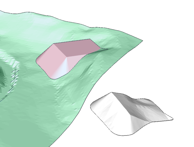

Creating a TIN Volume using a comparison TIN Surface
- Launch the TINVOLUME command.
- Choose a base surface. In this example, the green TIN surface is chosen as the
base surface.
- Choose a comparison surface. In this example, the red grading is chosen as the comparison surface.
- Select a bounding area as the area to apply the operation or press Enter. The outer boundary of the surface will be used as a boundary.
- The TIN Volume Statistics category appears under the TIN Volume
Surface Properties panel and displays the Cut
volume and Fill volume inside bounding area:The Tin Volume Surface Properties panel under the Data category contains information about:
