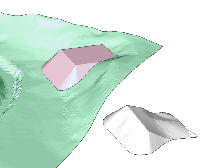

Creating a TIN Volume using a comparison TIN Surface

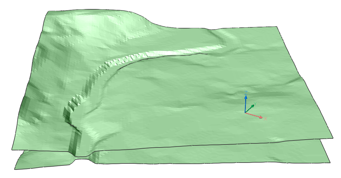

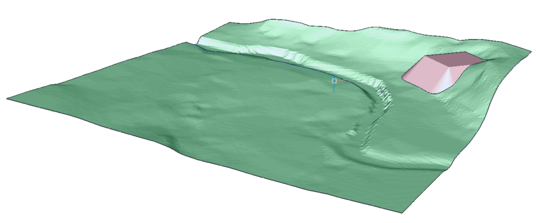

  1. Launch the TINVOLUME command.
  2. Choose a base surface. In this example, the green TIN surface is chosen as the base surface.
  3. Choose a comparison surface. In this example, the red grading is chosen as the comparison surface.
  4. Select a bounding area as the area to apply the operation or press Enter. The outer boundary of the surface will be used as a boundary.

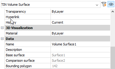

  5. The TIN Statistics category appears under the TIN Surface Properties panel and displays the Cut volume and Fill volume inside bounding area:
    The Tin Volume Surface Properties panel under the Data category contains information about:
    • Name
    • Description
    • Base surface (read-only)
    • Comparison surface (read-only)
    • Bounding polygon (read-only)

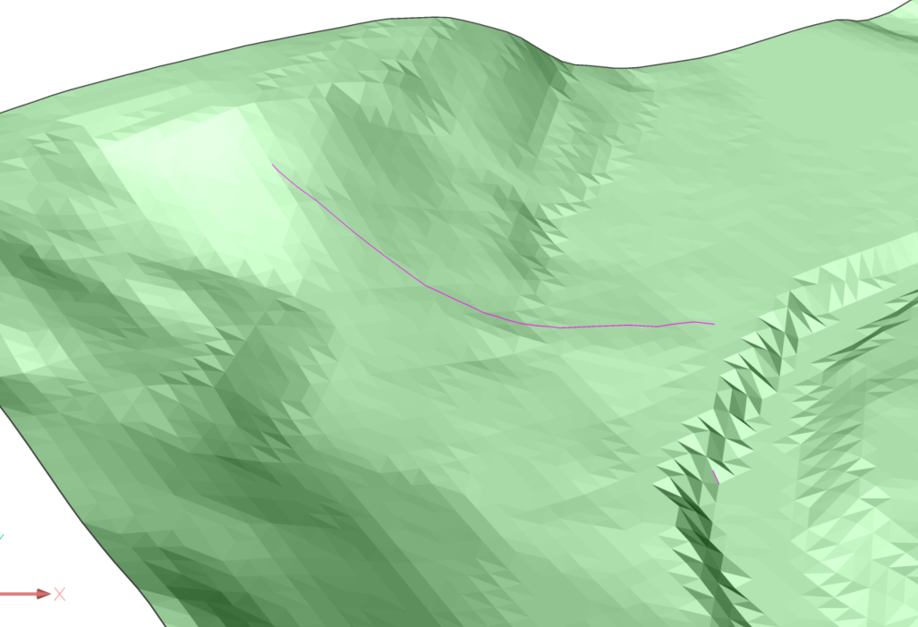

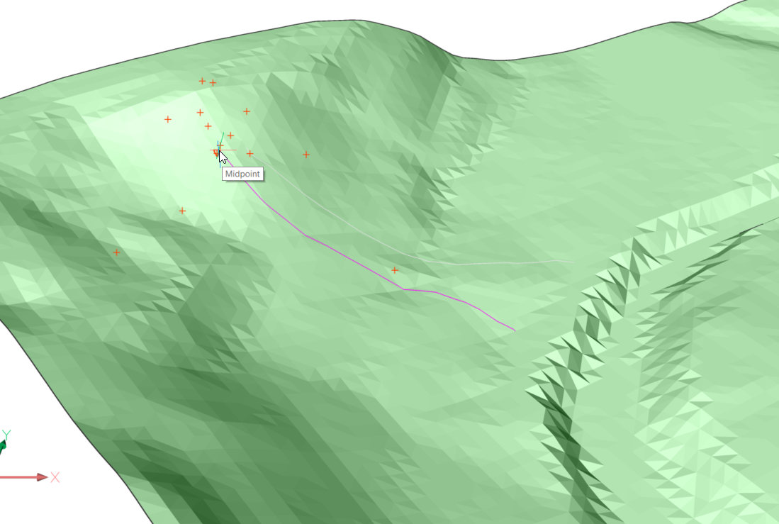

The TINWATERDROP command creates water drop paths in real-time by moving the cursor over a TIN Surface. A water path is created as a 3D polyline in the current position if you click the mouse button.
Procedure: Creating a water drop path
  1. Launch the TINWATERDROP command.
  2. Select the TIN surface.
  3. Move the cursor over the surface, a line representing the drop path is shown in real-time.
    Note: A colored water drop path is more clearly visible. To color the water drop path, change the current layer to another color, e.g. red.
  4. Left click the mouse to create a 3D polyline of the water drop path.
