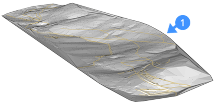

- Open a TIN surface with surface points (1)

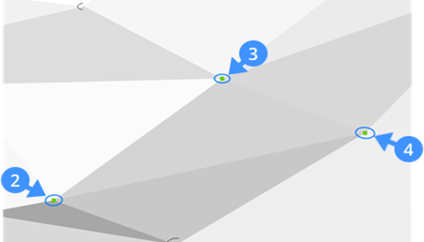

- The value is calculated as an interpolated elevation for selected point inside triangle (2,3,4).
- If ESNAP is ON, you can check the elevation of a point in the cursor coordinate.

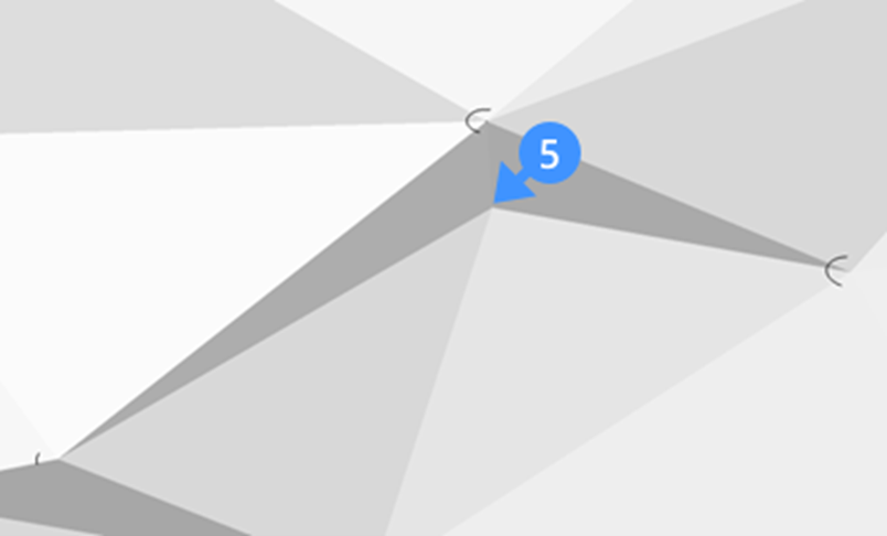

- Keep adding points to the surface, or press Enter to exit the command. The new surface point (5) is added from entities, such as polylines vertices.

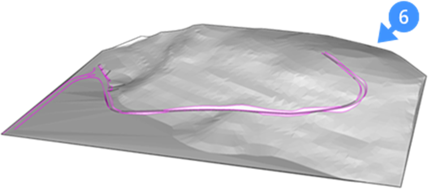

- Open a TIN surface (6).
- Select the TIN surface and launch the TINEDIT command.

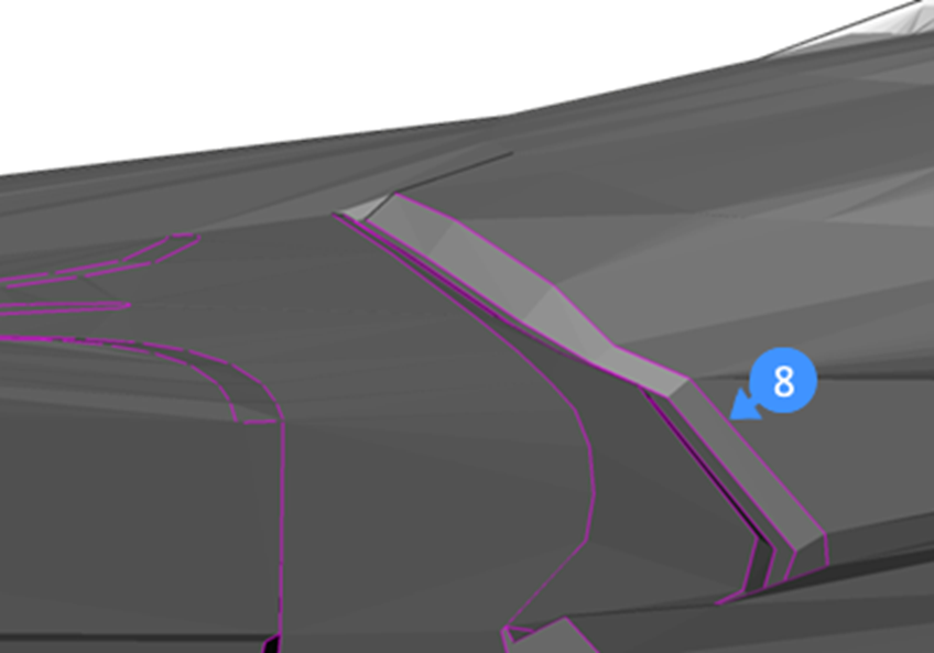

- Select Add Breaklines or type AB in the Command line.

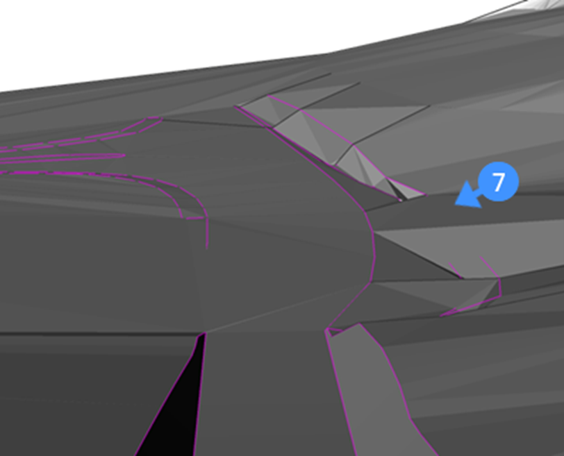

Note: The retaining wall breaklines before adding breaklines to the surface (7). - Select the breaklines you want to add. This will modify the surface according to the selected breakline (8).Note: If the breakline is moved, the surface will be updated automatically.

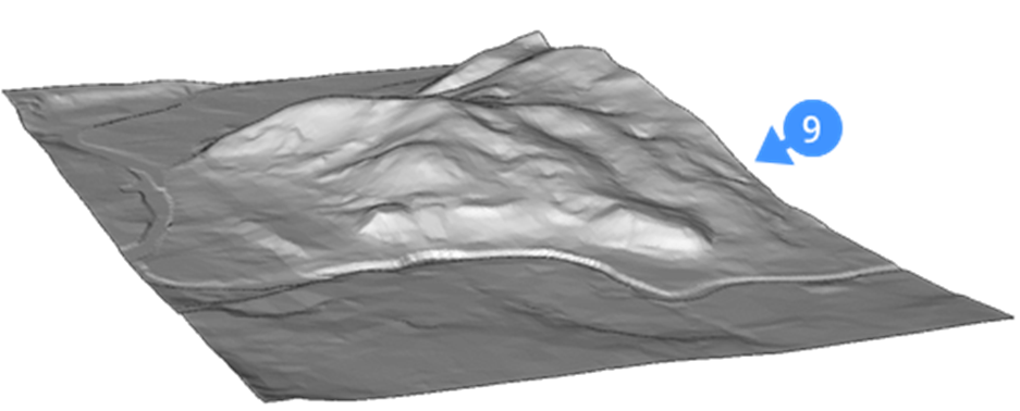

- Open a TIN surface where you want to create a boundary (9).

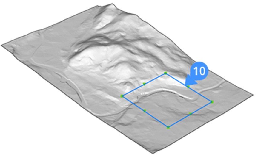

- Create a closed boundary on the location where you want to clip the surface (10).Note: Make sure that Entity Snap Tracking (ESNAP) is active.

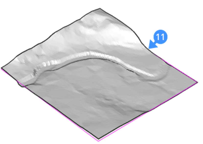

- Click on the closed boundary to use in the surface boundary definition and press Enter.Note:

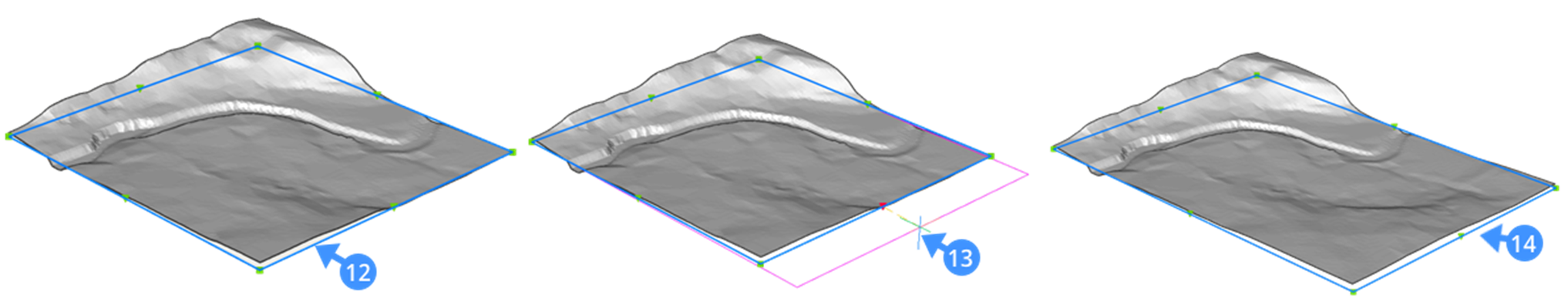

- By default, the outer option is selected, which allows creating an outer surface boundary (11).
- Select the bounding entity (12) (e.g. polyline) to resize the surface boundary. Moving the grip (13) of the entity changes the surface dynamically (14).

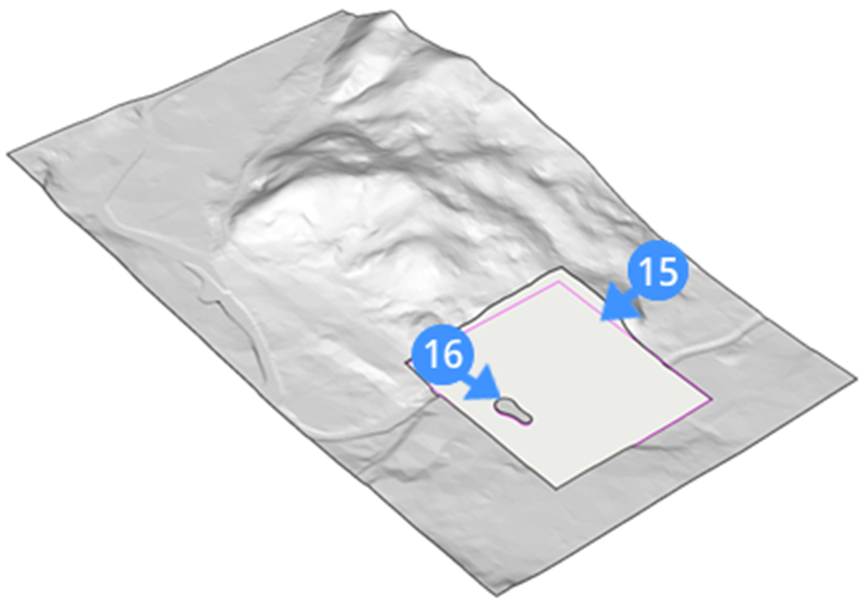

- Select the hide option to exclude a part of the surface from the TIN when calculating the total area.
- Select the show option to reveal the hidden surface in the TIN.
- The hidden part according to the closed boundary (15) is shown, the surface of the hidden part revealed (16) using the show option.
