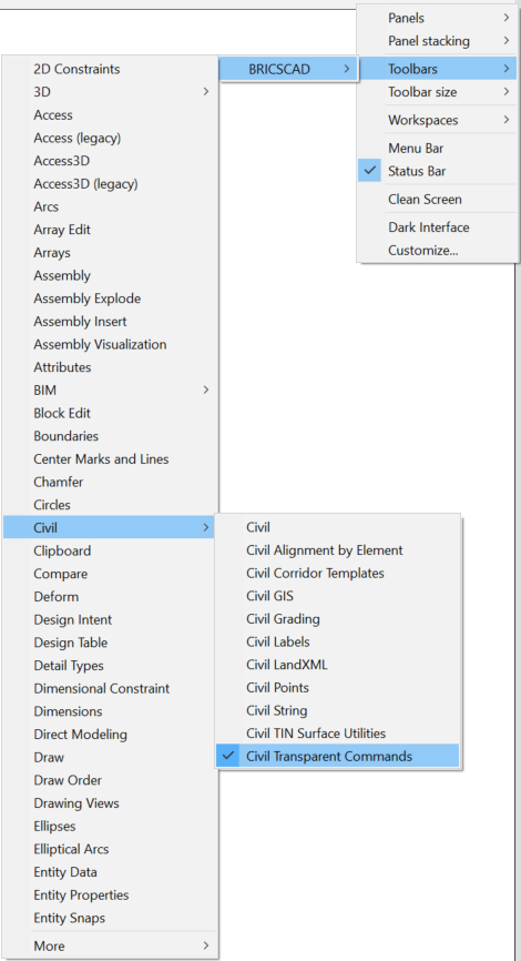

You can run the transparent commands within another command (for example, PLINE, 3DPOLY, ALIGNMENT) by using the following methods:
  • Click the command in the Civil Transparent Commands Ribbon panel in the Home tab of the Ribbon.
  • Enter the command at the Command line.
  • Activate the Civil Transparent Commands toolbar and select the command.
    To activate the Civil Transparent Commands toolbar, right-click the Ribbon, go to Toolbars, select BRICSCAD, and under Civil, select Civil Transparent Commands.

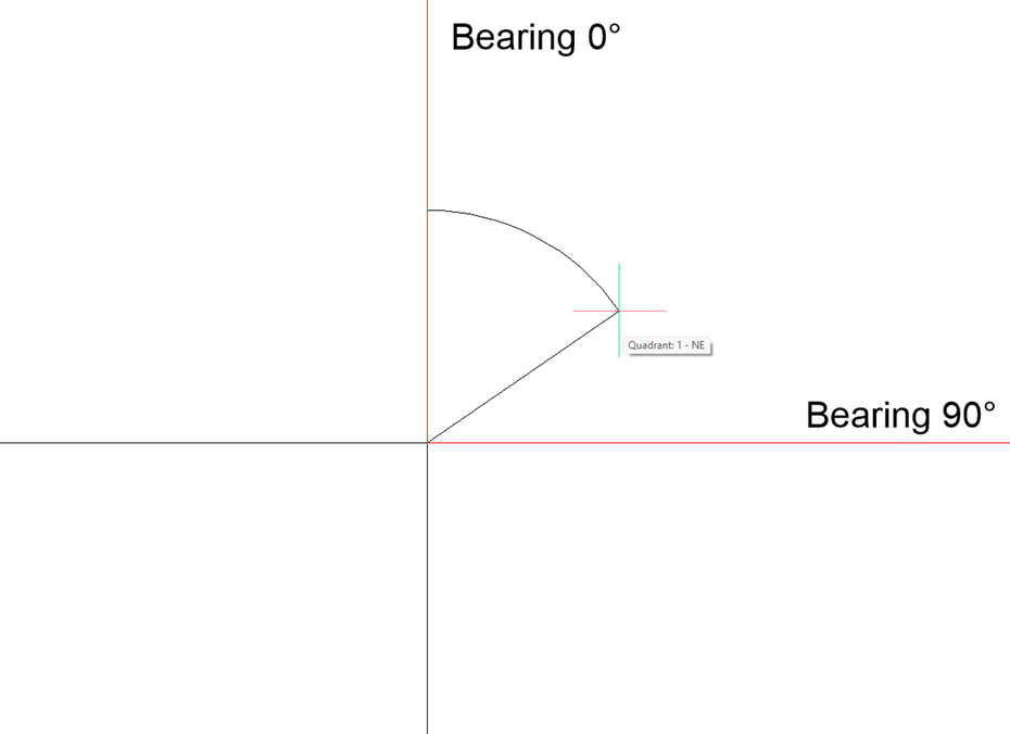

Bearing and distance
Alias: 'BD
Specifies a point location at a bearing and distance from a known point. The output is a coordinate of a new point.
Options within the command
Specify quadrant
Allows you to select the quadrant needed.
Quadrants: NE = 1, SE = 2, SW = 3, NW = 4
Specify bearing
Specifies the angle measured inside the selected quadrant. The measurement is very precise (degrees, minutes, seconds).
You can specify the angle dynamically on the drawing or by typing it in the Command line. (NE: 0, 90: SE: 90, 0: SW: 0, 90: NW: 90, 0 - As an example, for NE, 0 represents the N axis and the starting axis for measurement. The ending axis is represented by 90 degrees and in our example, that is the E axis.)
Or, you can enter the angle in decimal numbers and it will be converted to degrees, minutes and seconds (the first two decimal digits represent minutes and the second two represent seconds).
Note: The valid values are:
  • for degrees: 0-90
  • for minutes: 0-59
  • for seconds: 0-59
Specify distance
Specifies the offset from the origin of the quadrant at the previously specified angle. You can specify the distance dynamically on the drawing or by typing it in the Command line.
Example
Run the PLINE command:
: PLINE
Select start of polyline or [Follow] <Last point>:
Set next point or [draw Arcs/Distance/Follow/Halfwidth/Width]:
Set next point or [draw Arcs/Distance/Follow/Halfwidth/Width/Undo]: 'BD
>>Specify quadrant [1 for North East, 2 for South East, 3 for South West, 4 for North West]: 1
>>Specify bearing: 40d30'20"
>>Specify distance: 123
Resuming PLINE command

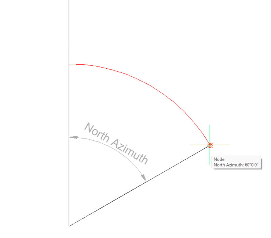

Azimuth and distance
Alias: 'ZD
Specifies a point location at an azimuth and distance from a known point.
Specify azimuth
Allows you to select an angle relative to the line previously created by the command. This can be done dynamically in the drawing or by typing the exact angle in the Command line (degrees, minutes, seconds, or in decimal numbers).
Specify distance
Allows you to specify the offset from the starting point. This can be done dynamically or by typing it in the Command line.
Example
: pl
Select start of polyline or [Follow] <Last point>: 0,0
Set next point or [draw Arcs/Distance/Follow/Halfwidth/Width]: '_ZD
Specify azimuth: 60
Specify distance: 50

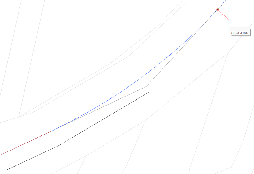

Station and offset
Alias: '_SO
Specifies a point location at a station and an offset from a curve.
Select curve
Allows you to select a horizontal alignment, line, or polyline to apply stations.
Specify station
Allows you to select any point on the alignment, line, or polyline as starting point.
Specify offset
Creates a supporting line, perpendicular on the station. This allows you to specify the offset on the supporting line. You can select the distance graphically or by typing it in the Command line.
Example
: PLINE
Set next point or [draw Arcs/Distance/Follow/Halfwidth/Width/Undo]: '_SO
>>Select curve:
>>Specify station:
>>Specify offset:

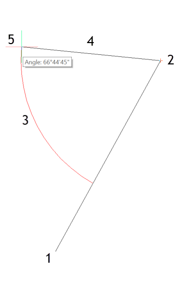

Angle and Distance
Alias: 'ANGD
Specifies a point location (5) at an angle (3) and a distance (4) from a known point (2) and direction (1-2).
Example
: PLINE
Set next point or [draw Arcs/Distance/Follow/Halfwidth/Width/Undo]: 'ANGD
Specify angle or [Clockwise]: 70
Specify distance: 200

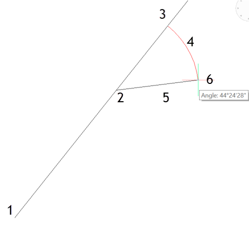

Deflection and Distance
Alias: ‘DD
Specifies a point location (6) at an angle (4) and distance (5) from a known point (2) and previous direction (1-3).
Example
: PLINE
Set next point or [draw Arcs/Distance/Follow/Halfwidth/Width/Undo]: 'DD
