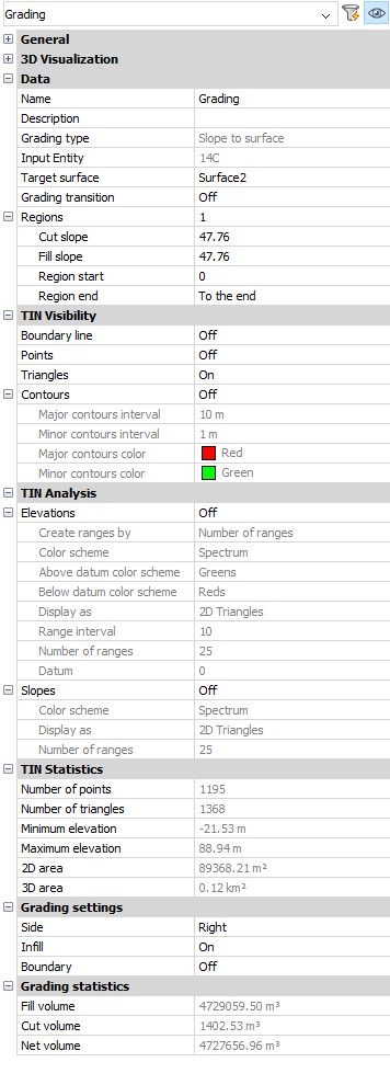

The properties are displayed in the Properties panel after selecting the grading.
- Grading type
- Displays which projection method is used to grade the surface (Slope to surface or Slope and offset).
- Input entity
- Displays the handle number of the input entity.
- Target surface
- Displays the name of the target surface.
- Grading transition
- Displays the grading transition status.
- Cut slope
- Displays the cut slope (start and end).
- Fill Slope (start and end)
- Displays the cut slope.
- Region start
- Displays the start of the region.
- Region end
- Displays the end of the region.
As the grading is derived from the TIN surface, you have access to TIN Visibility, TIN Analysis and TIN Statistics properties. You can also calculate the TIN Volume Surface and extract the TIN surface.

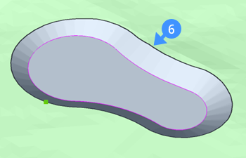

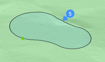

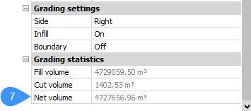

The following images show when the grading boundary of the pond is off (5) and on (6). Based on the grading boundary, the net volume for the body of the pond is calculated and can be found in the properties panel (7).
- Fill volume
- Displays the fill volume for a body/shape limited with the target surface and graded surface.
- Cut volume
- Displays the cut volume for a body/shape limited with the target surface and graded surface.
- Net volume
- Displays the net volume for a body/shape.

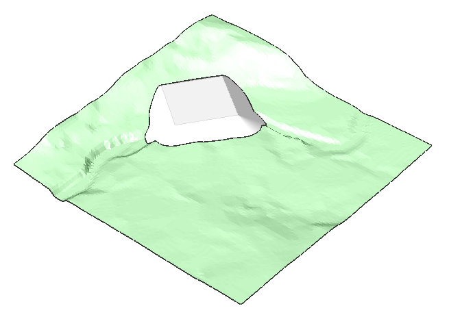

Grading a surface to create a platform
- Open a drawing that has a topographical surface (8).
- Launch the GRADING command.
- Select the entity that defines the footprint area of your platform (9).Note: Before selecting the target surface, you can change to the slOpe/offset projection method which requires an input entity, offset and slope.
- Select the target surface (10) to create a graded area.
- Select the Entire length of the input entity.

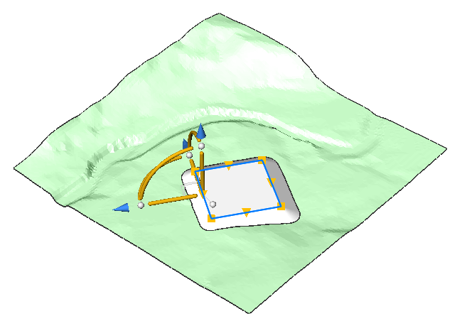

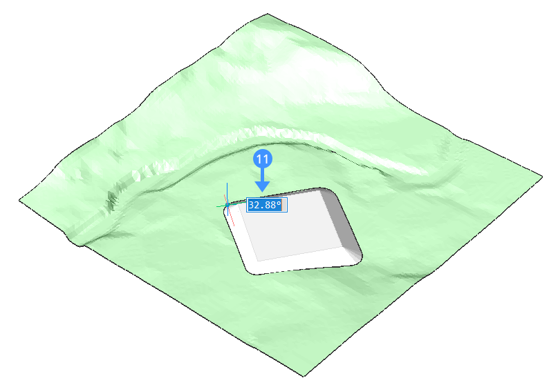

- Define the slope of the grading.Note:
- The grading is attached to the input entity, and it is connected with the target surface. Moving the mouse in/out dynamically increases/decreases the slope of the grading.
- If DYNMODE variable is set to 3, you can also input the slope angle directly from keyboard (11).
- Press ENTER to accept the slope of the grading.Note: You can easily move the platform that you created. Do this by using the manipulator on the entity from which you created the platform. You can move both horizontally and vertically.
The grading will automatically be adapted to its surroundings.

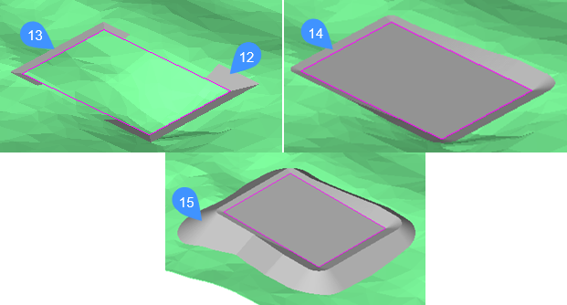

- Merge steps:
- Merge Grading1 (12) and Grading 2 (13).
- Connect the grips to close the grading. The resulted grading is (14).
On the basis of the resulting grading (14) create another grading, that is sloped to the TIN surface, and turn OFF its Infill parameter. The resulted grading is (15).

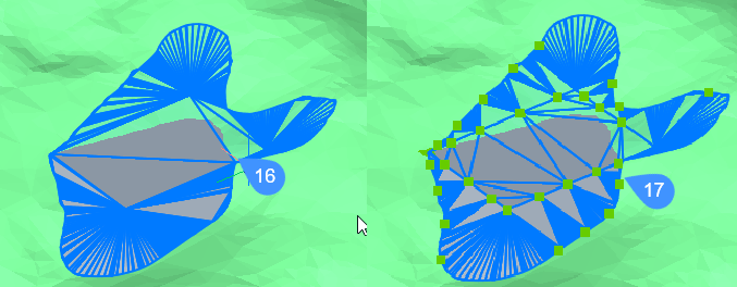

- Split
16: Grading before splitting.
17: Grading after splitting. Each region can be edited by moving the grips.
