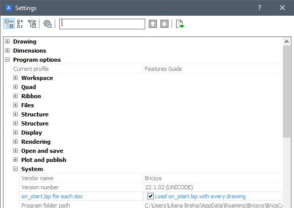

BricsCAD Settings Panel
To enable auto-launching your program set the ACADLSPASDOC system variable to 1 or simply toggle the option in Settings / Program options / System:

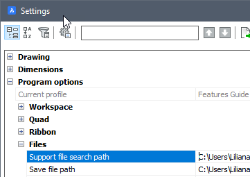

The next step in the Settings dialog box would be to add your support folders to the Files search path, which is found within Settings / Program Options / Files:
It is recommended to use the support paths added as in the manner above and/or located one level below the current project folder. It is a good practice to use a findfile function to validate the file exists before proceeding with your commands, as in the method below:
