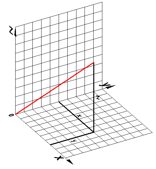

Working with Cartesian coordinates
- Type the x-, y- and z- coordinates separated by commas to enter the absolute Cartesian coordinates of a point.
- When the z-coordinate is omitted, the point is placed in the xy-plane (Z = 0).
- Type the @-character in front of the entry (@x,y) to specify the coordinates with respect to the previous point. This technique is called Relative Cartesian coordinates.

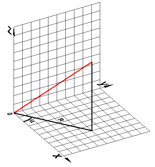

Working with cylindrical coordinates
A cylindrical coordinate system uses three perpendicular axes: the x-axis, the y-axis and the z-axis. All axes originate in the origin point of the coordinate system. The x-axis and the y-axis define a horizontal plane, while the x-axis and the z-axis respectively, the y-axis and the z-axis define vertical planes.
A point is defined using the following format: R<alpha, z.
- R = distance to the origin in the xy-plane.
- <alpha = the angle between R and the x-axis (positive angles are measured counter clockwise)
- z = the height above the xy-plane.
- When the z-coordinate is omitted, cylindrical coordinates are referred to as polar coordinates.
- Type the @-character in front of the entry to calculate the coordinates with respect to the previous point.

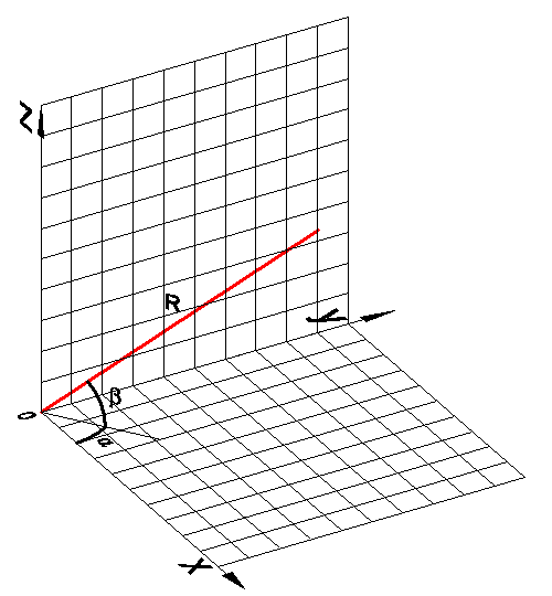

Working with spherical coordinates
The spherical coordinate system uses three perpendicular axes: the x-axis, the y-axis and the z-axis. All axes originate in the origin point of the coordinate system. The x-axis and the y-axis define a horizontal plane, while the x-axis and the z-axis respectively, the y-axis and the z-axis define vertical planes.
A point is defined using the following format: R<alpha<beta
- R = distance from the origin
- <alpha = angle in the xy-plane (positive angles are measured counter clockwise)
- <beta = angle measured from the xy-plane (positive angles are measured counter clockwise, above the xy-plane)
