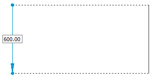

The Nearest Distance feature allows you to dynamically view and modify the distance between two selected entities or subentities. In addition, the aligned nearest distances along the X-, Y-, and Z-axes of the WCS are displayed.

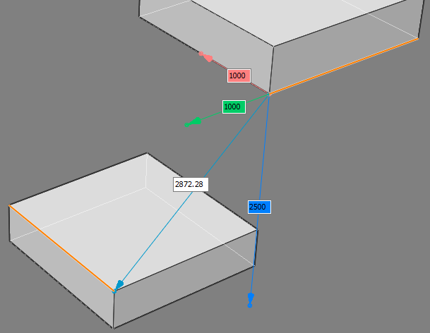

Double clicking a Nearest Distance field:
  • Toggles the display of the X-, Y- and Z-axis aligned distance fields.
  • Zooms out to fully display the selected entities if necessary.
The NEARESTDISTANCE  system variable controls the display of the Nearest Distance feature.

You can use the Nearest Distance feature to:
  • Measure the distance between two entities or subentities.
  • Adjust the distance between a (sub)entity and a block.

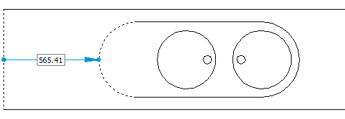

  • Modify the dimensions of a rectangle.

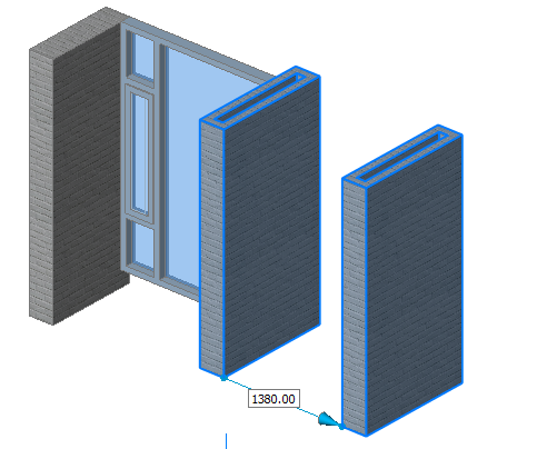

  • Adjust the distance between 3D solids.

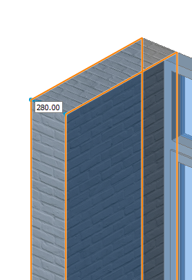

  • Edit the width of a 3D solid.

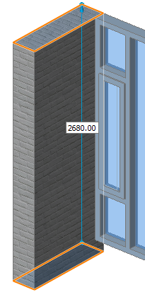

  • Measure and edit the height of 3D solid.
