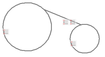

Coincident constraints between the endpoint of a line and two circles.
If the endpoints or center points of entities already coincide, the Autoconstrain option of the GCCOINCIDENT command automatically applies coincident constraints to such points.

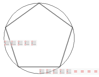

By applying coincident constraints between the pentagon vertices and the circle, and equal constraints between one side and the four other sides, the circle radius defines the size of the pentagon.

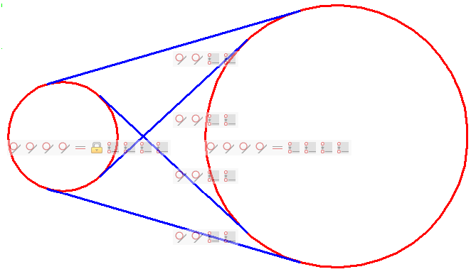

Coincident constraints between the endpoints of the tangent lines and the circles prevent the tangent lines to extend beyond the tangent points.

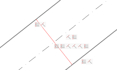

Coincident constraints are used to:
- Force the endpoints of the red line to lie on the bold lines.
- Force the midpoint of the red line to lie on the dash-dot line.
The bold lines and the dash-dot line have a perpendicular constraint with the red line. As a result the dash-dot line always lies centered between the two bold lines.
