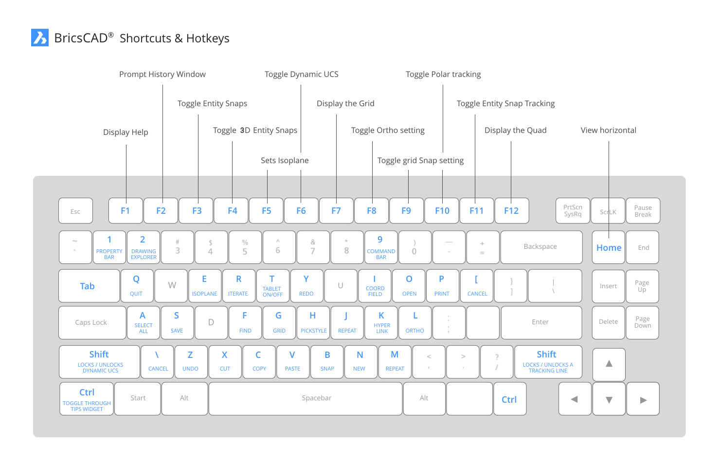

Keyboard shortcuts
Keyboard shortcuts can be a great performance enhancer, especially when toggling settings.
The following keyboard shortcuts are available:
| Keyboard | Description |
| F1 |
Opens the BricsCAD Help. Executes the HELP command. |
| F2 |
Toggles the display of the Prompt History window. See the GRAPHSCR command. |
| F3 |
Toggles the entity snaps ON/OFF. See the OSMODE setting. |
| F4 |
Toggles the 3D entity snaps ON/OFF. See the 3DOSMODE setting. |
| F5 |
Sets the isometric plane; toggles the value of the SNAPISOPAIR setting. Applies only when the SNAPSTYL setting = 1. |
| F6 | Toggles the Dynamic UCS feature. |
| F7 | Toggles the display of the grid (see the GRIDMODE setting). |
| F8 |
Toggles the ORTHOMODE setting ON/OFF. Disables bitcode 8 of the AUTOSNAP setting, if set. |
| F9 | Toggles Snap ON/OFF (see the SNAP command). |
| F10 |
Toggles the Polar Tracking setting. Sets the ORTHOMODE setting OFF, if ON. Toggles bitcode 8 of the AUTOSNAP setting ON/OFF. |
| F11 |
Toggles the Entity Snap Tracking setting. Toggles bitcode 16 of the AUTOSNAP setting ON/OFF. |
| F12 |
Toggles the display of the Quad cursor menu. See the QUADDISPLAY setting. |
| Alt + F8 | Launches the VBARUN command. |
| Alt + F11 | Launches the VBAIDE command. |
| Ctrl + 1 |
Note: Do not use the numeric keypad. On AZERTY keyboards: do not use the Shift key when pressing the number key.
Toggles the Properties panel. |
| Ctrl + 2 |
Opens the Drawing Explorer dialog box. |
| Ctrl + 9 |
Toggles the display of the Command line. Executes the COMMANDLINE command or the COMMANDLINEHIDE command. |
| Ctrl + 0 |
Toggles the display of user interface entities as specified by the CLEANSCREENOPTIONS setting. Executes the CLEANSCREENON command or the CLEANSCREENOFF command. |
| Ctrl + A | Selects all entities. |
| Ctrl + B | Toggles Snap ON/OFF (see the SNAP command). |
| Ctrl + C | Copies the selection to the clipboard (COPYCLIP command). |
| Ctrl + Shift + C | Copies the selection along with a base point (COPYBASE command). |
| Ctrl + E |
Sets the isometric plane; iterates the value of the SNAPISOPAIR setting. Applies only when the SNAPSTYL setting = 1. |
| Ctrl + F | Launches the FIND command. |
| Ctrl+Cmd+F | Toggles the fullscreen mode. Note: This is a macOS only shortcut.
| Ctrl + G | Toggles the display of the grid (GRIDMODE setting). |
| Ctrl + H | Toggles the value of the PICKSTYLE setting, which controls the selection of groups and associative hatches. |
| Ctrl + I | Sets the readout of the coordinate field in the Status bar (COORDS setting). |
| Ctrl + J | Repeats the previously issued command. |
| Ctrl + K | Attach a hyperlink to an object or modify an existing hyperlink (HYPERLINK command). |
| Ctrl + L | Toggles the ORTHO setting. |
| Ctrl + M | Repeats the previously issued command. |
| Ctrl + N | Creates a new drawing (NEW command). |
| Ctrl + O | Opens an existing drawing (OPEN command). |
| Ctrl + P | Prints the current drawing (PRINT command). |
| Ctrl + Shift + P | Toggles the display of the Properties panel (PROPERTIES command and PROPERTIESCLOSE command). |
| Ctrl + Q | Quits the application; prompts to save changes (QUIT command). |
| Ctrl + R | Iterates through viewports. |
| Ctrl + S | Saves the current drawing (QSAVE command). |
| Ctrl + T | Turns the tablet on/off (TABLET command). |
| Ctrl + Tab | Shows the next document tab. |
| Ctrl + Shift + Tab | Shows the previous document tab. |
| Ctrl + V | Pastes the contents of the Clipboard. (PASTECLIP command). |
| Ctrl + Alt + V | Pastes the contents of the Clipboard in a specified format (PASTESPEC command). |
| Ctrl + Shift + V | Pastes the contents of the Clipboard as a block (PASTEBLOCK command). |
| Ctrl + X | Cuts the selection and puts it on the clipboard (CUTCLIP command). |
| Ctrl + Y | Redoes the last action undone (REDO command). |
| Ctrl + Z | Undoes the last action (UNDO command). |
| Ctrl + [ | Cancels the running command. |
| Ctrl + \ | Cancels the running command. |
| Ctrl + Home | Creates or opens the Start page (GOTOSTART command). |
| Shift + F2 | Toggles the display of the Command line (COMMANDLINE command and COMMANDLINEHIDE command). |
| Shift + F3 | Turns the Status bar on/off (STATBAR command). |
| Shift + F4 | Turns the Scroll Bars on/off (SCROLLBAR command). |
| Shift + F8 | Launches the Visual Basic Project Manager (VBAMAN command). |
| Shift + F11 | Launches the VBA COM Add-In Manager (ADDINMAN command). |
| PgUp | Moves the view up. |
| PgDn | Moves the view down. |
| Shift + Left Arrow | Moves the view to the left. |
| Shift + Right Arrow | Moves the view to the right. |
| Shift + Up Arrow | Moves the view up. If (sub)entities are selected, the entities are nudged up (along the z-axis). |
| Shift + Down Arrow | Moves the view down. If (sub)entities are selected, the entities are nudged down (along the z-axis). |
| Ctrl + Left Arrow | Nudges the selected (sub)entities to the left (along the x-axis). |
| Ctrl + Right Arrow | Nudges the selected (sub)entities to the right (along the x-axis). |
| Ctrl + Up Arrow | Nudges the selected (sub)entities up (along the y-axis). |
| Ctrl + Down Arrow | Nudges the selected (sub)entities down (along the y-axis). |
| Tab |
Navigates down into the autocomplete command list. Note: This is a cross-platform shortcut.
| Tab + Shift |
Navigates up into the autocomplete command list. Note: This is a cross-platform shortcut.
| Ctrl + N |
Navigates down into the autocomplete command list. Note: This is a macOS only shortcut.
| Ctrl + P |
Navigates up into the autocomplete command list. Note: This is a macOS only shortcut.
