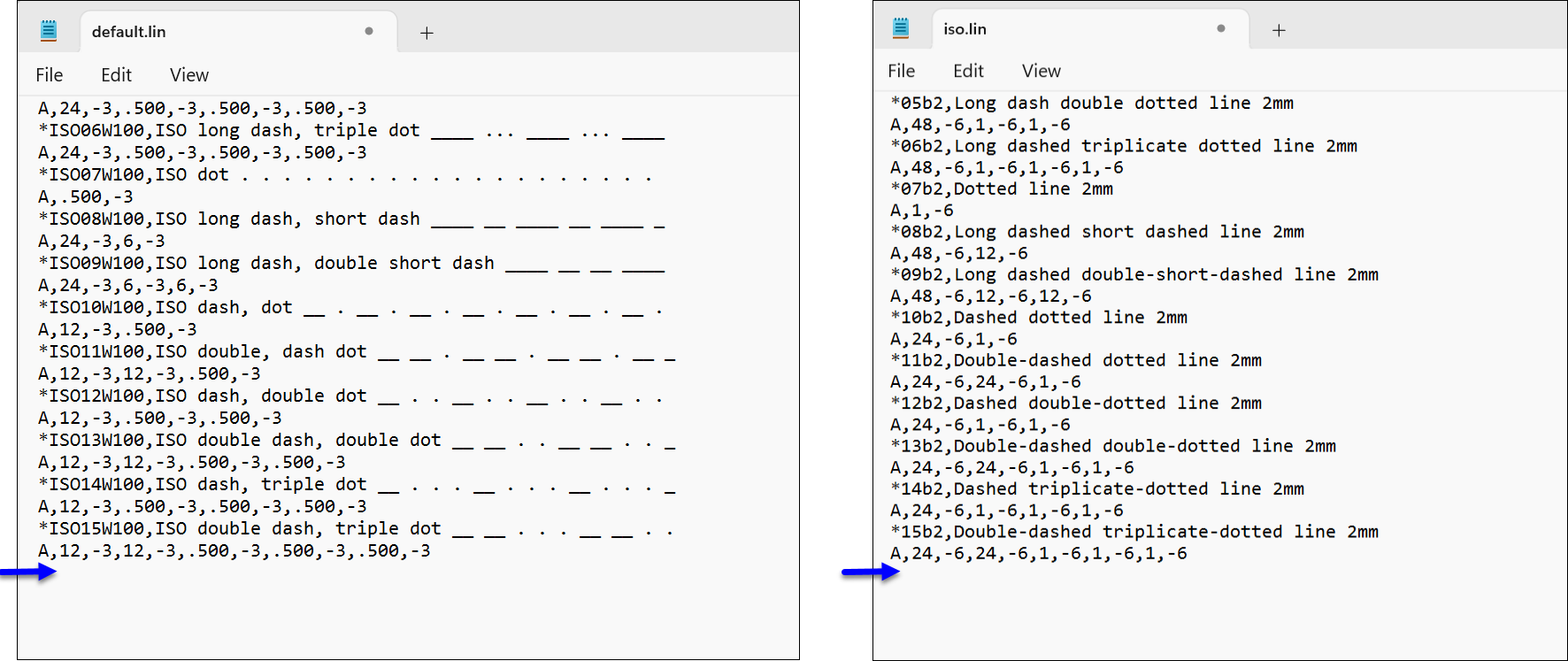

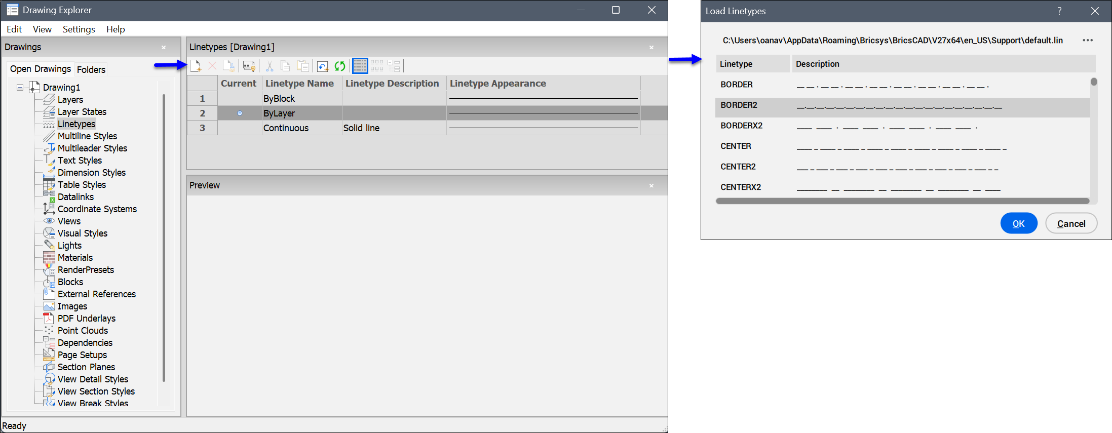

2.2 Migrating custom linetypes
LIN files store linetype definitions. BricsCAD provides two default LIN files that you can customize: default.lin for imperial linetypes and iso.lin for metric linetypes. To migrate custom linetypes, copy the required linetype definitions from these files. You can also store custom linetypes in a separate LIN file and load it in BricsCAD.
Note: If your custom linetypes contain custom text or symbols, make sure to copy the required SHX files (font SHX or shape SHX) along with the copied linetype definition or LIN file. BricsCAD needs these SHX files in its Support File Search Path (SRCHPATH system variable) to display the linetype correctly. Standard SHX fonts are included in BricsCAD, so you only need to copy custom SHX files. It is recommended to store the custom SHX files in BricsCAD Support folder.
To migrate custom linetypes, locate each file, copy the custom linetype definitions or the custom LIN file, and save them in the corresponding BricsCAD file.
Note: After migration, run the LINETYPE command and use the Load Linetypes dialog box to load the linetypes in BricsCAD.
Migrating imperial or metric custom linetypes
Go to AutoCAD® Support folder and open in a text editor the acad.lin file for imperial custom linetypes or the autocadiso.lin file for metric custom linetypes. Scroll down to the User Defined Linetype section, select the definition of the custom linetype and copy it.
Then, go to BricsCAD Support folder and open in a text editor the default.lin file for imperial custom linetypes or the iso.lin file for metric custom linetypes. Paste the definition of the custom linetype at the end of the file, then save and close it.
Migrating custom LIN files
Go to BricsCAD and run the LINETYPE command. Choose New to open the Load Linetypes dialog box and import your custom LIN file.
It is recommended to store the custom LIN files in BricsCAD Support folder.

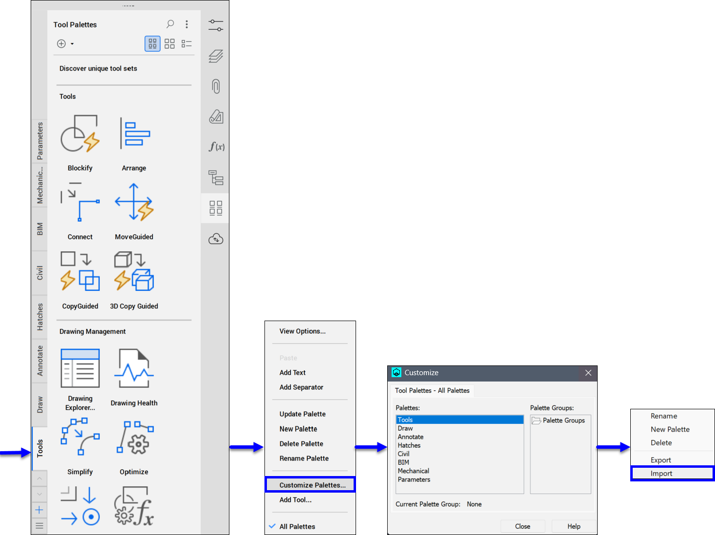

2.6 Migrating custom tool palettes
BricsCAD supports importing tool palettes from XTP, ATC and BTC files, and tool palette groups from XPG and BWS files. Tool palettes can be exported to BTC files, and tool palette groups to XPG files.
BricsCAD stores tool palettes in BTC files and indexes all existing palettes in the BcTpCatalog.btc file. When you create or import a new palette, BricsCAD updates the catalog and automatically generates a separate BTC file that contains the palette’s content. All palette files are stored in the default Tool Palettes folder inside the Support directory.
Note: If your custom tool palettes reference external resources, including hatch pattern files, images, linetypes or other support files, these resources must be migrated separately to ensure that all palette tools remain functional after migration.
To migrate custom tool palettes, export each file and import it into BricsCAD.
Go to AutoCAD® and launch the TOOLPALETTES command to open the Tool Palettes panel. Right-click the panel and choose Customize Palettes... to display the Customize dialog box. Then, right-click the custom palette or palette groups you want and select the Export... option to open the Export Palette or Export Group dialog box. Save the custom palette file as an XTP file or the custom palette group as an XPG file.
Then, go to BricsCAD and launch the TOOLPALETTES command to open the Tool Palettes panel. Right-click the panel and choose Customize Palettes... to display the Customize dialog box. Then, right-click any palette or palette group and select the Import option to open the Import Palette or Import Palette Group dialog box. Choose the XTP or XPG file you want to import.
Note: Tool Palettes can contain various tool types. During migration, some tool types may not be supported.

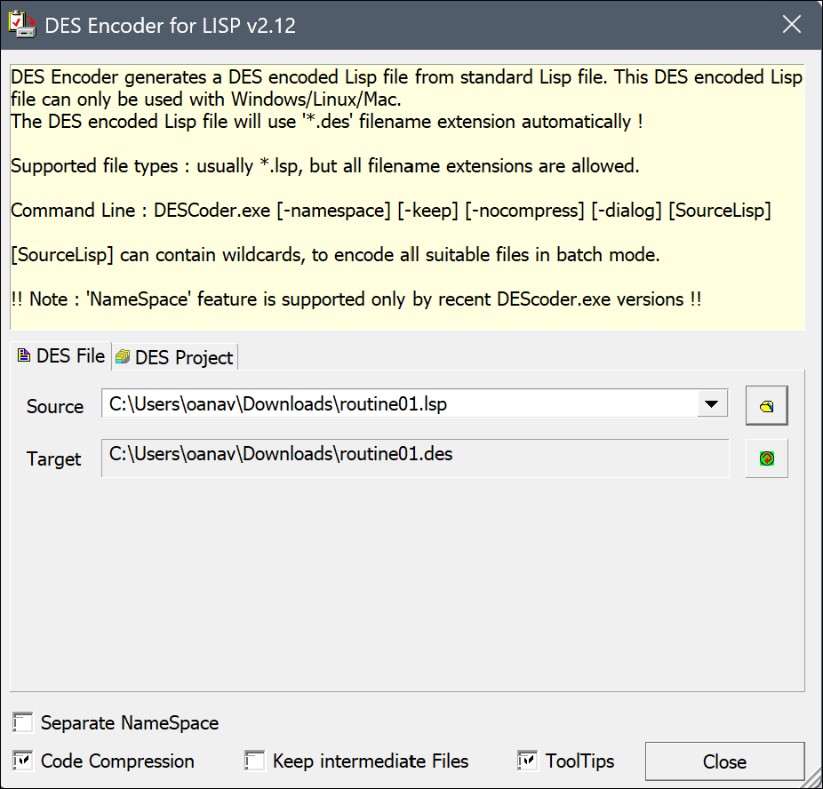

Migrating encrypted VLX files, FAS files, VLX projects (PRV) and FAS projects (PRJ)
Compiled and encrypted VLX and FAS files cannot be loaded in BricsCAD. Migration of VLX and FAS based applications requires access to the original LISP source files and the PRV or PRJ project files.
BricsCAD supports the creation of encrypted applications through DEScoder.exe. Using DEScoder.exe, multiple LISP, DCL, and other application resource files can be packaged and encrypted into a single DES application file. PRV and PRJ project files are used to define the application contents and generate the encrypted DES file.
  • After migration, the on_start.lsp is loaded per session by default, but it can also be loaded for each drawing if the ACADLSPASDOC system variable is set to 1. The on_doc_load.lsp file is always loaded for each drawing.
  • Another way to load your LISP routines is with the APPLOAD command. After you run the command, the Load Application Files dialog box is displayed to select the application files you want to run inside BricsCAD. The AutoLoad option specifies whether a file is loaded automatically or not in the next BricsCAD session (see the Load Application Files dialog box article for more information).
The path of the DES Encoder is: C:\Program Files\Bricsys\BricsCAD V27 en_US.
  1. Open the encoder.
  2. Select the LISP file in the Source field.
  3. Click the Convert selected source Lisp file into DES encrypted file button next to the Target field.
  4. After the DES file is converted, copy it to BricsCAD Support folder (from the installation folder): %AppData%\Bricsys\BricsCAD\V27x64\en_US, or to a folder you have added to the support path using the SRCHPATH system variable.
