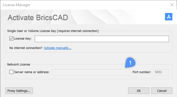

- Do one of the following:
- If you start BricsCAD® for the first time, click the Activate button in the BricsCAD Launcher dialog box.
- If you replace or upgrade an existing license, launch the LICENSEMANAGER command, click Manage License and click Modify.
- Check the Network License option in the dialog box.
- Type the host name or IP address of the license server in the Server name or address field (1).
- (Optional) Type the port number in the Port Number field.
- If your computer is connected to the license server through a proxy server, click the Proxy Settings button to configure the proxy settings for a network license.Note: Proxy Settings are also configurable from the Settings dialog box.
- Click the OK button.
