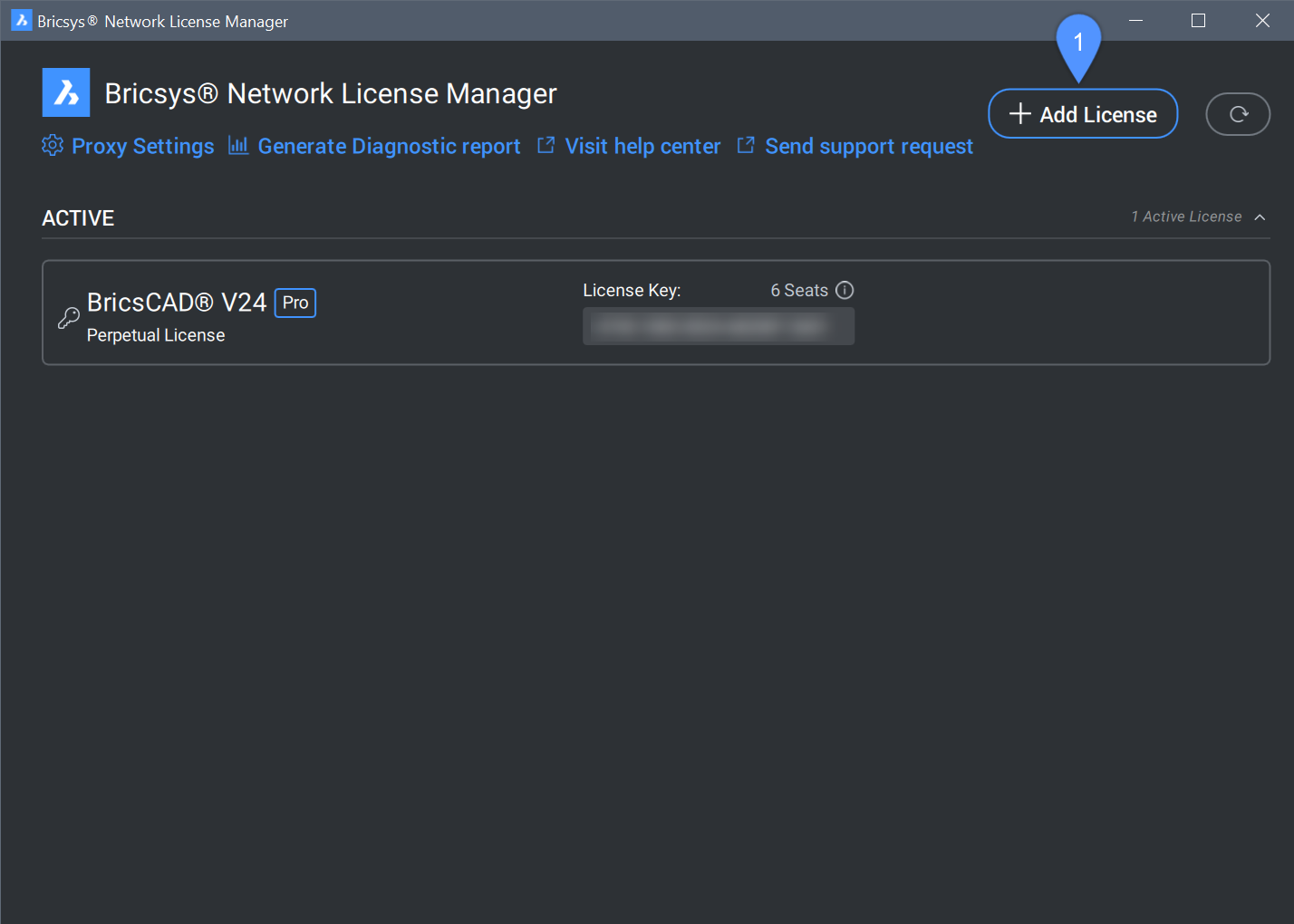

- Open the Bricsys Network License Manager (click the shortcut on the desktop or in the operating system Start menu).

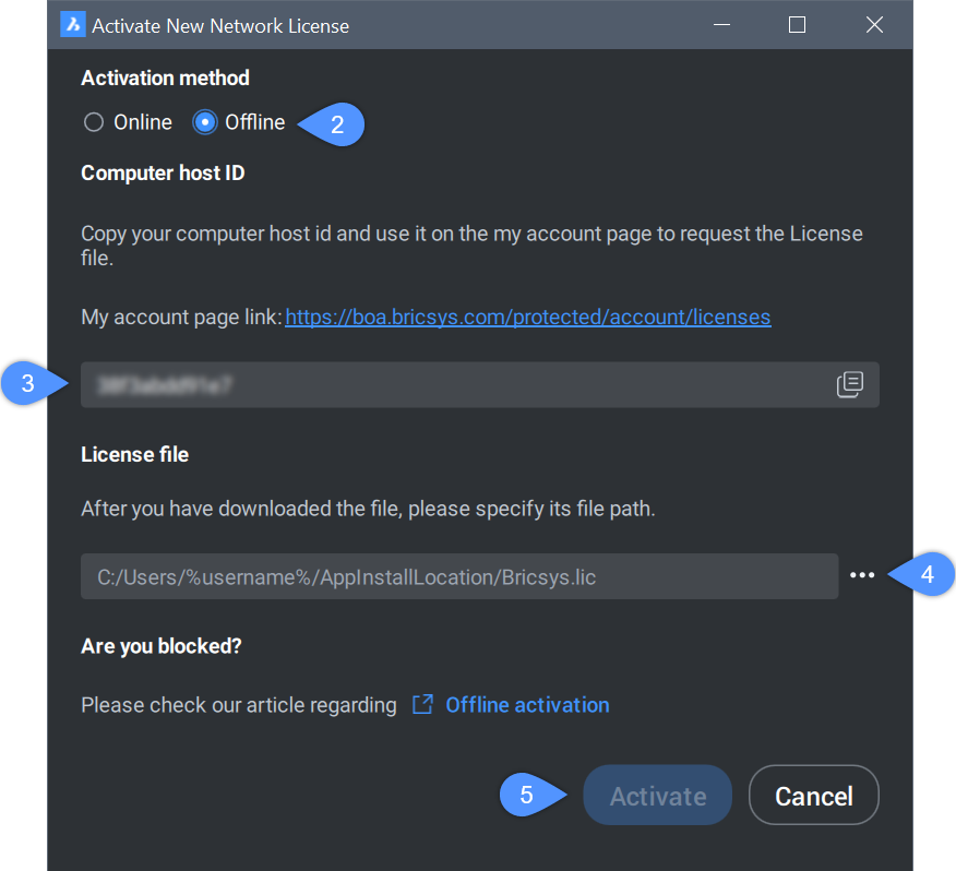

- The Activate New Network License dialog box opens. Select the Offline option.
Note: If an active license is detected on your system, the Bricsys Network License Manager dialog box opens.Click the Add License button to open the Activate New Network License dialog box.
- Copy the full content of the Computer Hostid field and use it to generate the license file.Note: To generate the license file:

- In the Activate New Network License dialog box specify the downloaded license file path. Click the browse button to open the Select BricsCAD license dialog box, select the LIC file and click Open.
- Click the Activate button to activate the license offline.
