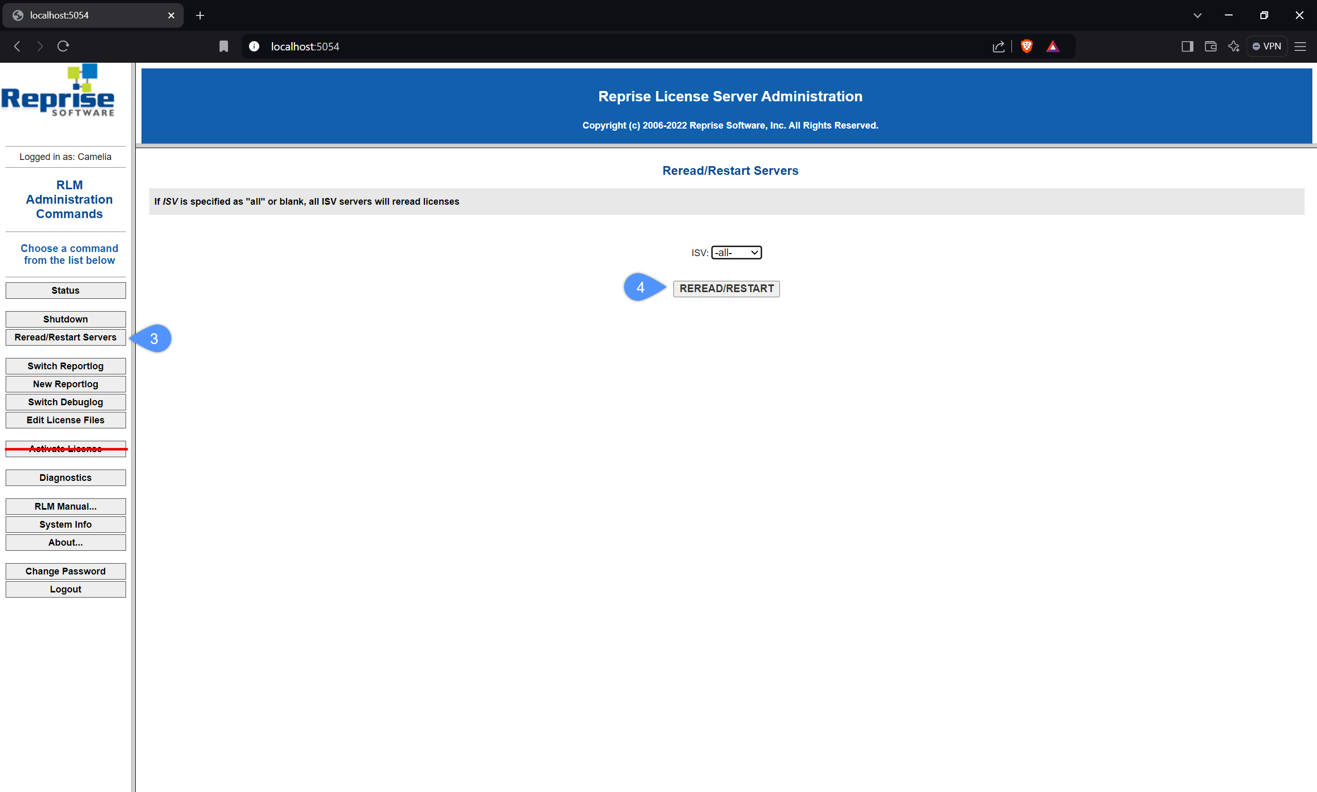

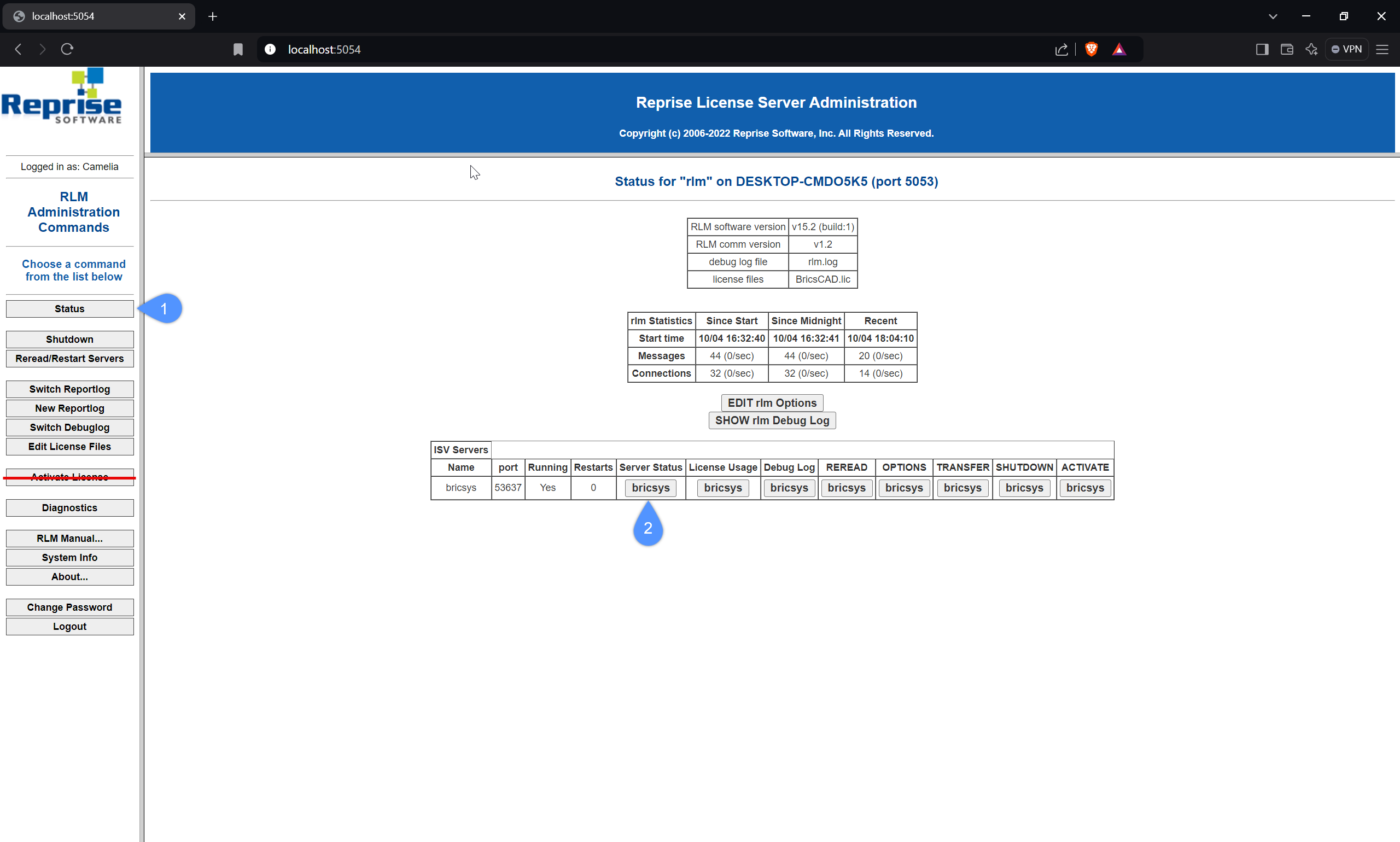

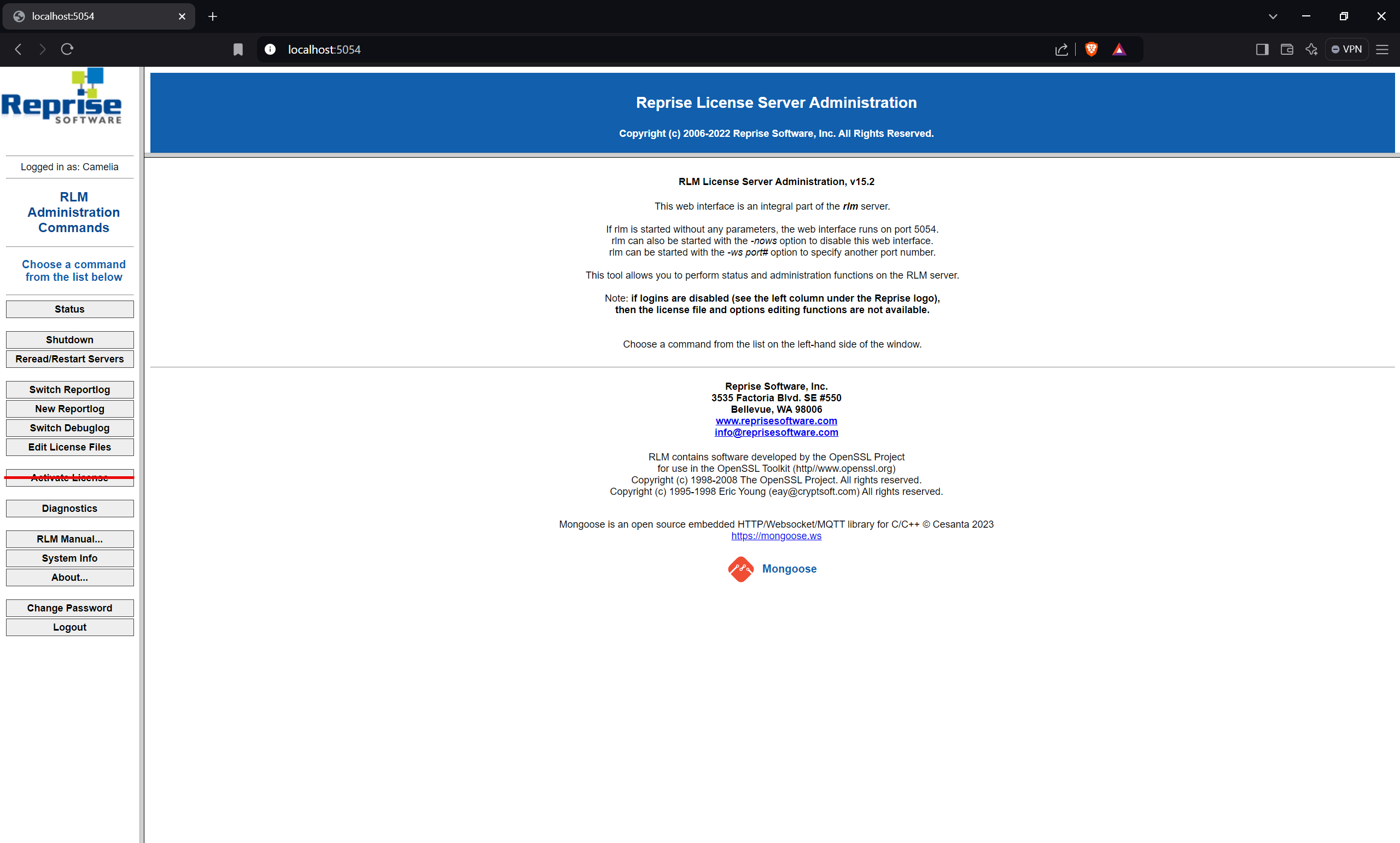

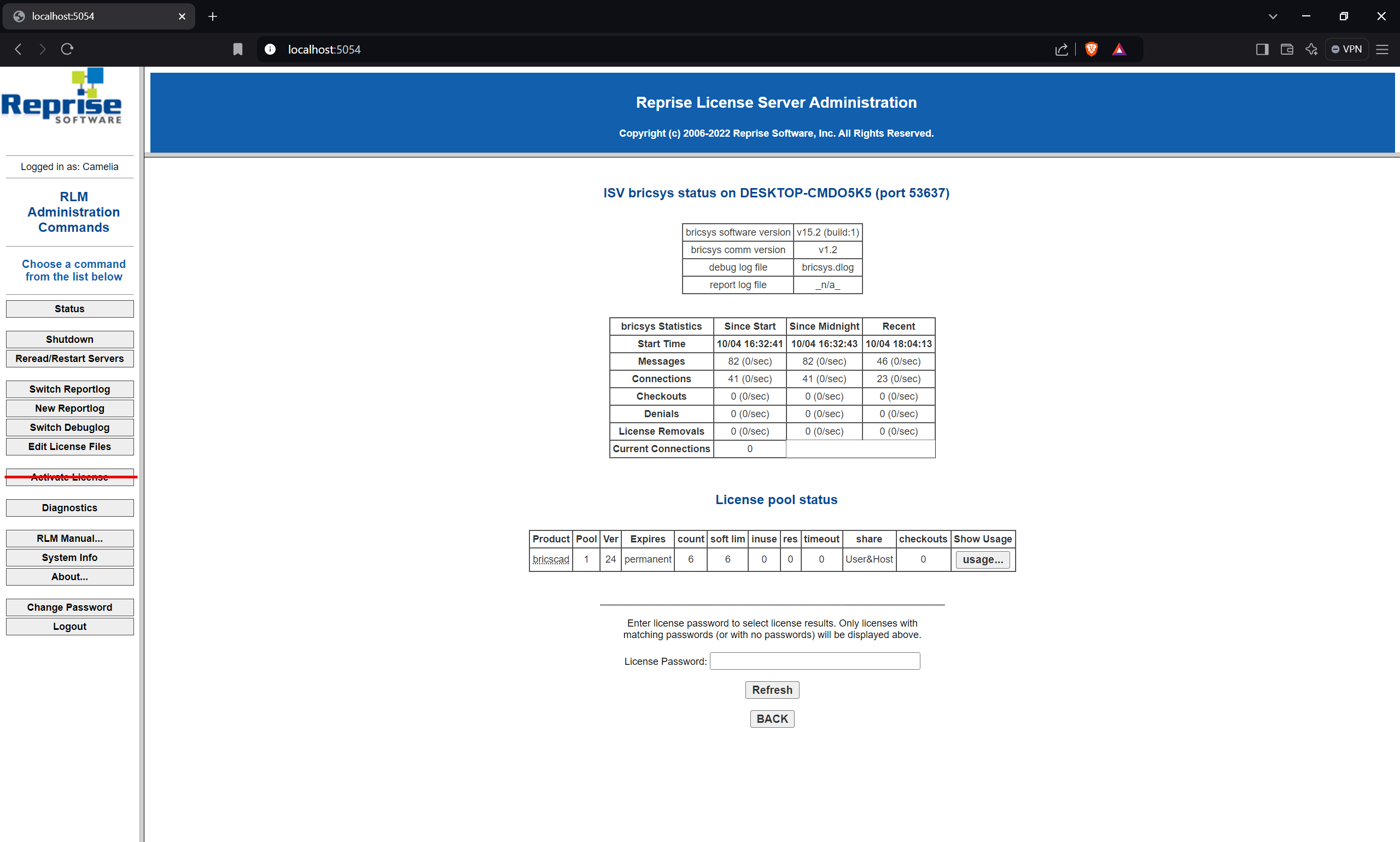

Once the Network license server is running, you can perform status and administration functions on the RLM server. To open the Reprise License Server Administration web interface, do one of the following:
  • Browse to localhost:5054 web interface.
  • (Windows only) Go to License Server Administration from the Windows search bar.
Important: Do not use the Activate License button, as it does not apply to BricsCAD licenses.
