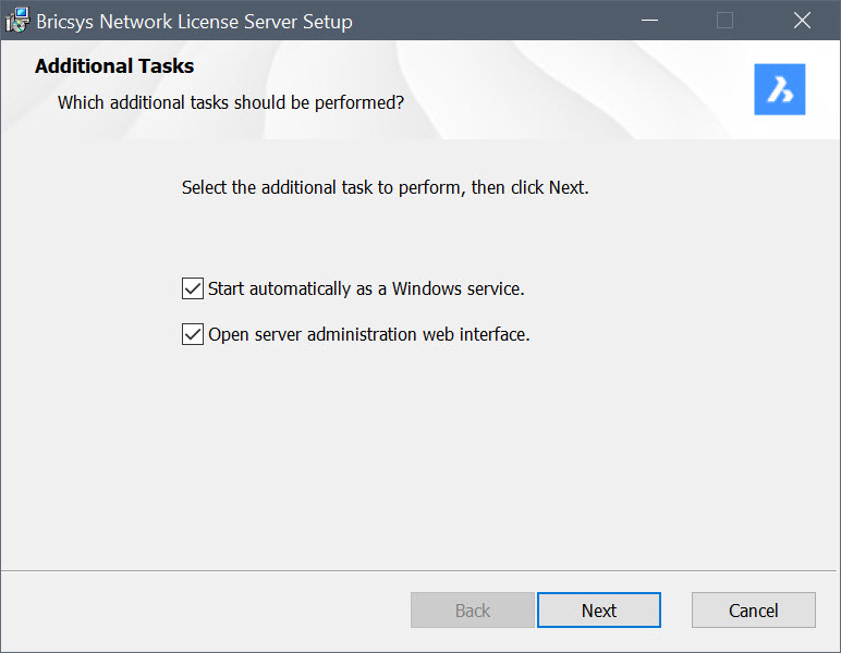

New installation of Bricsys Network License Server
In the Bricsys Network License Server Setup dialog box, make sure to tick all the checkboxes.
- Start automatically as a Windows service
- After the installation, the Bricsys Network License Manager dialog box opens. Click the Add License button to open the Activate New Network License dialog box and enter your network license to activate it. See more information the Online activation (Network license) article.
You can later open the Bricsys Network License Manager dialog box using the Bricsys Network License Manager desktop shortcut.
Note: If no active license is detected on your system, the Activate New Network License dialog box will show first.Each time you start Windows, the license server is automatically started as a service. You can do this later with the following command in the elevated command prompt:
rlm.exe -dlog rlm.log -install_service.
