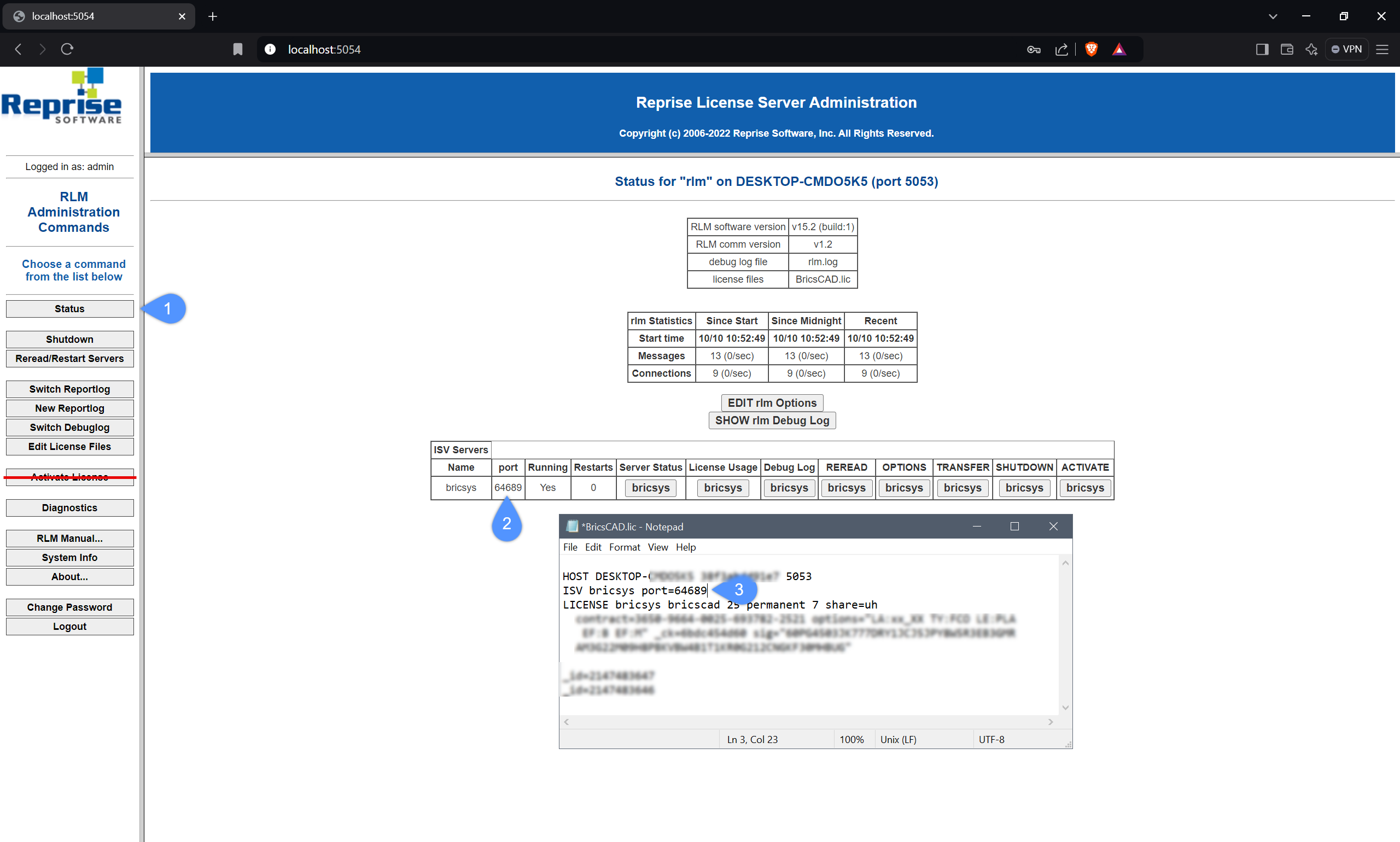

- Open the Reprise License Server Administration web interface at http://localhost:5054.
- Click the Status button (1) on the left. The Status for "rlm" on [LicenseServer] (port 5053) page opens.
- Look up the port number in the ISV Servers table. The port number is displayed in the bricsys row in the 2nd column (2).
- Copy this port number.
- Open the BricsCAD.lic file in a text editor (for example Notepad, Gedit, etc.). The default location of the file is C:\Program Files\Bricsys\Bricsys Network License Server.
You can fix the port number by modifying the line ISV bricsys into:
ISV bricsys port=[port number](3), where [port number] must be replaced by port number copied from the ISV Servers table.
- In the firewall, open both numbers 5053 and the port number you added to the BricsCAD.lic file.
- Shut down and restart the license server program.
