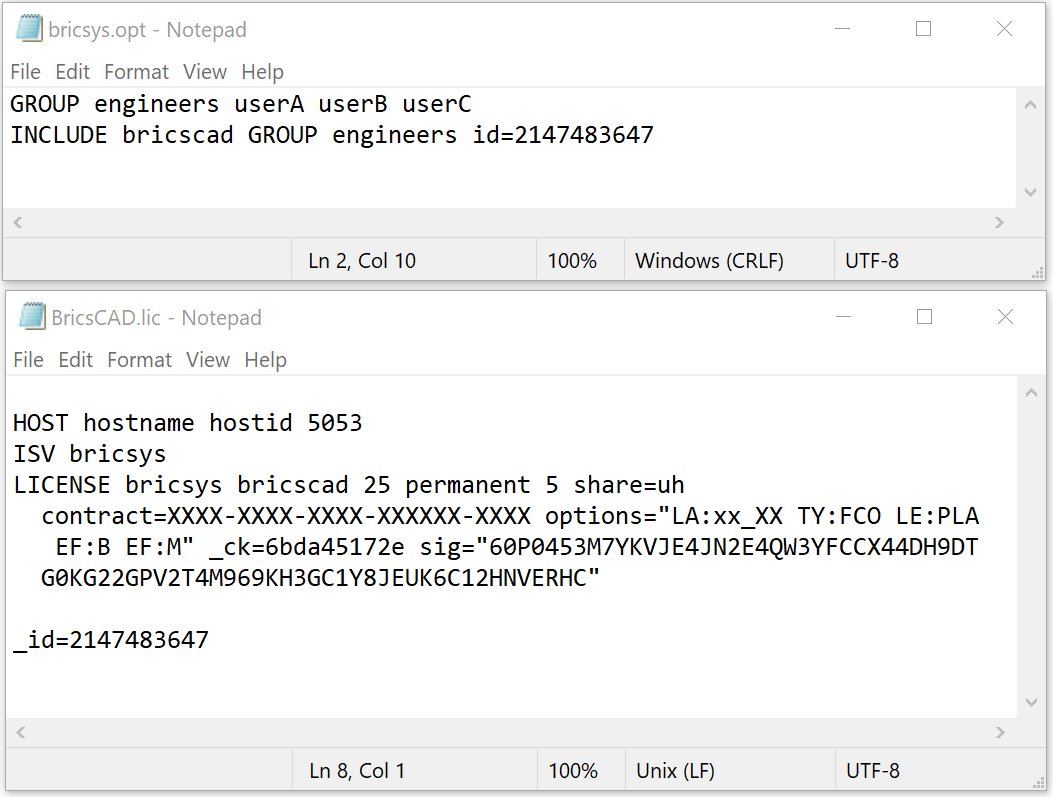

License file identifiers
Each license file has an identifier as follows:
  • After activation of a new network license, an '_id=nnn(*)' field is auto-generated, and it is added at the end of the license file. The (*) nnn is the number of the generated ID and can be modified.
  • After upgrading an existing network license, its original IDentifier number remains unchanged.
The ID is used to identify each license file, and it will be used for license pooling options.
When specifying an [id=nnn] parameter for an added OPTION, that OPTION will only have effect on the pooling of the seats from the corresponding license.
