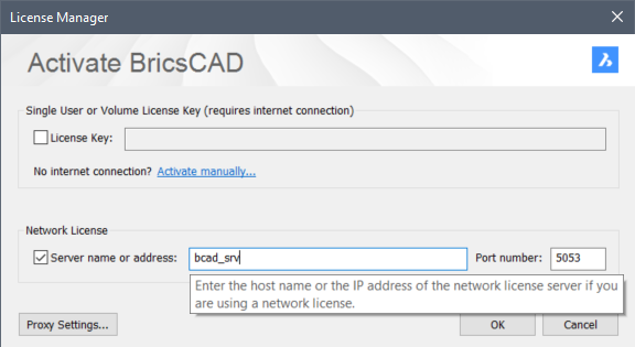

  1. Install BricsCAD with default settings.
  2. Start BricsCAD and activate the Network License: <servername>/<ip number> and <port>.
    There may be no need for this as BricsCAD will check the network for a license server at the start.
