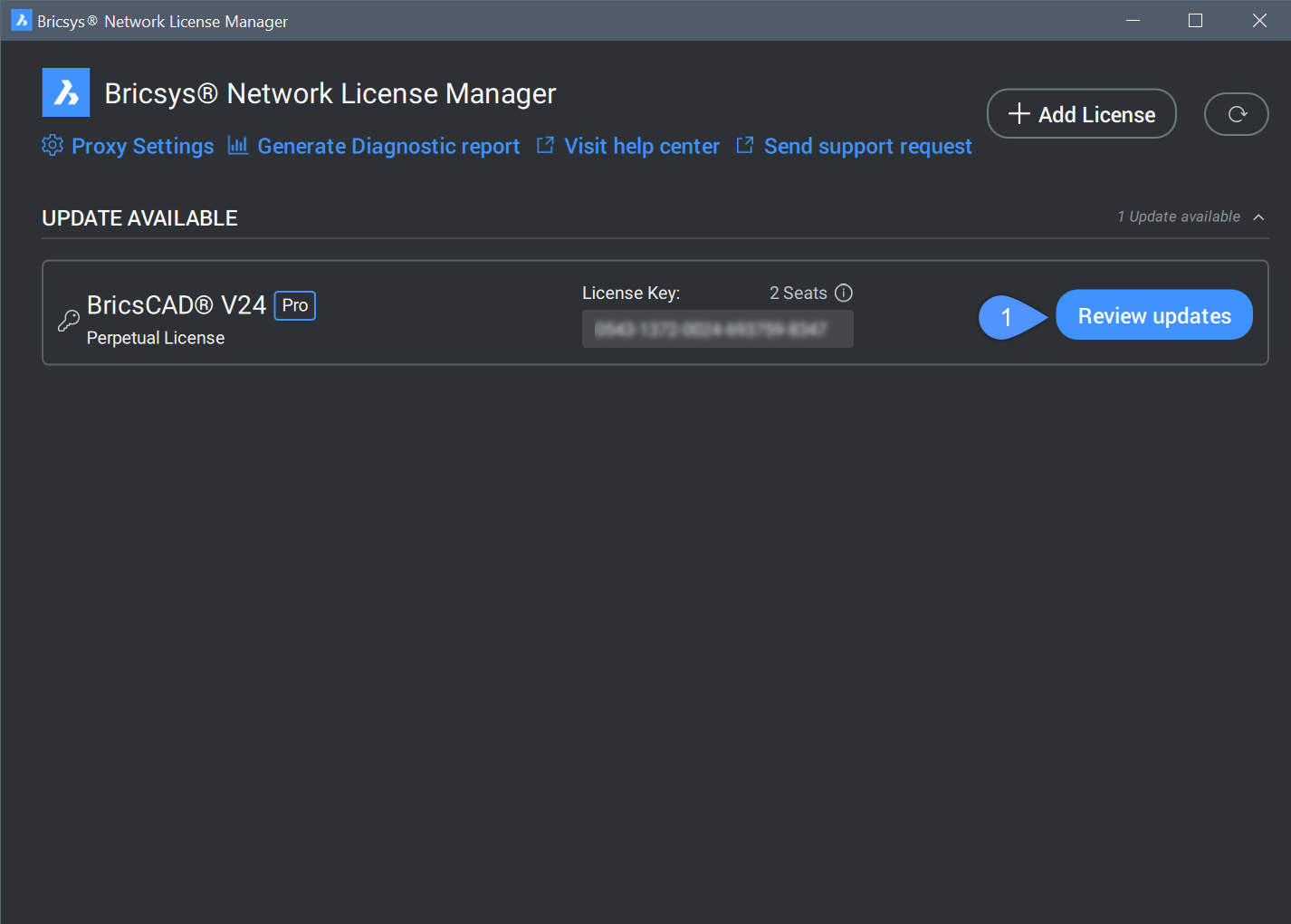

When you have purchased a version upgrade, product upgrade, seats upgrade or have extended your subscription license for Network license, and you are connected to the internet
For network licenses, all updates are detected automatically and are shown under the Update available category.

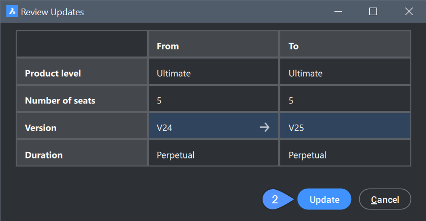

Click the Review updates button (1) to open the Review Updates dialog box to have an overview of which updates are available for that license.
Click the Update button (2) to update the license on your Network License Server.
Note: If the Bricsys Network License Manager dialog box was already open, you might need to click the refresh button () to have the Review updates button available.
If the update of a license is not automatically detected, retrieve the license key in the My licenses section under your account. See the Where can I find my licenses? article for more information. Next, enter the key in the Bricsys Network License Manager dialog box manually using the Add a license button.
