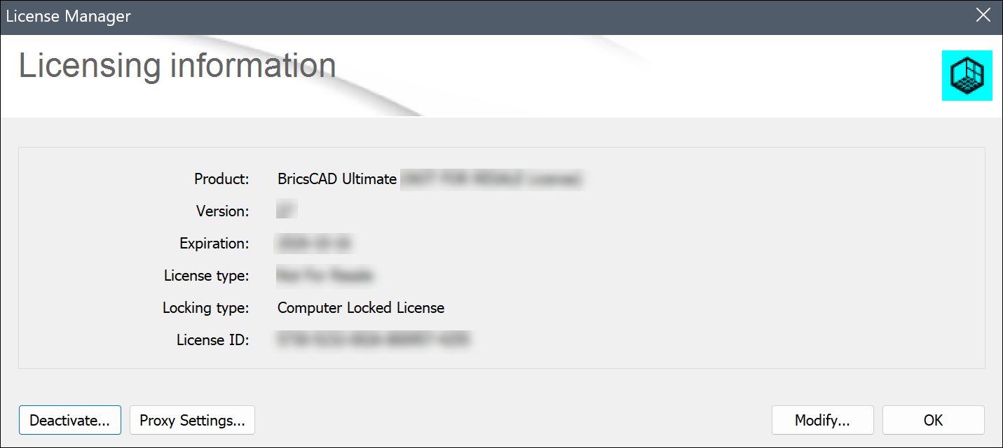

Steps to deactivate a license
  1. Launch BricsCAD.
  2. Launch the LICENSEMANAGER command to open the BricsCAD License Manager dialog box.
  3. Click the Manage License button to open the License Manager > Licensing Information dialog box.
  4. Click the Deactivate... button.
  5. Click the Yes button to confirm the license deactivation.
