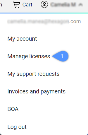

  2. Click your name in the upper right corner and select Manage licenses from the menu.
    Make sure you log in with the BricsCAD account of your company that contains the license. Contact your BricsCAD account manager if needed.
