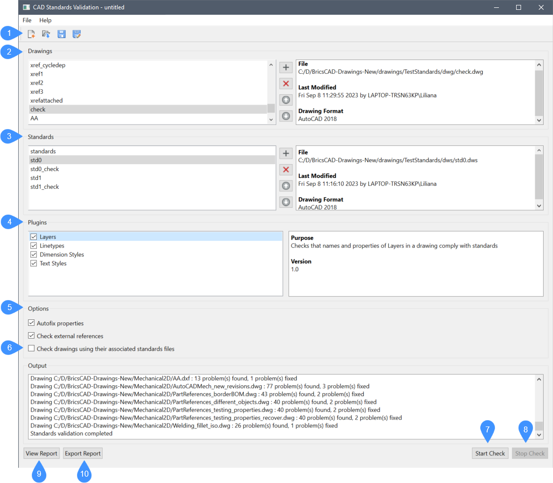

Using the standards_app.exe stand alone application
The standards_app.exe is a stand alone application stored in the BricsCAD® installation folder (by default: C:\Program Files\Bricsys\BricsCAD V26x64).
Run the standards_app.exe application to open the CAD Standards Validation dialog box. The application will check the compatibility between drawing (DWG) files and the standards (DWS) files according to the chosen plug-ins.
  1. File menu
  2. Drawings
  3. Standards
  4. Plugins
  5. Options
  6. Output
  7. Start Check
  8. Stop Check
  9. View Report
  10. Export report
File menu
Displays management options for CHX files. A CHX file lists the drawing (DWG) and standard (DWS) files and options for checking them. It can be used from ACAD or created from scratch.
New
Creates a CHX file from scratch.
Open
Opens the CAD Standards Validation dialog box to choose an existing CHX file.
Save
Saves the CAD Standards Validation configuration into a CHX file.
Save as
Saves the CAD Standards Validation configuration to a different CHX file.
Drawings
Lists the drawing files (DWG) added for checking.
With right-side buttons you are able to:
  • : add a new drawing to the list.
  • : remove the selected file.
  • : move up in the list the selected file.
  • : move down in the list the selected file.
Standards
Lists the drawing standards (DWS) file used for standard checking.
Note:
  • You can create your drawing standard file by saving a DWG file in which you define layers, dimension styles, line types, and text styles as a DWS file.
  • The right-side buttons work the same as for drawing (DWG) files.
Plugins
Lists the plug-ins that will be used for checking operation.
A plug-in refers to a property or set of entity properties in standard files. Only checked plug-ins will be considered for checking operations.
The available plug-ins are:
Layers
Checks that names and properties of Layers in a drawing comply with standards.
Linetypes
Checks that names and properties of Linetypes in a drawing comply with standards.
Dimension Styles
Checks that names and properties of Dimension Styles in a drawing comply with standards.
Text Styles
Checks that names and properties of Text Styles in a drawing comply with standards.
Options
Lists the checking options:
  • Autofix properties: automatically applies the standard properties to the target named object.
  • Check external references: includes external references in checking.
  • Check drawings using their associated standards files: checks the drawing files that contains their associated standards file.
Output
Displays a report of the standards checking.
Start Check
Runs the checking.
Stop Check
Stops the checking.
View Report
Opens the report into the StandardsApp readable window.
Export report
Exports the checking result in a report (LOG) file.
