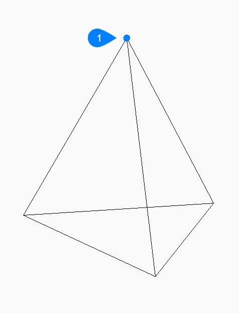

- Tetrahedron
- Choose this option to finish creating the base of the pyramid after specifying the third point to create a three-sided pyramid (tetrahedron).
- Set apex of tetrahedron
- Specifies the top of the tetrahedron (1).

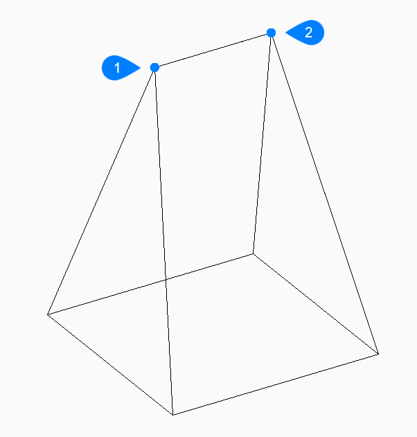

- Ridge
- Specifies the start and end points to create an edge at the top of the pyramid.
- Start of ridge
- End of ridge

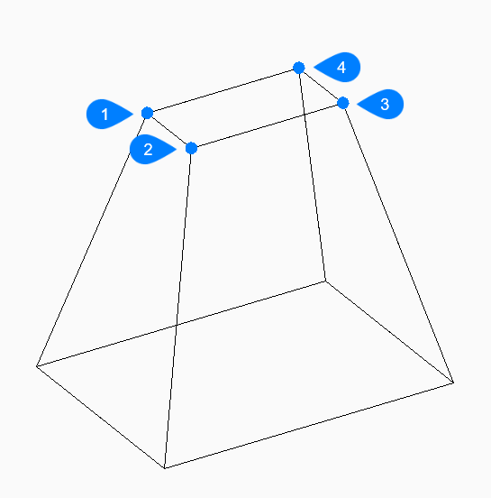

- Top surface
- Specifies four points to create a face at the top of the pyramid.
- First point
- Second point
- Third point
- Last point
