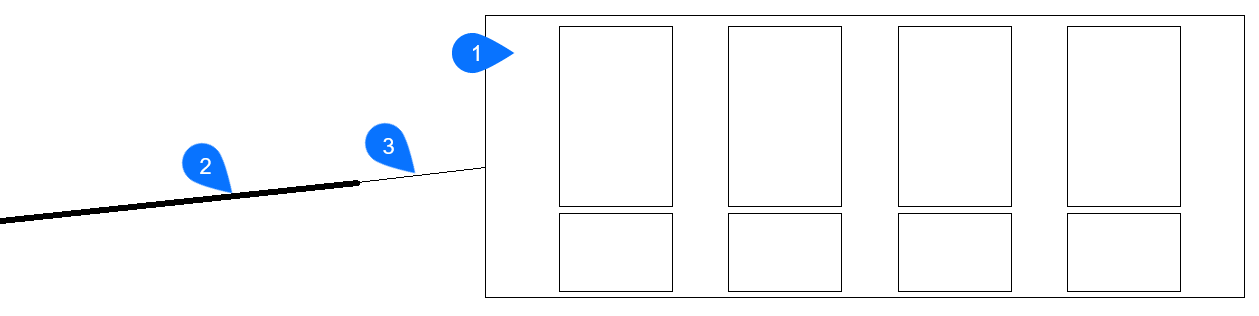

Choose one or more entities nested in blocks or external references to use as boundary entity (1). These are the entities to which the subsequently picked entities are extended.
Choose the entity to be extended (2). When another end of an entity could be extended to a boundary, BricsCAD® extends the closest end to your pick point.
- Boundary entity
- Entity to be extended
- Extended entity
