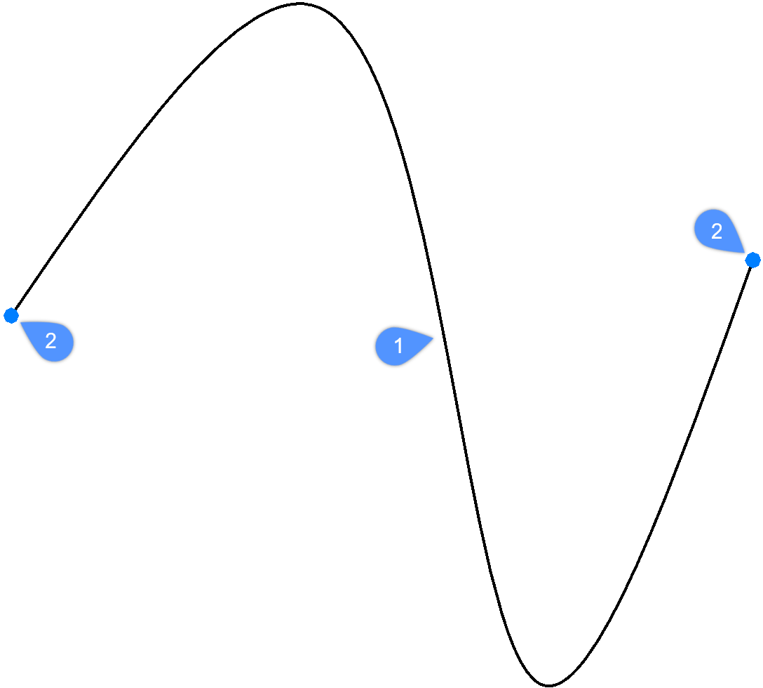

You can customize the breakline symbol with these steps:
  1. Open a new drawing.
  2. Draw a symbol (1).
  3. Set the Defpoints layer current.
  4. Add two points (2) to the symbol, using the POINT command. The breakline will intersect the symbol in these points.
  5. Save this drawing in the ExpressTools folder. The default path is: C:\Program Files\Bricsys\BricsCAD V26 en_US\ExpressTools.
