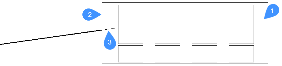

Select one or more entities (2) nested in blocks or external references (1) to use as cutting edge, then press ENTER.
Select the entity to be trimmed (3), and press ENTER.
- Block/External reference entity
- Cutting edge (an entity nested in the block/external reference entity, in this case a rectangle)
- Entity to be trimmed
