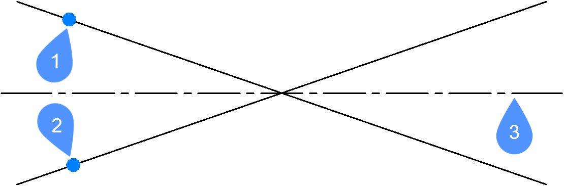

Method

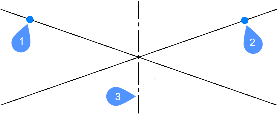

When applying a centerline to the intersection of two lines, the location of the picked points determines the direction of the centerline.
  1. First segment selected.
  2. Second segment selected.
  3. Resulting centerline.

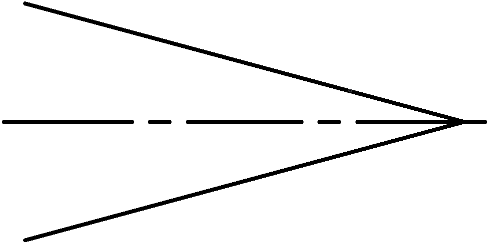

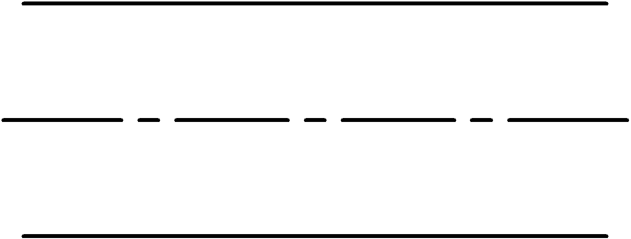

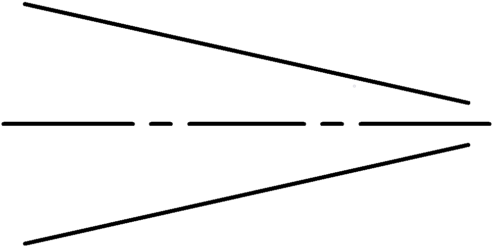

The lines and polyline segments can be selected inside blocks and in drawing view viewports. You can pick two segments of the same polyline.
