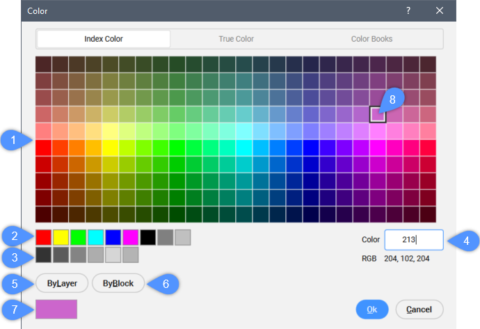

Index Color tab
Color palette (1)
Displays 240 colors.
Basic colors (2)
Displays the basic colors.
Grey colors (3)
Displays shades of gray.
Color index (4)
Displays the index of the selected color. You can insert an index and preview the color in field (7). The corresponding color is marked with a square (8).
ByLayer (5)
Sets the color to ByLayer in which entities adopt the color defined by their layer’s property.
ByBlock (6)
Sets the color to ByBlock in which entities adopt the color defined by their block.
Color sample (7)
Previews the selected color.
Note: The DISPLAYCOLORSLEGACY system variable restores the legacy index color palette used in BricsCAD versions earlier than V26 for compatibility with existing drawings. For more information, see the DISPLAYCOLORSLEGACY system variable article.

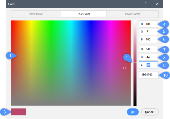

True Color tab
Color (1)
Specifies hue (left and right) and saturation (up and down).
Luminosity bar (2)
Specifies the luminosity of the color.
Color sample (3)
Red (R) - (4)
Specifies the amount of red in the color. It ranges from 0 (no red) to 255 (full red).
Green (G) - (5)
Specifies the amount of green in the color. It ranges from 0 (no green) to 255 (full green).
Blue (B) - (6)
Specifies the amount of blue in the color. It ranges from 0 (no blue) to 255 (full blue).
Note: Hue, saturation and luminosity work together, while red, green and blue work separately.
Hue (H) - (7)
Specifies the color’s hue. It ranges from red to green, blue and pink.
It ranges from 0 to 359.
Saturation (S) - (8)
Specifies the intensity of the color. It ranges from 0 to 100. Saturation is the intensity of the color, where 0 = gray and 100 = full color.
Luminosity (L) - (9)
Specifies the brightness of the color. It ranges from 0 to 100. Luminosity is the lightness or darkness of the color, where 0 = black and 100 = white.
Note: When the current color is white (L=100) or black (L=0) and a true color is picked on the COLOR dialog box, the luminosity is set to 50. Also, the picked true color is not synced with the luminosity.

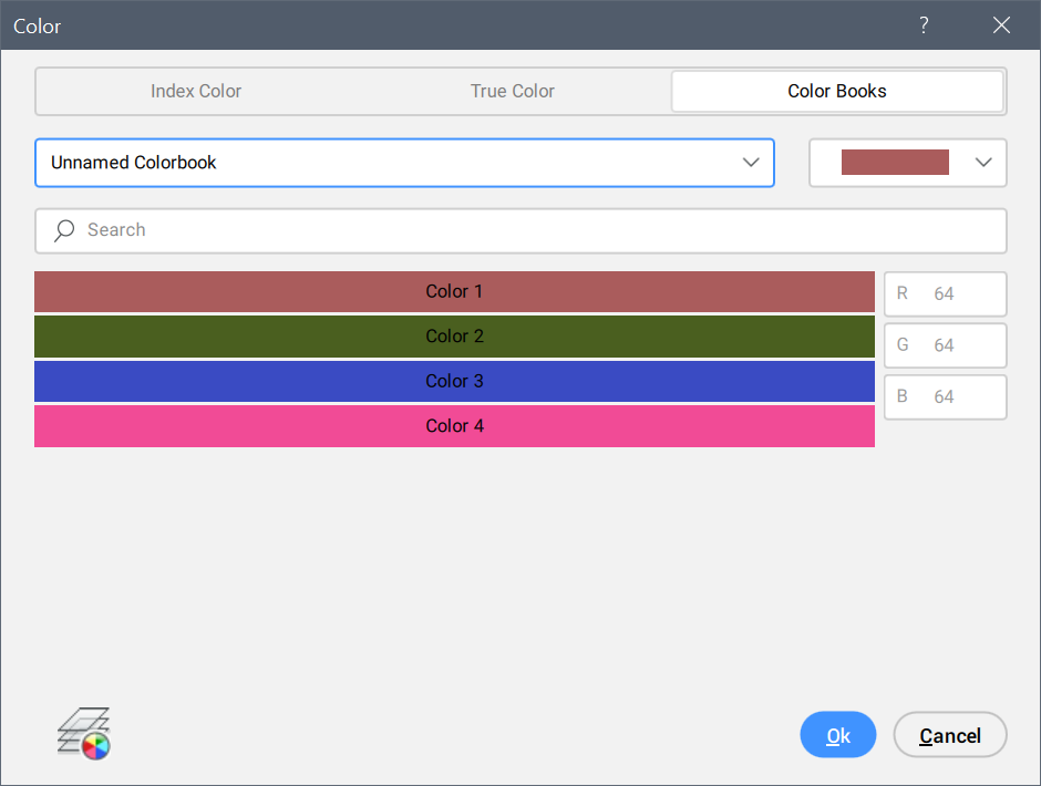

Color Books tab
Choose a color book that is present on your system.
Note:
  • The COLORBOOKPATH system variable specifies the folder in which BricsCAD should look for color book files.
  • Encrypted color books are supported. The encrypted color books are not included within BricsCAD.
