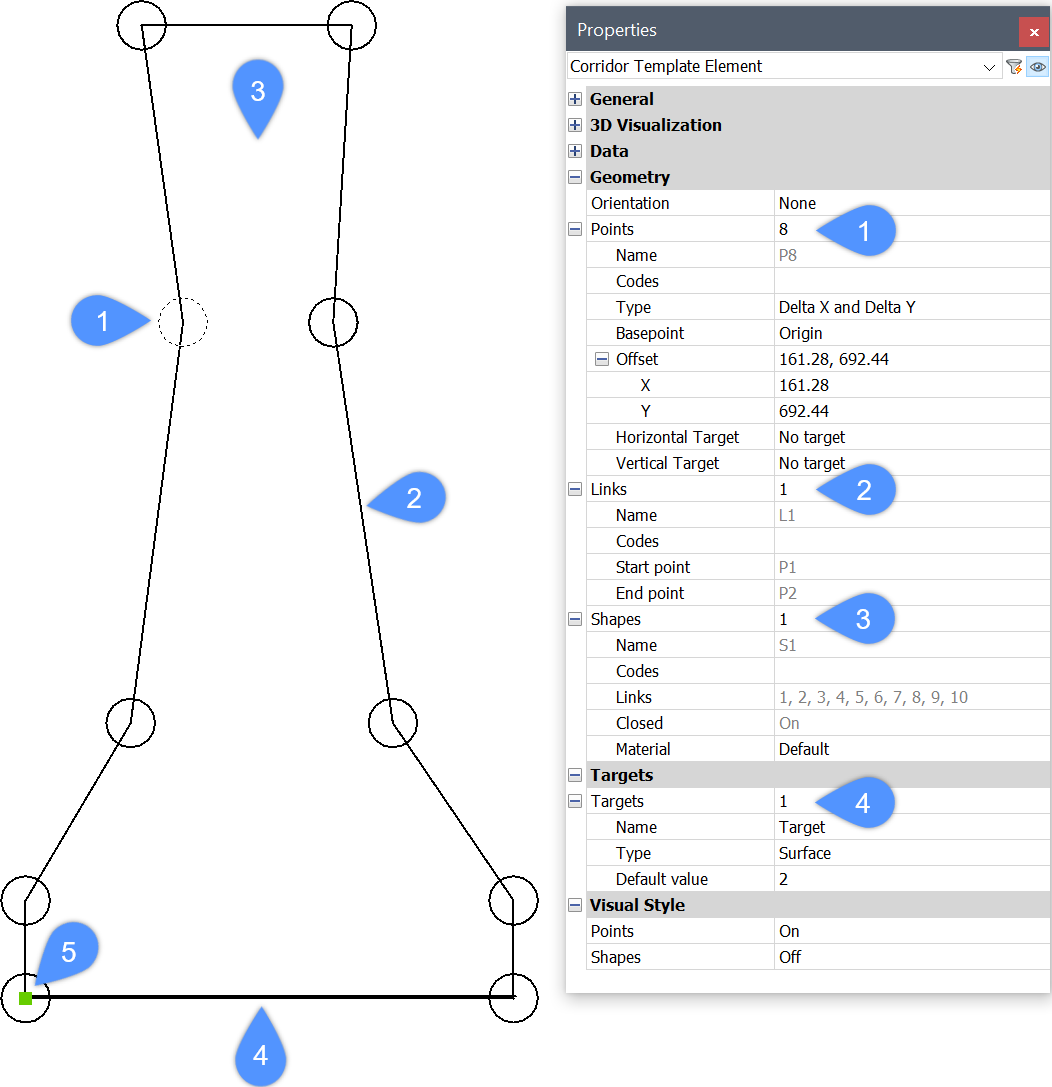

Edits corridor template elements by adding or removing components (points, links, shapes) and targets to an existing template element.
Note:
  • After insertion, points (1), links (2), shapes (3) and targets (4) can be also edited in the Properties panel.
    The currently selected point and link are highlighted.
  • The green square (5) represents the origin of the corridor template element.

Let's take an example from the figure above, where the template element consists of 10 points, named P1 to P10. Assume that we want to insert a new point directly after the specified basepoint P5. If we select the unset insertion Index option in the command line, the new point will get an index value equal to 11, so the name of new point will be P11. If this option is not selected, the new point will get an index value of 6 and the point name will be P6. Existing points from P6 onwards are re-indexed and renamed.
