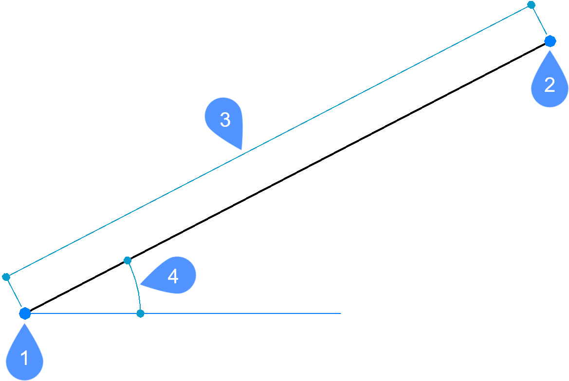

The distance can be measured between two points or multiple points.
  1. Starting point for distance
  2. End point
  3. Distance

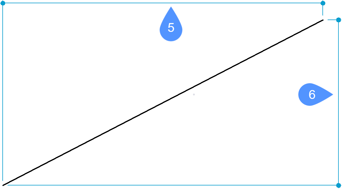

  4. Angle in XY plane
  5. X Distance
  6. Y Distance
Note: When DRAGSNAP = ON and the Dynamic Dimensions are enabled, the distance is displayed in the dynamic entry field when hovering over the second point using an appropriate entity snap.
