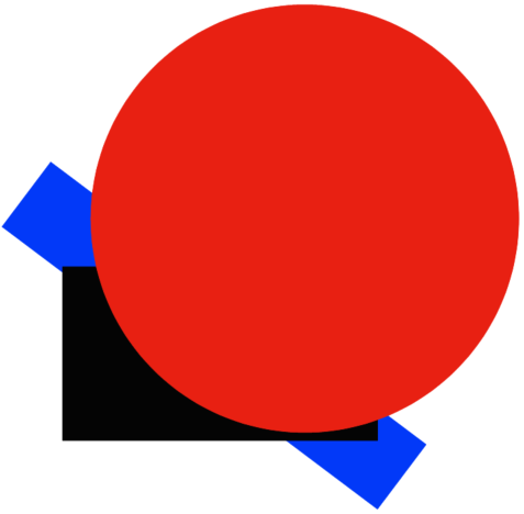

Draw simple shapes. Each shape should have its own layer.

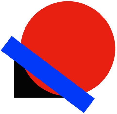

After using the DRAWORDERBYLAYER command with the file attached at the end of this article, the drawing looks like this:
The LST file used to make changes for this example is: Layer.lst
Note: The layers used in this example are named with the color used for each one of them.
