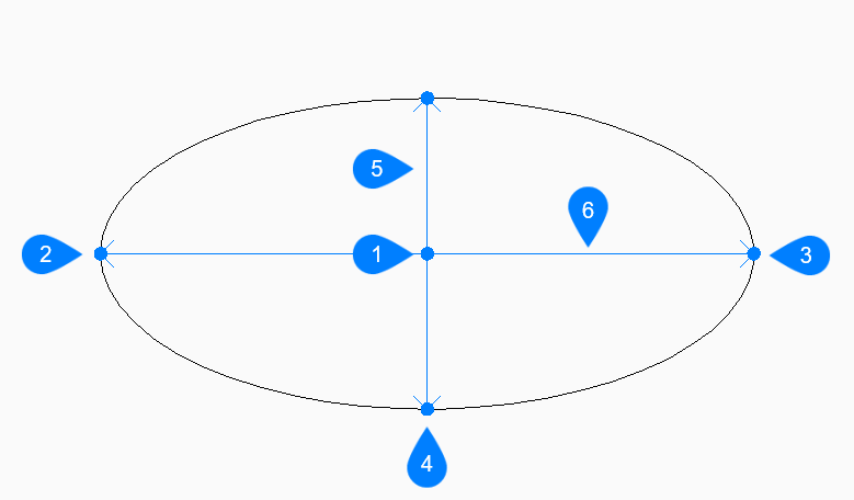

Create an ellipse or elliptical arc from a combination of options including the center, axis endpoints, axis radius, rotation angle, and included angle.
- Center
- First end of ellipse axis
- Second end of ellipse axis
- End of other axis
- Major axis
- Minor axis

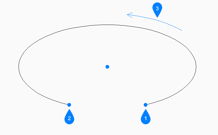

- Arc
- Allows you to begin creating an elliptical arc by specifying the first and the second ends of ellipse axes, and the radius of the axis.
- Set start angle of arc
- Specifies the start angle to define the arc’s starting point. The angle is measured counter-clockwise from the positive x-axis.
- Parameter
- Specifies values for the parametric formula that defines the elliptical arc:
- Included angle
- Specifies the included angle, measured from the starting point.
- End angle
- Specifies the end angle to define the arc’s endpoint.
- Start angle
- End angle
- Included angle
