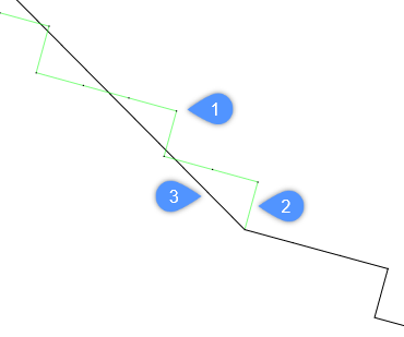

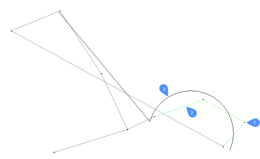

Pick a point for Start of polyline. The guideline is used as a visual aid for the user, helping to pick the envisioned polyline vertices.
- The points used by the command to fit the polyline.
- The suggested guideline.
- The polyline.

- fit Arcs
- Fits an arc polyline segment between the points between the last fixed polyline vertex and the mouse position.Note: See the FITARC command.
