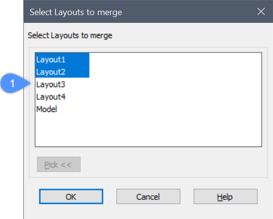

Layouts to merge
Allows you to choose one or more layouts to be merged.

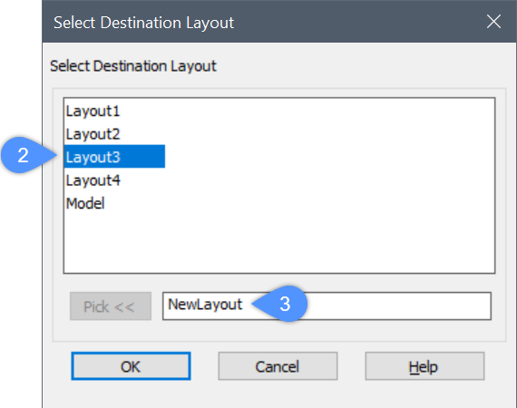

Destination layout
Allows you select a destination layout from the list.
Type a layout name
Allows you to type a layout name. If the layout does not exist, the Create layout? dialog box opens which asks you if you want to create the layout or not.
