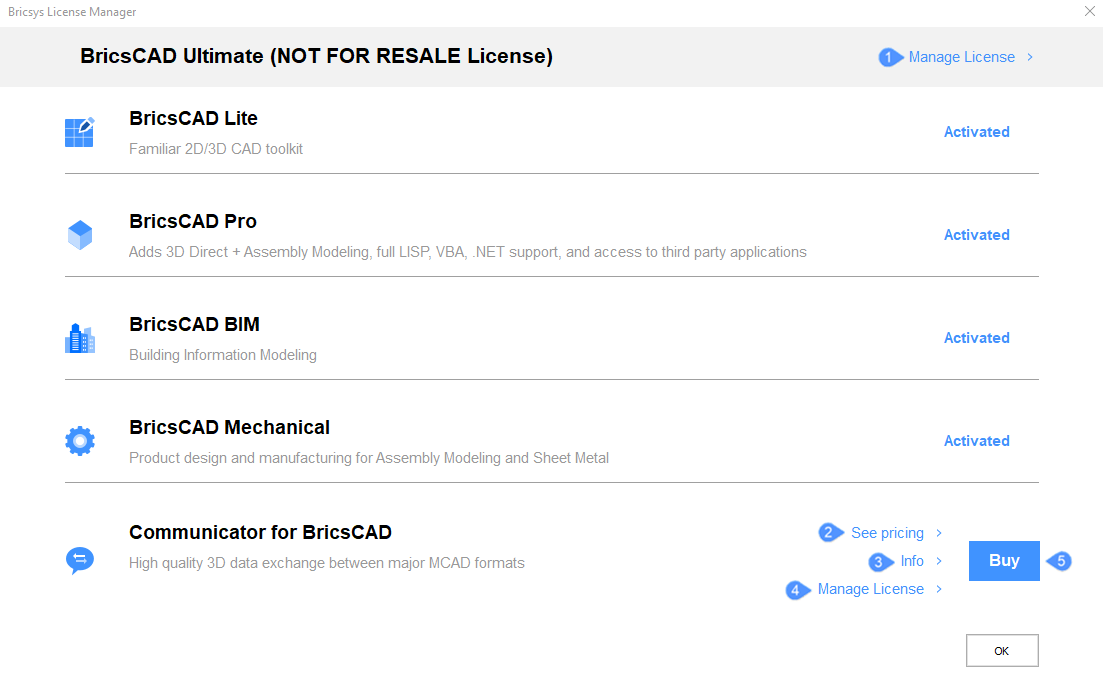

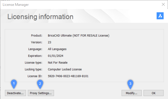

Manage License (BricsCAD)
Opens the License Manager dialog box.
  1. Deactivate...
  2. Proxy Settings…
  3. Modify…

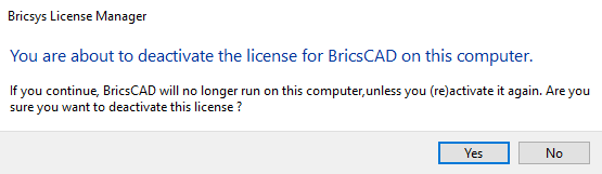

Deactivate...
Deactivates the license. A confirmation dialog box opens to confirm the deactivation.

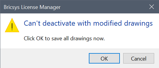

Note: If you have unsaved drawings, a warning message displays. You have to save all drawings before deactivating the license.
Important: The BricsCAD session closes after deactivating the license.

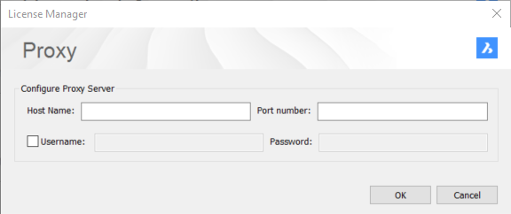

Proxy Settings…
Opens the License Manager dialog box where you can configure the proxy server.
Modify…

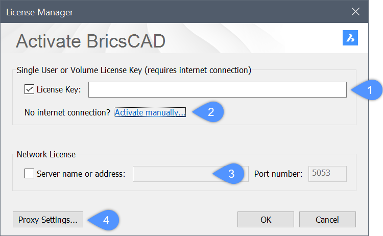

Opens the License Manager dialog box for activating BricsCAD. You can insert your license key, manually activate it if needed, or enter your network license server name or address.
  1. License Key
  2. Activate manually…
  3. Network License
  4. Proxy Settings…
License Key
If you are connected to the internet, you can enter in this field the single-user license key.

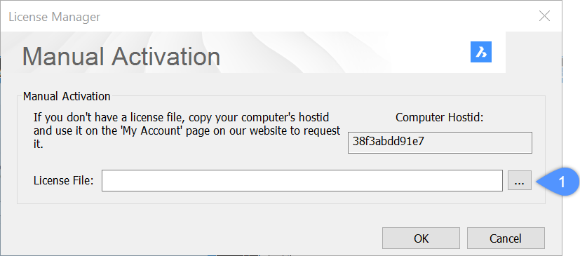

Activate manually…
Opens the License Manager dialog box for Manual Activation, where you can select the license file. The LIC file can be found in this path: C:\ProgramData\Bricsys\BricsCADV27.lic
  1. Select license file
Select license file
Opens the Select license file dialog box.
Network License
If you are using a network license, enter the server name or the IP address of the Network License Server.
Proxy Settings…
Opens the License Manager dialog box to configure the proxy server.
See pricing
Opens the BricsCAD website, where you can see the prices for BricsCAD and Communicator for BricsCAD license types.
Info
Opens the Communicator Info dialog box. See the Communicator Info dialog box article.
Download (Communicator for BricsCAD)
Opens the BricsCAD website to download Communicator for BricsCAD. If necessary, log in to your BricsCAD account.

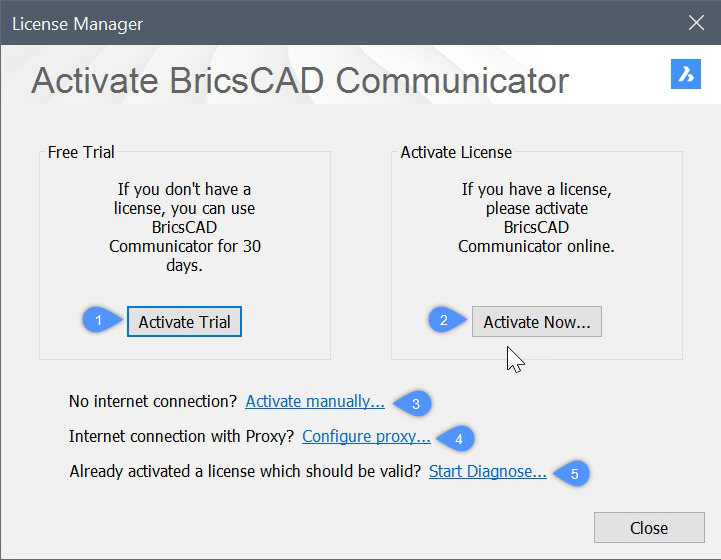

  1. Activate Trial
  2. Activate Now...
  3. Activate manually…
  4. Configure proxy…

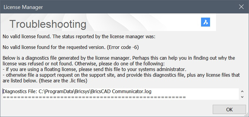

  5. Start Diagnose…
Activate Trial
Activates the 30 days free trial of Communicator for BricsCAD.

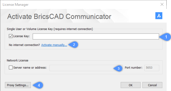

Activate Now...
Opens the License Manager dialog box for activating Communicator for BricsCAD. You can insert your license key, manually activate it if needed, or enter your network license server name or address.
  1. License Key
  2. Activate manually...
  3. Network License
  4. Proxy settings...
License Key
Activate manually…
Opens the License Manager dialog box for Manual Activation, where you can select the license file. The LIC file can be found in this path: C:\ProgramData\Bricsys\BricsCAD CommunicatorV27.lic

Proxy Settings…
Activate manually…

Configure proxy…
Start Diagnose…
Opens the License Manager dialog box for Troubleshooting.
Buy
Opens the BricsCAD website, where you can buy or subscribe to BricsCAD.
