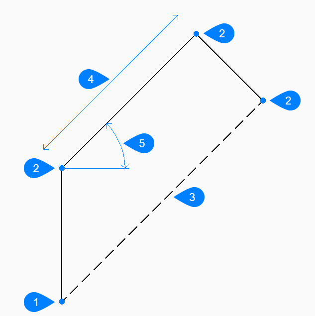

Creates a series of individual line entities by specifying the start and endpoint of each segment. Options allow you to specify the angle, undo, and close the geometry.
  1. Start
  2. End
  3. Close
  4. Length
  5. Angle

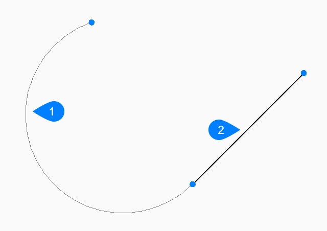

Follow
Begins creating a line from the last drawn arc or line segment, following its angle.
Length of line
Specifies the length of the line. Picking the endpoint only determines the length since the angle follows the previous segment.
  1. Last drawn arc
  2. Follow

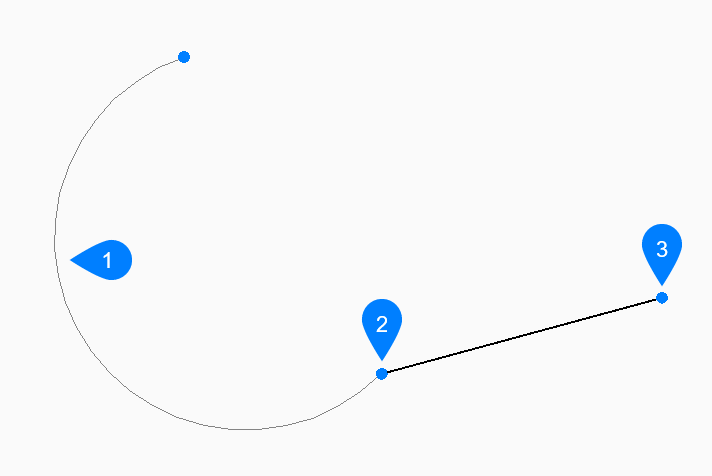

Last point
Begins creating a line from the last point picked.
  1. Last drawn arc
  2. Last point
  3. End point
Angle
Specifies the angle of the line segment.
Length
Specifies the length of the line segment.
Undo
Undoes the last line segment and continue drawing from its previous start point.
Close
Automatically draw a line from the end point of the last segment to the start point of the first segment.
